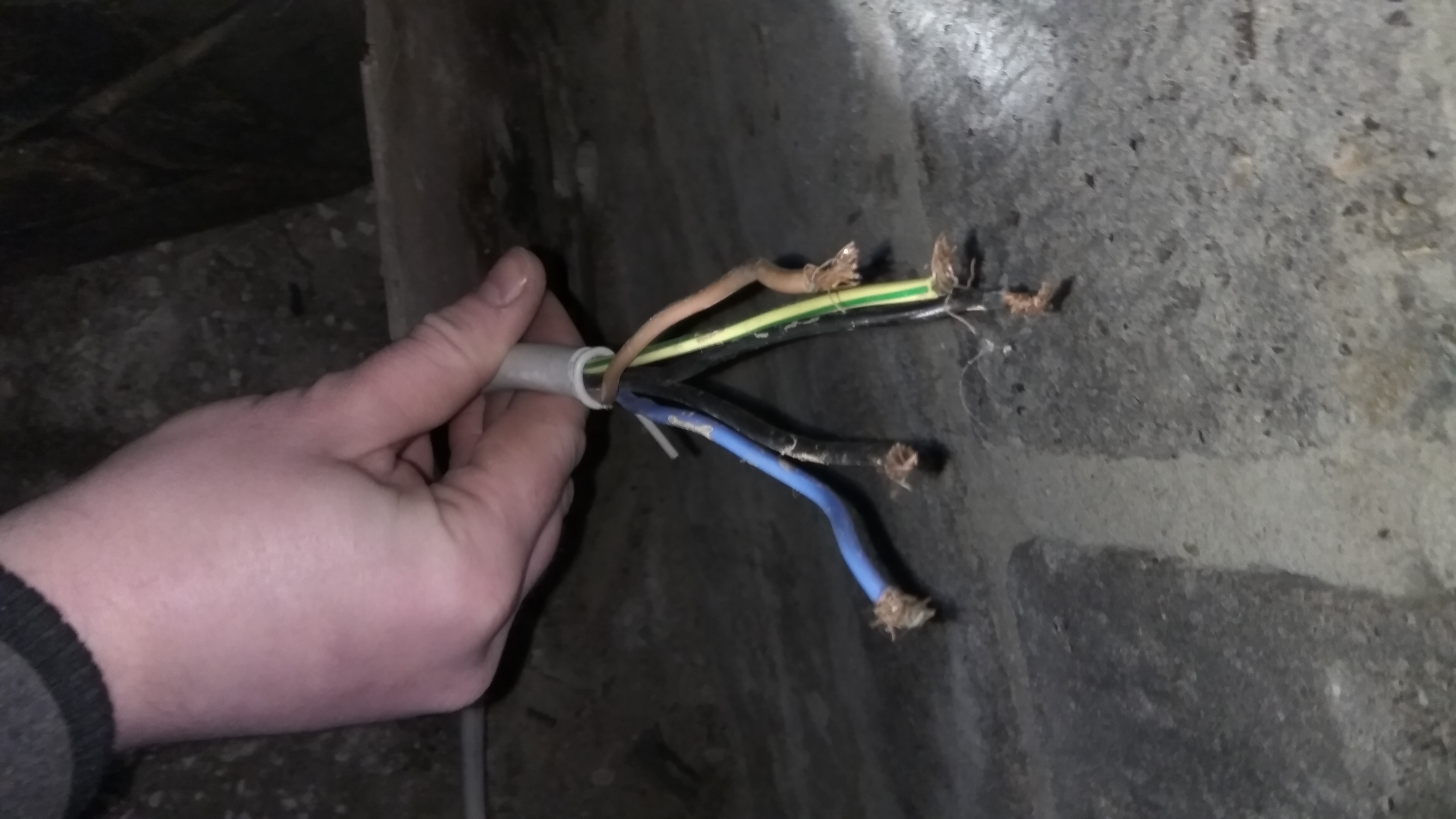

    Hello, I received a built-in stove with an induction hob, it would be nice to use it.
    The equipment has a power outlet, now cables only. The question is whether it can be converted to a typical 230v input?
    I read that apparently the oven can operate normally, while using all heating points, it can heavily burden the home network. We are happy to read your opinions and suggestions. Naturally, I will commission assembly to a specialist, but it would be good to have a minimum idea ... With these specialists, you know how it is sometimes ;)
    Thanks for the help ;)

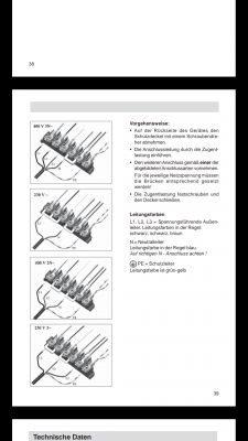

    Privileg eh-70900 stove
    As for the information obtained, I threw a Google password, without verifying the quality of advice, hence asking here ...
    Added after 10 [minutes]:
    I found instructions.
    It shows that it can be modified ... By leading the cables out of the way. Am I right or wrong? Stove & Induction Hob Conversion to 230V: Overload Risk, Solutions and Specialist Recommendations

    leinad86 wrote:
    I am right or wrong
    To some extent you are right, there is such a possibility. But is your home installation ready for it? This must be checked by an electrician on site.

    I am curious how much else you can write on the forums that connecting such induction in Polish conditions under one phase is asking for trouble.
