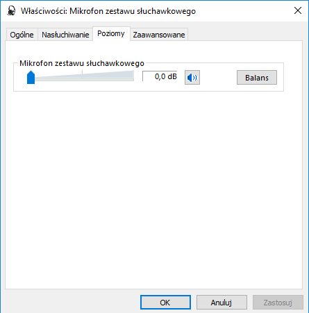

    Hello, I have a problem with the HyperX Cloud II Mic. I can not configure it, change the dB value (it is set to 0 dB and can not be changed), as if the system has not seen it. When I connect another microphone it works without a problem. I do not know what the problem is, the drivers are up to date.
    Motherboard: Asus z170 Pro Gaming

    Buttons on the remote which is basically a USB sound card you tried?

    I tried and nothing changes.

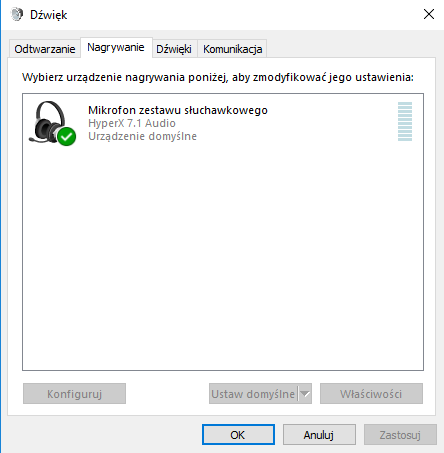

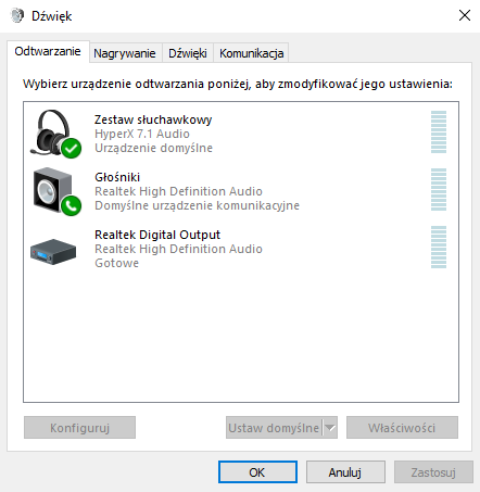

    How can it be the same? How did you connect to the adapter, you connected it to the realteka and what now in the realteku you have mute the microphone?
    What did you and what did you connect to?
    In general, it looks like you click the right clock on the loudspeaker and then select the device for recording later the playback device. Make screenshots. The remote control of these headphones is to be in USB.

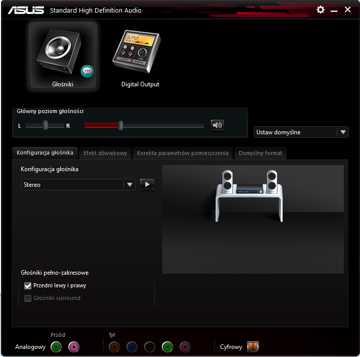

    My point was that I tried to connect the headphones without a "pilot" and it did not help. Realtek can not see the microphone, I do not know why.

    Try to download the audio driver from the realtek website
  • #11 17073904
    Hypercore
    Posts: 10
    I just downloaded the new realteka and this screen above is up to date.

    I will say so many unknowns. Maybe you have something in the system mixed up.
    Generally, you can see that it has detected the microphone but there is no driver in it at all.
    On other equipment, check with this double cable. It will probably be OK.

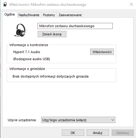

    #19 21290493
    bymcykpyk
    Hey,

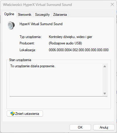

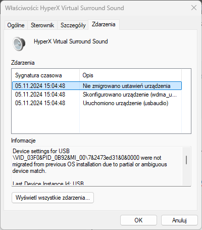

    I got the HyperX Cloud II wired headphones and I have exactly the same problem. It is not an issue with the mute button on the side. The system sees the headphones and gives a message that the headphones are a working device correctly, when I click the event a message like this appears: "device settings not migrated". Is this why the microphone is not working? If so, what can I do to fix it? And if not by this, what else could it be not working by?
    Screenshot of system properties for HyperX Virtual Surround Sound headphones. Screenshot of HyperX Virtual Surround Sound device settings in Windows with a message about settings not migrated. .
