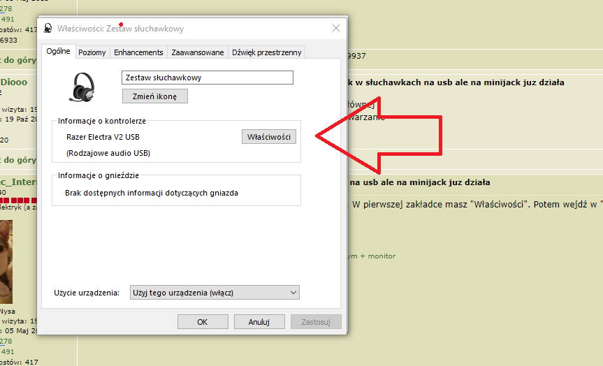

    The sound does not work when I plug in the Razer Electra v2 USB headphones, you can see the candle from the headphones and on other computers they work fine ... on my computer, however, they do not work, "ordinary" headphones on the mini jack work ... I thought it was something with the sound on the disc the main one, so I bought a stud card but still nothing ... PS when I move the slider to turn the slider up or down, I can have headphones either at 100 or at 0 (in both cases they do not work) but when I connect these to the mini jack everything works fine
    My ASRock H110M DVS R3.0 motherboard
    My new Creative SB Audigy FX 70SB157000000 sound card

    The socket works specially, I checked the USB from the motherboard
    I can see my headphones anyway when I go into the sound and then into the playback

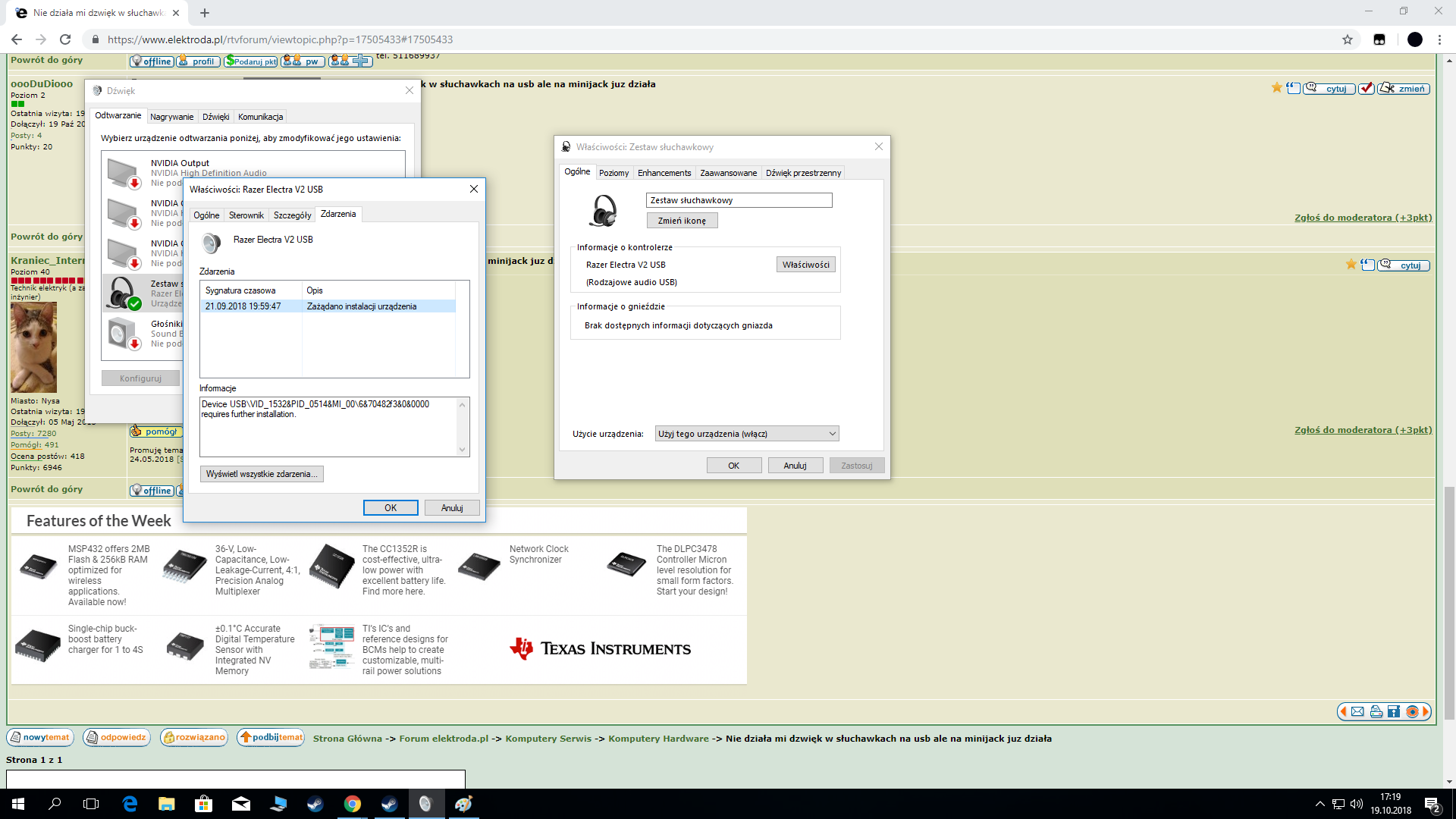

    The sound in the USB headphones does not work for me, but it is already working
    is that it or something else because I can't find "Events"

    I'm sorry I misunderstood

    I can't update it, the only thing I can press is the driver detail

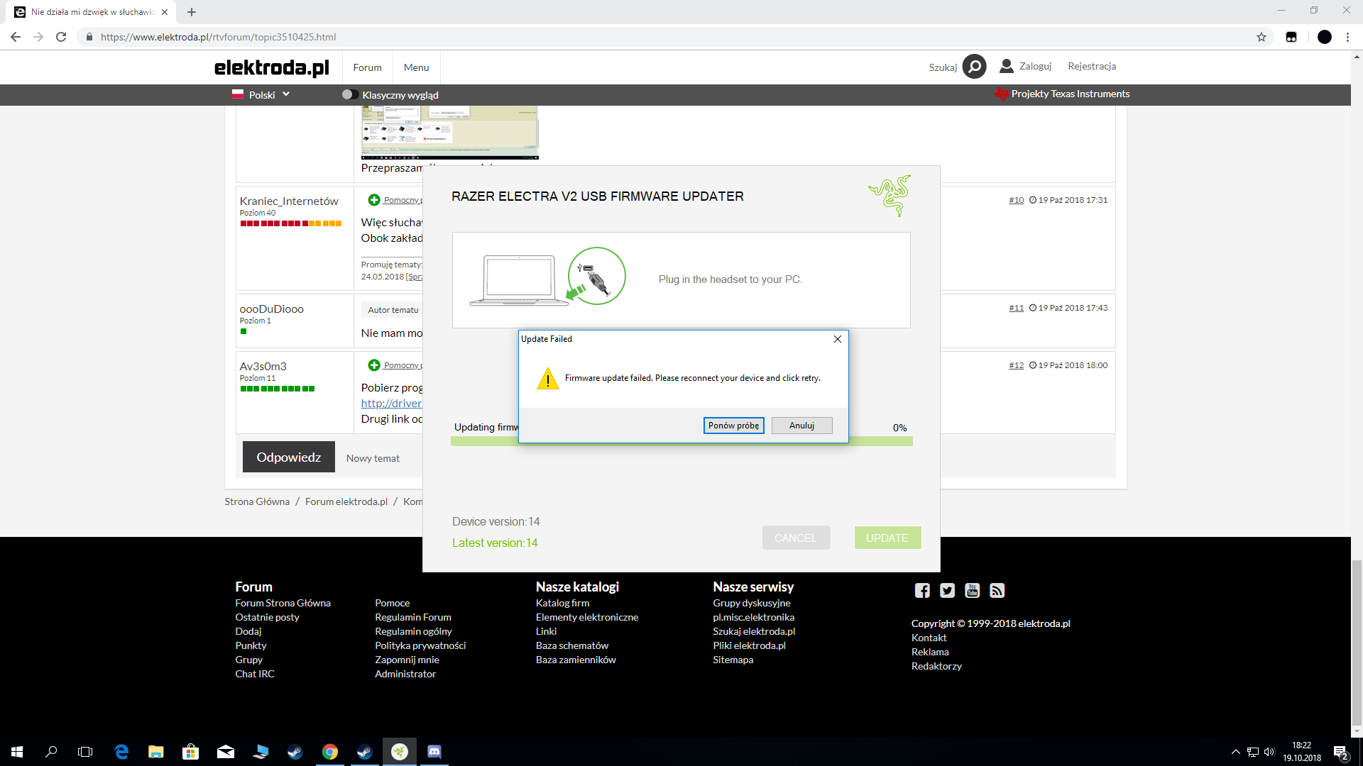

    It shows that I have 14/14 versions and that it does not detect my headphones: /
    Added after 3 [minutes]:
    I had this new sound card a moment ago, it did not even catch the headphones on the mini jack oO the headphones must work because I checked on the phone and on another computer ... when I disconnected the sound card they work normally ... but those on the USB do not work here or here correct ;/
