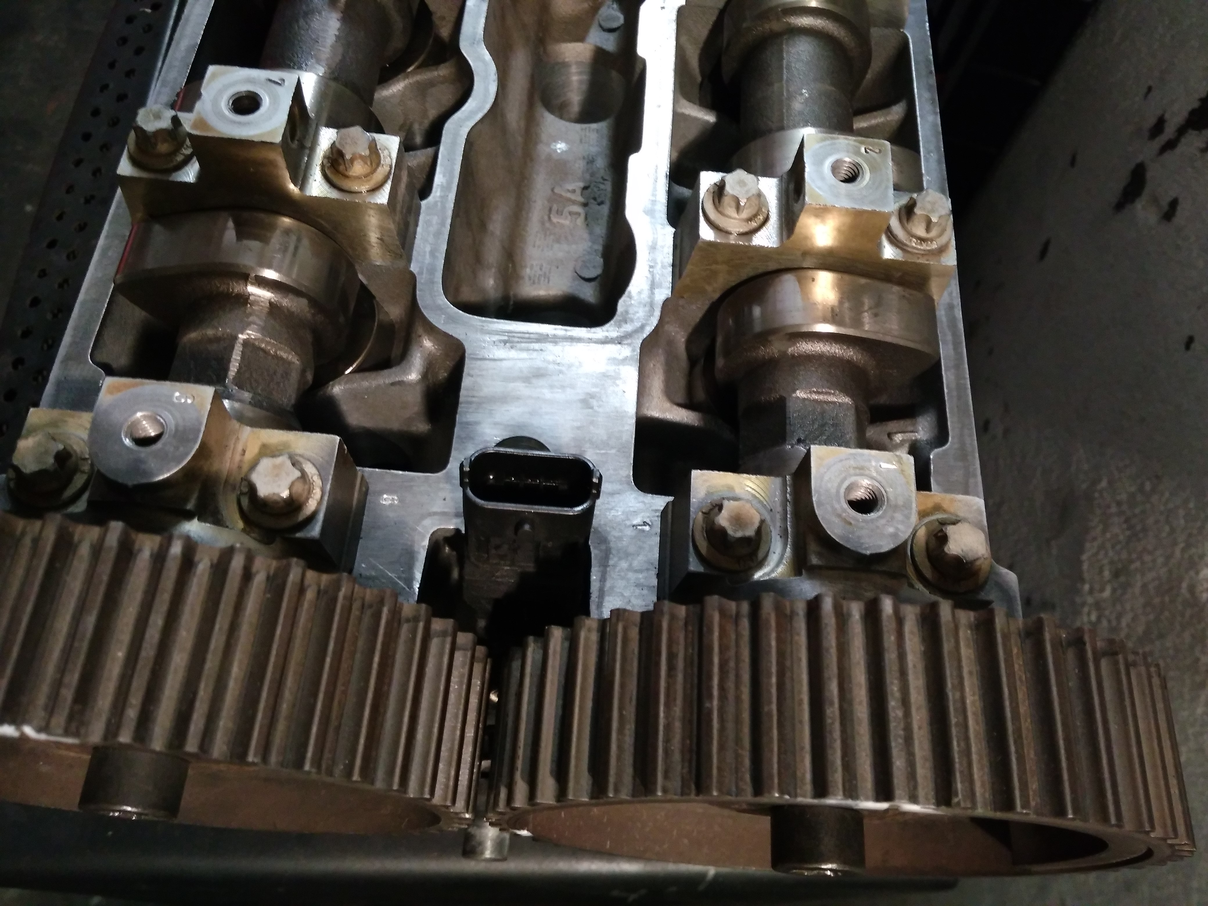

    Hello, kind of banal and yet I fell, I made a head with the Opel Vectra b 1.8 16v x18xe. If someone knows how to set the rollers in tolerance, the date says that the signs from the valve cover, however, here are other pulleys and it comes out to face each other. And in what position should be the cams of the first cylinder. I attach photos [/ u] I will add that on the exhaust shaft there are two features on the pulley on the suction one feature for this pulley exhaust expiration can be assumed in two ways
    • Opel Vectra b 1.8 16v X18XE - Timing Setting, Tolerances, Cam Positions & Pulley Adjustments IMG_20180301_123540.jpg (2.36 MB) You must be logged in to download this attachment.
    • Opel Vectra b 1.8 16v X18XE - Timing Setting, Tolerances, Cam Positions & Pulley Adjustments IMG_20180301_123530.jpg (2 MB) You must be logged in to download this attachment.
    • Opel Vectra b 1.8 16v X18XE - Timing Setting, Tolerances, Cam Positions & Pulley Adjustments IMG_20180301_123348.jpg (1.78 MB) You must be logged in to download this attachment.
    • Opel Vectra b 1.8 16v X18XE - Timing Setting, Tolerances, Cam Positions & Pulley Adjustments IMG_20180301_123417.jpg (2.2 MB) You must be logged in to download this attachment.

    You're wrong in the picture. The lower marks are to be opposite each other, and the ones you have opposite are to be at the top.

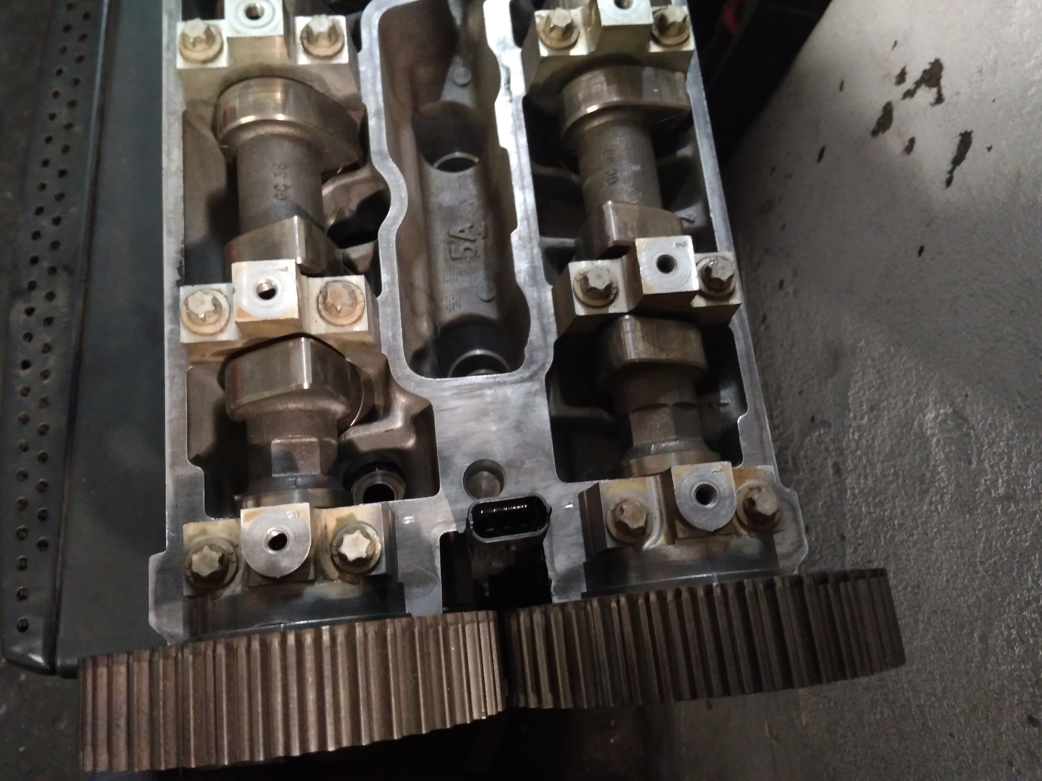

    There are no signs there, it is only on the exhaust wheel I marked with a white marker where there are signs on both pulleys
    • Opel Vectra b 1.8 16v X18XE - Timing Setting, Tolerances, Cam Positions & Pulley Adjustments IMG_20180301_180408.jpg (1.66 MB) You must be logged in to download this attachment.

    You must have the exhaust shaft wheel drive in the EX cutout, you do not show what is under the screw in the pictures.

    Agree the buddy, just how should the rollers be set?
    • Opel Vectra b 1.8 16v X18XE - Timing Setting, Tolerances, Cam Positions & Pulley Adjustments IMG_20180301_181703.jpg (1.53 MB) You must be logged in to download this attachment.

    For the exhaust shaft you set the pin on the EX, for suction on IN

    As in the appendix features at the top.

    Well ok, that is, let someone competent speak for repairing the head 600 PLN ?
    • Opel Vectra b 1.8 16v X18XE - Timing Setting, Tolerances, Cam Positions & Pulley Adjustments 1519931428236857463228.jpg (1.9 MB) You must be logged in to download this attachment.
    • Opel Vectra b 1.8 16v X18XE - Timing Setting, Tolerances, Cam Positions & Pulley Adjustments 1519931392049-177292005.jpg (1.71 MB) You must be logged in to download this attachment.

    That's how cams sideways and signs at the top, overlap with the signs on the housing. Mount it, crankshaft, without candles you will sense if it interferes but it should be good. Also use the camera before disassembly, it is useful.

    The auto-made x18xe features according to the valve cover are set as you wrote greetings and thanks
