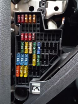

    Hello, I bought a Golf V Variant car with 1.9 tdi (BLS) engine 2007 year. I have a problem with the cruise control, which does not activate at all after turning on the throttle and heating the rear window, which from what I noticed does not work. I'm not fluent in car service, so I wanted to start by checking the fuses. Does anyone have fuse diagrams for this model? because so far it's none of those that I found nor how they fit into what I have.

    KMal, thanks, but the fuse box on the side of the car looks different, There are 49 places for fuses inserted vertically. I would also like to see a fuse scheme from the engine compartment if I can find it at all. Of those fuses that are put together, all are good, but I do not know who is responsible for what. In the passenger compartment there is no shortage of any because there are no other free contacts, but there are many free places in the engine compartment.

    Take photos, in the engine compartment too.
  • #6 17084464
    actomek
    Posts: 10
    Rate: 31
    GOLF V 1.9 Tdi BLS - fuse fuse GOLF V 1.9 Tdi BLS - fuse fuse

    These are compatible with photos. There may be minor differences, because the division is up to 5 / 2007r, from 5 to11 / 2007 and after 11/2007.
    There are both boxes from 5 to11 / 2007 in the annex.

    The car is producing this period. In total, I still do not know which fuse is responsible for the cruise control and heating the rear window, there is no such position in the fuse list.

    There are relays behind the fuses. R5 is responsible for heating the rear window.

    It seems that everything is ok with it. I will continue to find out how I will find out.

    For now, I am closing the topic, it turns out that the rear window heating works, but as for the cruise control it looks like a damaged handle.
