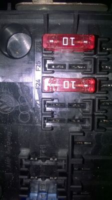

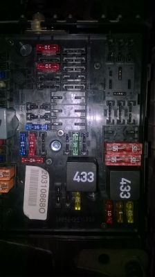

    I have been in the VW V Plus for a week of 2005.
    I read about the fact that these versions have different fuse boxes, so for those who know the subject I will give a VIN number on which you can probably find out which versions of the boxes they have.
    In my Golf Plus the fuses are located under the engine cover and behind the storage compartment at the left knee (there are no those on the side of the dashboard - I checked)
    Unfortunately, there are no fuse sets for my car, because those schematics that I managed to polish up than in my car. How did I say that? For example, fuses F25 and F26 (30A) are for the front dipped beam and in my case there is an empty slot (and 10A) and the lights are on.
    I upload photos of these boxes.

    Welcome back.
    Below is a link to fuses for my case.
    https://www.vwgolf.pl/dane-techniczne/vw-passat/bezpieczniki-passat-b6/
    Unfortunately, I could not find the Golf Plus but it coincides with the Passat B6 (depending on the version of the box)
    As far as my case is concerned, the fuses from the lights are those with the engine numbers F47 and F48 (40 A) - large
    The blower is the ones under the steering wheel. It is a 40 A fuse - item 56 (the electrician checking the fuses of lights did not put it in his place, which can be seen after removing ... no words), you had to come to yourself because we have specialists like that.
    Also if someone wants to support you can use this scheme from the Passat B6
    Subject resolved.
