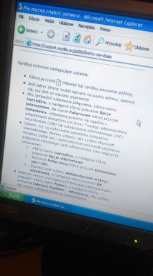

    Hello, I installed windows XP home edition yesterday from the original board. Everything was well installed, I installed internet drivers, etc. When the notification about system activation popped up, I gave it to activate online now, but as if there was no access to the internet, although as I entered the search engine, normally bing worked (explorer) but after clicking any link on the page dumped an error that can be seen on the screen. So I thought it was a hardware error so I translated it to another computer, but the same thing. So I called the microsoft to activate it by phone and everything was OK, but the internet was still down. For now, I wanted to let it go and put the disk back, but about 2 seconds after the loading started, the windows logo was blasting the second bluescreen and turning on again. I decided that I broke it because it is the OEM version and it is for this reason. So I did everything again, formatted the disk and installed the system, I haven't called the microsoft yet. And there is still no internet .... I did all the things they write there and nothing. I moved instalke chrome via a pendrive - it didn't want to be installed because there was no "internet". I pinged sample pages and all the answers are correct. I don't know what to do anymore, and since XP is not supported, MS won't help much with this activation.

    Set the correct date in the system and in the BIOS.
    Write what is this computer.
    No screen.
    The system does not transfer with the disk between computers, because you will have, e.g. as you wrote - BSOD on loading.

    Well according to internet ping is provided. By. IE is not there. Did you set the date?
    Post result:
    ipconfig / all

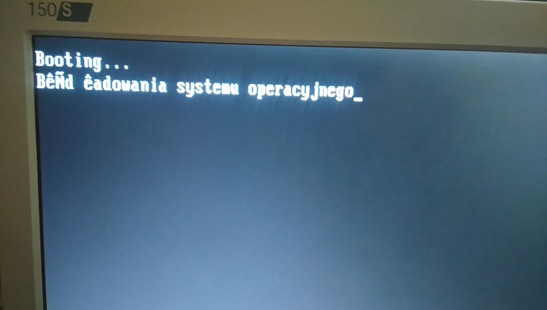

    Hello, yes. It turned out that the computer was SP2. I downloaded SP3 from another computer (from Good Programs :D ) and I moved to that. After installation it popped up that to initialize the computer must restart, I gave it ok turned off, turned on because an error occurred on ss

    You have a working disk in this computer? Replace screen with CDI or Mhdd (under F8).

    on the second disk the same problem (the first)
    I can't check it out. There is nothing like that in the bios, and on the f8 there is a boot menu. and immediately after the bios this error pops up

    You press F8 on Mhdd, which you start from the bootable media.
    Also check the framework -> www.memtest.org

    @PanKoXeR You really do it on the head:
    I have already written that systems are not transferred between computers.
    I asked in the second post what PC it is. I didn't get the answer, so I won't find out what the second-first and first (second) disk is ... ;)
    You have the option of:
    1. do FreeDOS on a pen using this:
    http://www.programosy.pl/program,rufus.html
    2. copy the files from the package to the pen, which I attach, without COMMAND.COM overwriting.
    3. After booting the pen, type MHDD, ENTER in the prompt.
    4. select the disk and press F8. Enter the list that will pop up.
