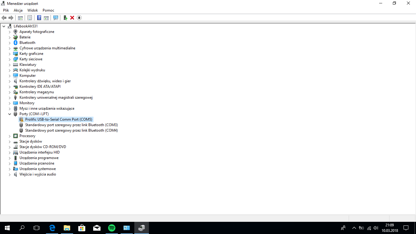

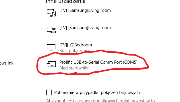

    Hello! I have a problem after connecting the converter to a laptop with Win 10, it shows a driver error,
    I tried to install some driver but it didn't work.
    Please help.
    I have something like this: Converter USB-UART RS232 PL2303HX adapter
    • PL2303 Prolific - USB to TTL converter - driver error Zrzut ekranu (2).png (22 KB) You must be logged in to download this attachment.

    Hello. Show settings from screen Device Manager?
  • #3 17094180
    Mnster
    Posts: 80
    Rate: 14
    I gave a screen of device settings.

    But that's not Device Manager? You have it in the control panel.
  • #5 17094226
    Mnster
    Posts: 80
    Rate: 14
    Ah, ok.
    I don't use Windows 10 on a daily basis
    • PL2303 Prolific - USB to TTL converter - driver error Zrzut ekranu (4).png (86.97 KB) You must be logged in to download this attachment.
    • PL2303 Prolific - USB to TTL converter - driver error Zrzut ekranu (3).png (68.34 KB) You must be logged in to download this attachment.
  • #6 17094286
    Pedros050
    Posts: 17915
    Help: 2471
    Rate: 3928
    Set Port Setiings to COM1 and it will work.

  • #8 17094649
    Karaczan
    Level 42  
    Posts: 6760
    Help: 869
    Rate: 1128
    Download the drivers for the PL2303HX from Win7 and force them to install manually.
    PL2303HX is not officially supported in Win10 ...

    #15 17095867
    PF
    Level 19  
    Posts: 547
    Help: 16
    Rate: 71
    You have a converter made on the "left" layout.
    The fact that you don't work on the original driver is, say, a chip manufacturer's protection.
    Install it, it works 100%:
    • driver.ZIP (2.15 MB) You must be logged in to download this attachment.
    Everything works.
    Thanks ;)

    The left chip is only the 2nd problem ...
    The HX series does not officially run under Win10. You can even read about it on the manufacturer's website.
    No matter if original or fake. With the difference that the original will run on the original drivers from Win7, and the counterfeit requires the modified ones you posted ;)
