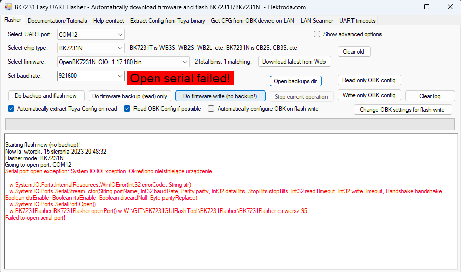

  • Serial port detected but flashing cannot open it
    #3 20694815
    Filip8X8
    Posts: 138

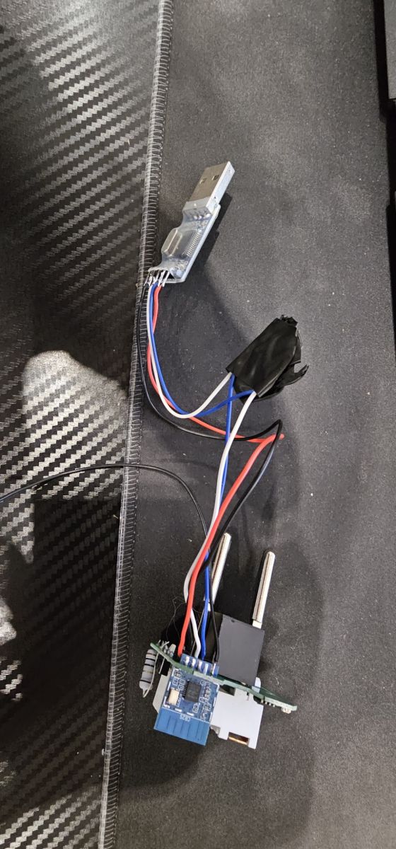

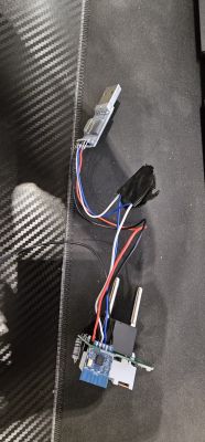

    I don't know, I'm not that familiar with this subject of programming etc. But I can solder well and I can solder a few wires to a chip. The programming issue is worse, I don't know what could be to blame.
    I have everything connected together as in this picture USB plug connected with wires to a circuit board and electronic components. Screenshot of the BK7231 Easy UART Flasher program with an error message Open serial failed!.
    but as you can see the port is detected, i.e. the programmer is detected, but already when trying to sflash it shows that the serial port can not be opened. What could this be the fault of? And what is the best way to do this?
