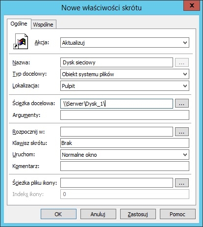

    I have a question about drive mappings on domain accounts. I normally map the drive with a script, but it displays on my computer. I would like it to be mapped on the desktop. Anyone know how to do it?

    Then create yourself - via GPO - a shortcut on the desktop, what's the problem
    Using a desktop shortcut in Default Domain Policy
    #13 17098358
    jprzedworski
    Posts: 5373
    Help: 758
    Rate: 828
    I have just checked for a test. In "Default Domain Policy" -> User configuration -> Preferences -> Shortcuts I added a shortcut as in the picture (example) and there is a shortcut to this network drive on the desktop.

    Well, it's funny that I've been doing this for a long time and it doesn't work for me.

    Malice of inanimate objects ;) or some minor mistake. I have Windows Server 2016 + Windows 10 and it worked. I don't have it on a daily basis, because I don't want such shortcuts, but you can. I put it in the Default Domain Policy so as not to play around with little things. Since other rules work there, this one should too. I have no idea what else you need. I understand that what you want to connect to the desktop has been previously defined as a shared resource. Anyway, it wouldn't be possible to map it otherwise. And try to make such a shortcut manually on the desktop with the same path to the resource ("Target path" in GPO configuration).

    Everything is already working. There were minor permission issues.
    The @jprzedworski method works without any problems. I had a problem with file permissions.
