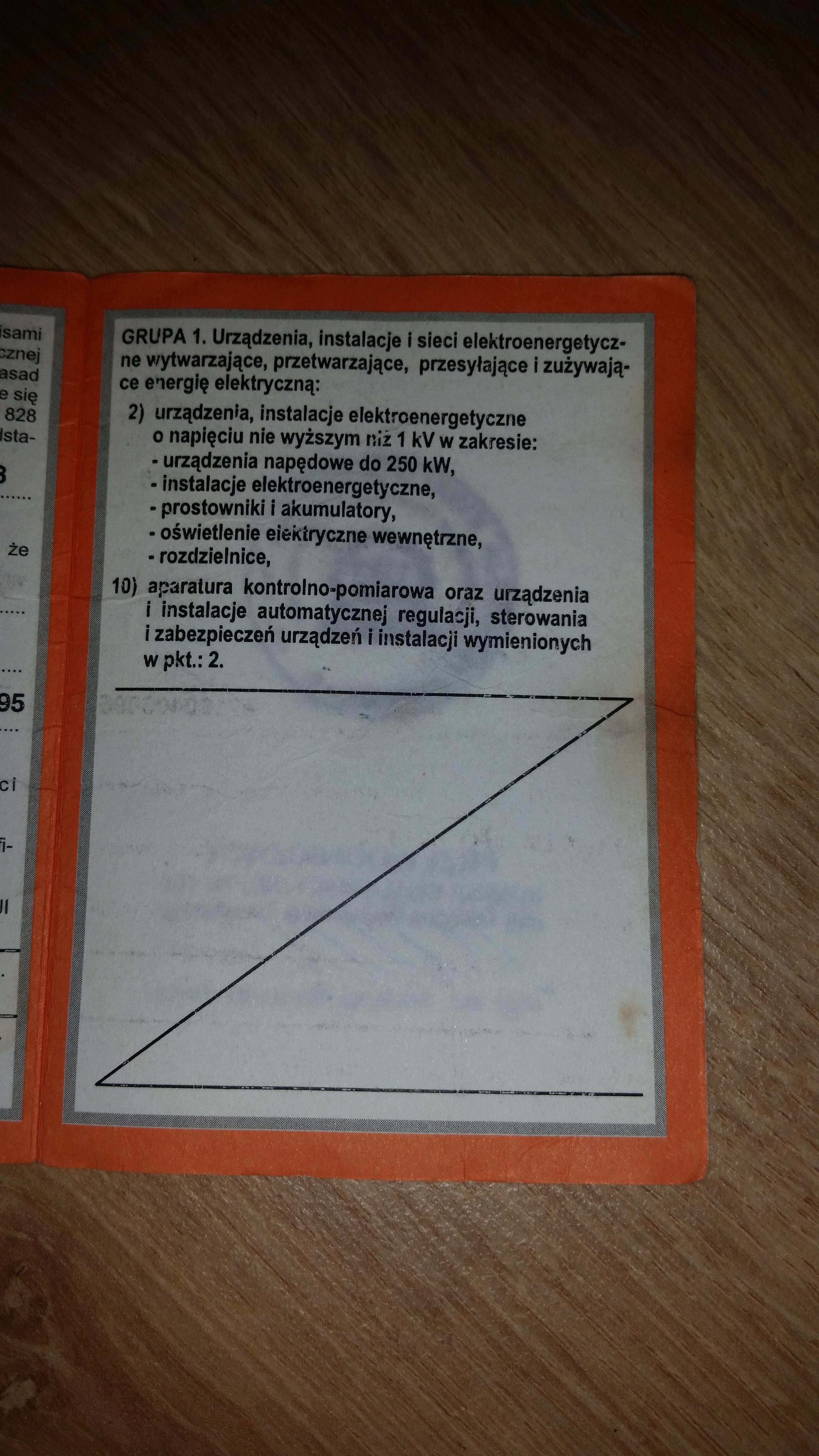

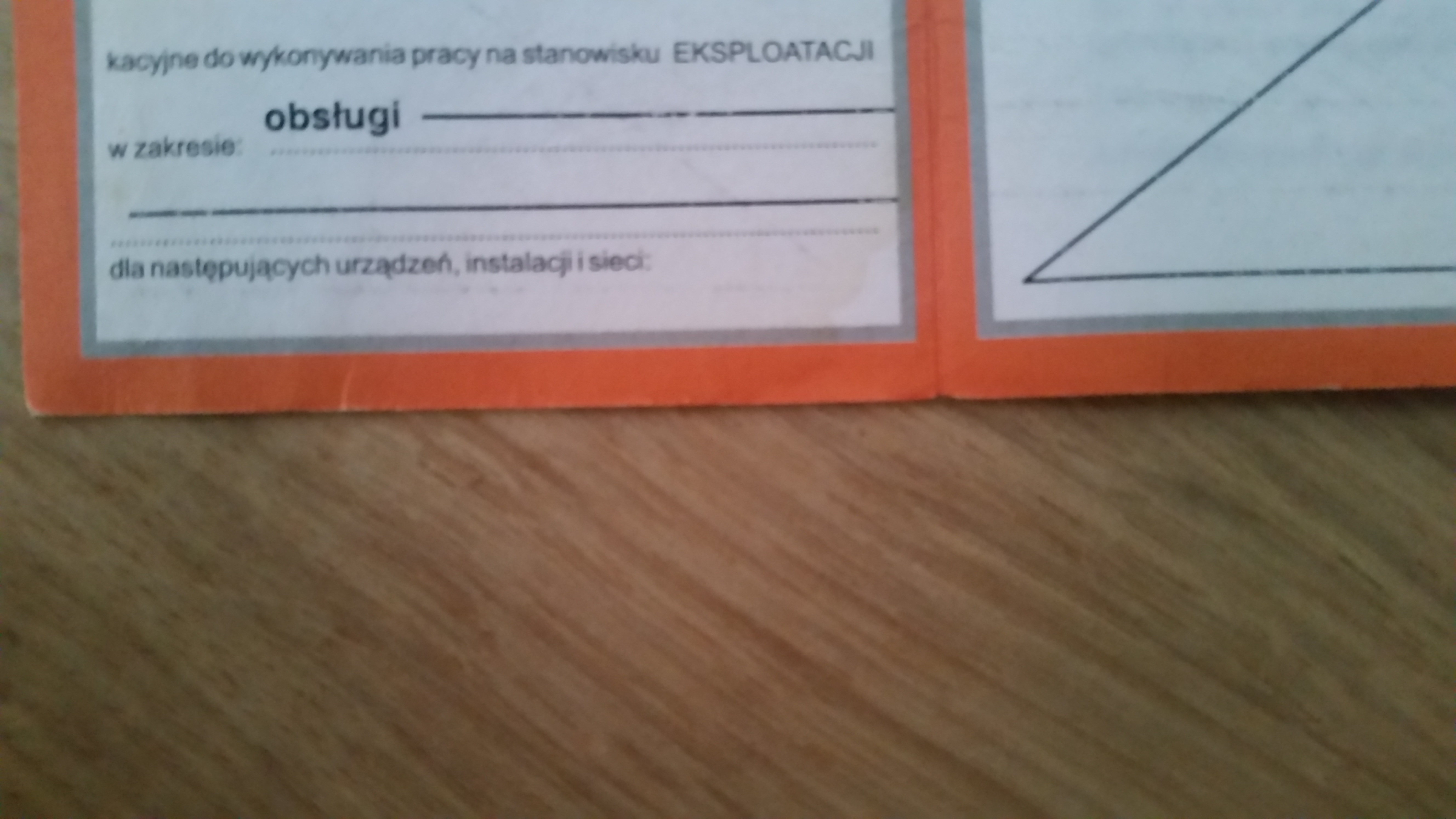

    Hi to all.
    Please let me know if I can connect my induction hob and enter my warranty card with my rights?
    SEP E.
    • Permission to Connect Induction Hob & Enter Warranty Card: SEP E Rights Inquiry 15210203340772092350471.jpg (2.04 MB) You must be logged in to download this attachment.
    • Permission to Connect Induction Hob & Enter Warranty Card: SEP E Rights Inquiry 20180314_102643.jpg (1.55 MB) You must be logged in to download this attachment.

    "Specialist installation requirement] Kitchens and gas, gas-electric and electric hobs (with the exception of those factory-fitted with a single-phase connection cord) require connection to the gas and electric installation by an installer with the required permissions, who confirms the connection of the equipment in the Warranty Card, in the "Product connection certificate" section, providing the date, legible signature and stamp. Violation of the requirement provided for in the previous sentence shall void the Warranty. The cost of connection shall be borne by the user. "
    So many warranty provisions for AMICA equipment. This provision indicates that the connection should be made by a person who conducts business activity and at the same time possesses energy licenses of the appropriate category.

    There must be a stamp. All you need is an authorization number and signature. You do not need to have a business, because you can do it on a contract basis.

    So my permissions on the card are sufficient?
  • #7 17102312
    stomat
    Posts: 5728
    Help: 257
    Rate: 1982
    In principle, no, because you have in the service and not assembly, but so to the end probably no one knows, there is a huge jumble of it.
