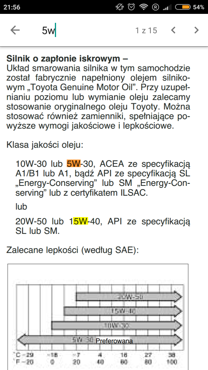

    The elf 5w30 oil has
    Specification
    It significantly exceeds the requirements of the following international standards:
    ACEA: A5 / B5
    API SL / CF
    And the instruction says Toyota, I am sending a photo
    I do not understand this for help

    motyl7104
    Posts: 152
    Help: 24
    Rate: 34
    after all, in the instructions they will not write that the elf, castrol, etc. enter the oil producer's catalog, it will be written that it is recommended for the Toyota. life. I do not think that other companies produce oil of inferior quality than "urania" to iveco. if the standard is correct, then it can be used.
