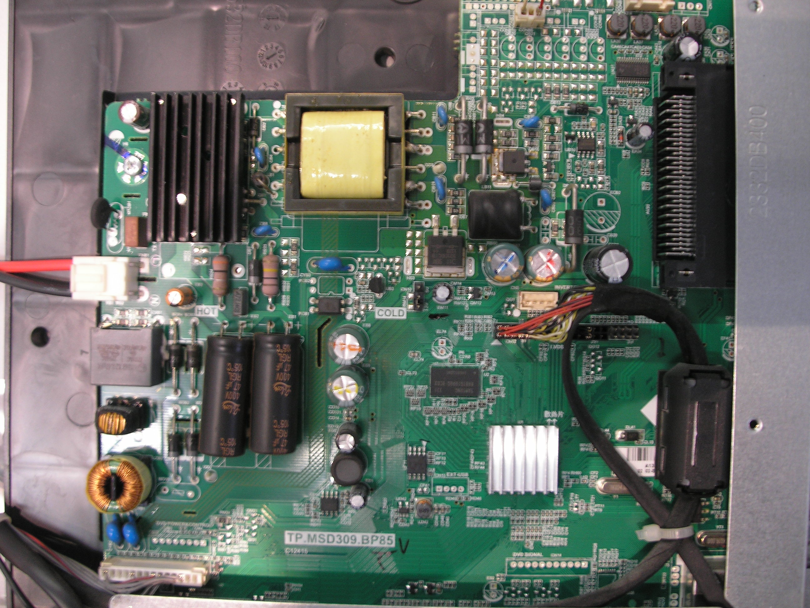

    Good morning,
    The TV does not turn on. The diode is on and the TV does not react to the remote control or the buttons on the TV. From what I read on the forum it helps to upload a new software. Please help. Where to get soft? How to upload it?
    Thank you in advance and best regards,

    order
    • MST_EXT_SPI GD25Q32.BIN (4 MB) You must be logged in to download this attachment.
    • TV Blaupunkt does not turn on, model 32 / 141I-GB-5B-HBKUP-EU - soft is needed P1010689.JPG (913.68 KB) You must be logged in to download this attachment.

    Borics,
    I understand that you sent me a photo of this system for a reason? Can you please say something more that I must do Uploading grade fails. The TV does not respond. Can I ask for additional tips?

    I already know more. I read through the holidays if the TV does not respond to USB and an attempt to upload the software is the system I got in the photo from Borics to be replaced.
    The question is if I change it to the used system, what is the guarantee that the TV will work properly for a long time?
    Is it impossible to do this by soldering some "guilty" element from this PCB?

    You do not have to install this on USB, but you need to rewrite the flash with the programmer or overwrite the flash on the main board with the EXT.ISP programmer via VGA connector !!!!!!!!!!!!!

    Thank you for your tips but without step by step manual how to to this I will defend myself before I will even start :)
    If you would be so kind to give me information how to to this step by step I would be very grateful. I think I have skills to to that but only my knowledge is not enough.
    Please dedicate few minutes for me and explain.

    The send dump data should be entered in the flash icon I use with a writer I use the RT809H writer. It's fast and easy. Data is tested and good based on main board and display! It must work!

    Thanks. Works great.
