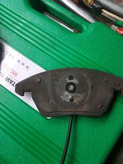

    Hello, I have such a problem recently, I started to knock something in the left wheel while driving straight ahead at low speed when the wheel hits a hole unevenness, you can hear a strange knock, shock absorbers have been replaced x2 spring ok, pillow Shock absorber bearing new, rod stabilizer, rocker pin, hub with the bearing because it was humming, the joint at the hub and the knocking still shows, at the diagnostic station it was said that it is ok and I have no idea what can knock like that, I will add and knocking is like a wheel hits a hole unevenness, while when driving normally silence only shows as on a small the speed I'm going.
    Anyone have any ideas what it could be ???? or where to go with it ??

  • #12 17133054
    kenumo
    Posts: 172
    Rate: 38
    The problem solved strange knocking is the effect of a damaged handle / spring of the brake pad that is embedded in the piston, probably the mechanic damaged the hub when replacing the hub and did not deign to put on new ones, which resulted in this knocking in the suspension, below the damaged block.
    GOLF V - Left Wheel Knocking Sound Over Holes & Uneven Surfaces: New Shocks, Springs & Bearings
  • #13 17133056
    kenumo
    Posts: 172
    Rate: 38
    After replacing the brake pads, the problem was gone.
