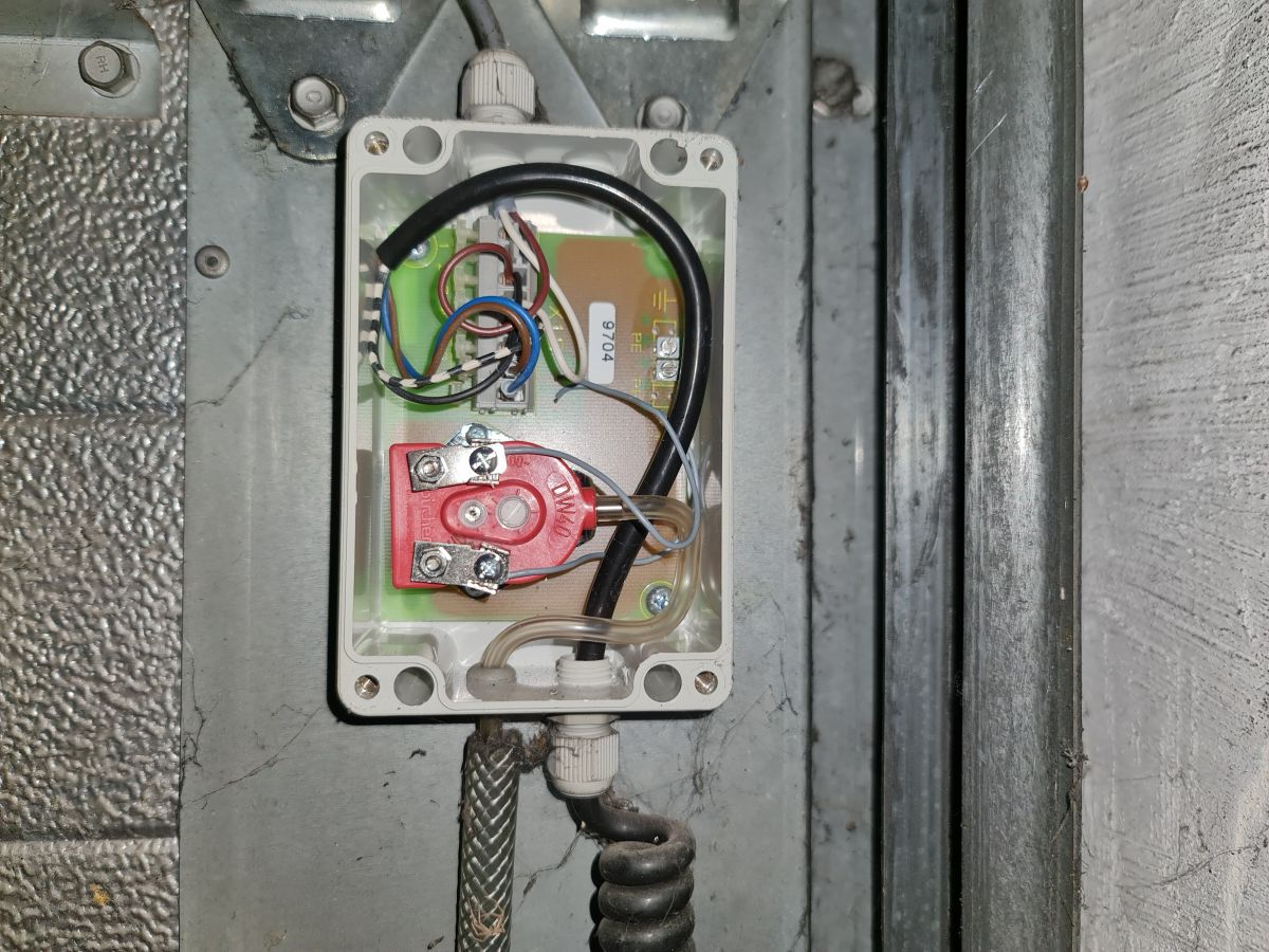

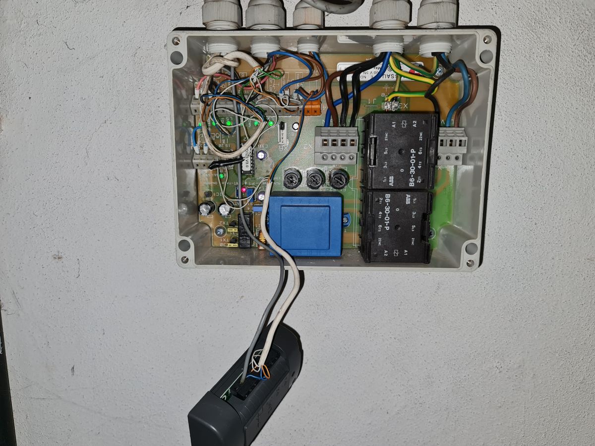

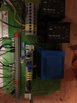

    I have a gate operator with a Nassau ND200 control panel. The connection is quite simple - most terminals described and with drawings. The gate works, the limiters work correctly, the pneumatic sensor also works, but not as I would like.
    It seems that this control panel is programmed in some way, does anyone here know how to change its behaviour?
    What is wrong as I would like? E.g.: in order to lower the gate, I have to hold down the lowering button, even though the gate reaches the bottom and stops at the bottom end, when I press the lowering button again it wants to lower further - the cable falls off the drum, the pull-rod switch, where I have connected the remote control, only opens the gate. And there are a few other things that don't work for me.

    Adrian managed to get the subject under control.
    I did not have a pneumatic sensor connected in the seal, there was a jumper in its place.
    It turned out that immediately after switching on, the control panel tests the operation of this sensor by pressing the gate to the ground. If the sensor works ok, the gate works properly up and down.
    the rest of the configuration suits me perfectly, i.e. it is basic.

    Hi, do you have any documentation for the Nassau ND100 controller? I have the same problem as my colleagues above, that is, after replacing some part, in my case the tension screw, the gate does not work in the automatic, I can't adjust it.
    There is an error LED on the control unit.

    You need to adjust it so that when going downhill, the limit switch will work first, and about 1 second later the pneumatic rail. If the order is different or you don't hit the small time window, you will fail the strip test and it will not work in the machine.
  • #9 20668847
    wpr91
    Posts: 40
    Hello, thank you for the hint. In fact, there are limit switches in the mechanical transmission that I had not noticed before. I moved them around a bit and it runs fine. Regards

    The pneumatic switch is not working as intended when the door is in "dead man" in the closing direction. The pneumatic switch should be closed until triggered. Try adjusting it 1/4 turn while measuring ohms on the switch. It should be a closed contact.
