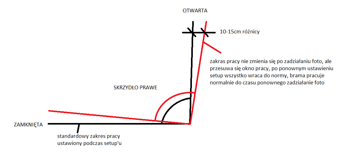

    #10 20123687
    pawelstempniak
    Hello, I have another problem with the set.
    After setup, the gate works 100% as expected, the problem appears when the photocells are activated (set to close). When closing the beam, I interrupt the photo and the gate opens (and it should be), but the closure is not full anymore. After each operation, the photo is about 10-15 cm away from closing. After the second one, 10-15 cm again.
    The only option left in this case for the gate to open and close fully is to run the setup again.
    Currently, I have disconnected the photo and am looking for a solution. Has anyone ever encountered such a situation.
    I am asking for help on the subject.

    Did you try to give times with more margin in the setup? And you have to let the gate open to the end after the photos and it has to turn itself off.

    Hi thanks for the answer. I haven't checked other times, but before I do this, please see the overview drawing below.
    Setting Up FAAC 414 with E045 Control Panel: SO Flashing and Wing Closure Issues
    Of course, after the photo is triggered, I wait for the gate to fully open and only then send a close command.
    If, after closing, I open it again and when closing it again causes the photo to work, the working window will shift by another 10-15 cm.
    In my case, can the reason be the lack of limiters on the opening of the gate?

    If you tried to set the opening only for times, then yes - the lack of bumps on the opening may cause these shifts.
    Unfortunately, these air handling units count the times very imprecise and, in addition, they calculate incomplete strokes incorrectly. The only method for certain closing / opening is to give bump stops (or to choose the mounting dimensions of the actuators - but only at the opening - so that the maximum retraction of the actuator corresponds to the opening position. When closing, it is a game of millimeters) so that the wings have resistance at the ends of movement and add time reserves .

Mark the end point about 1–2 seconds after leaves touch the stop. The controller then adds ~2 seconds automatically. Aim for roughly 5 seconds total spare. "The switch itself adds about 2 seconds to the time." [Elektroda, kotbury, post #20365041]
After power‑up, should the first move be opening?
Yes. Start with the gate fully closed. On power‑up and during position detection, the first commanded movement should be opening. If it closes first, swap motor wiring or reverse the motor order. [Elektroda, kotbury, post #17269267]
When would I swap FAAC 414 for 413 actuators?
Use 413 if you need internal adjustable stops and can accept a 300 mm stroke. The 414 is telescopic with a 400 mm stroke. Swapping usually requires moving brackets to match geometry. [Elektroda, kotbury, post #20363255]
