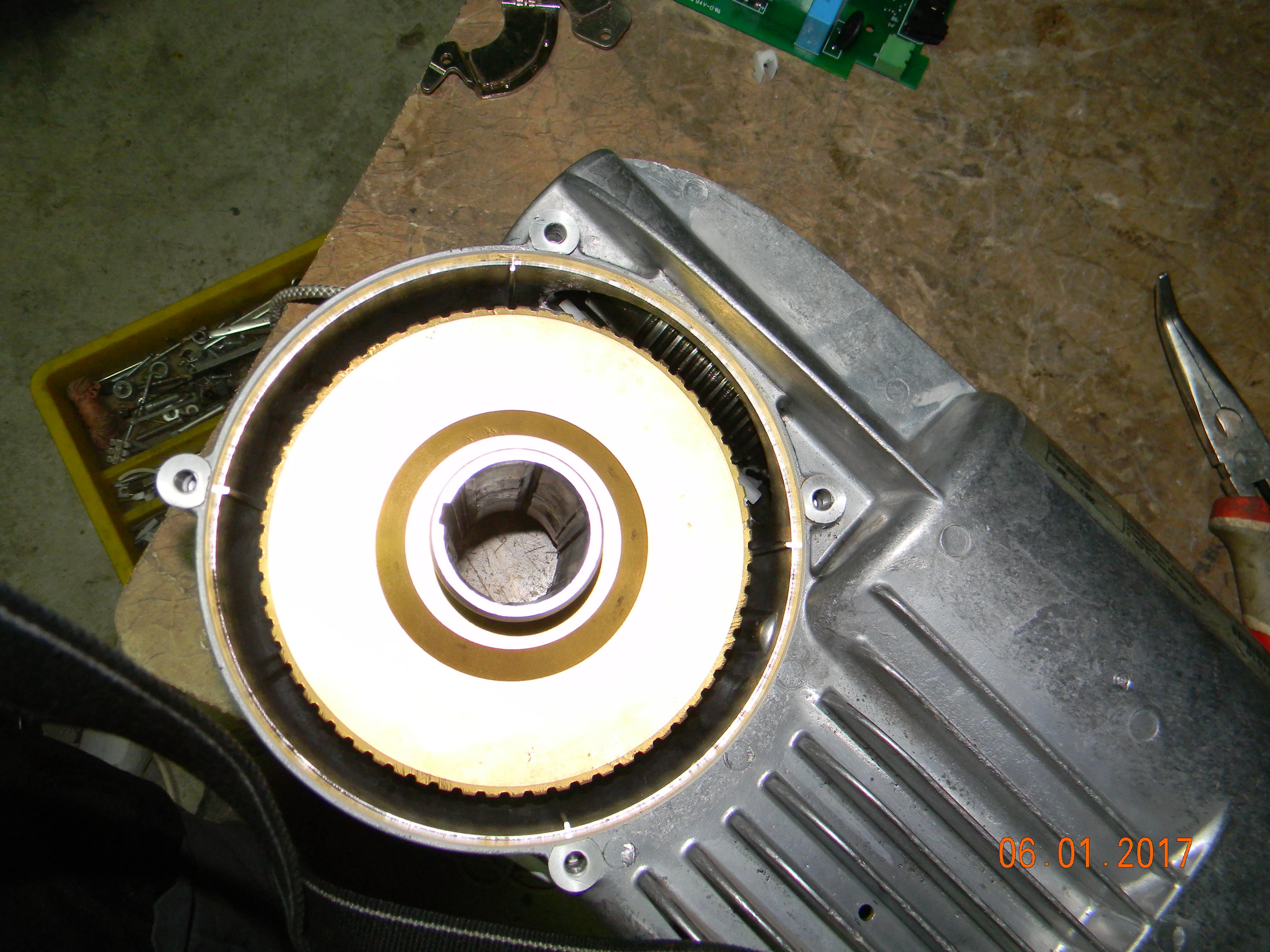

    For posterity and curious how Crowford "1m" looks like inside, disassembly instructions for the 1M Crawford geared motor:
    1.Unscrew the electronics cover on the 3x trox engine,
    Troubleshooting Crawford ECS930A + CDM9 Automation Drive: Motor Not Responding
    2. Detach the ground from the motor (slide with latch)
    3. Unlock the plastic white latches and carefully disassemble the inverter board by pulling out, and you have to unscrew the 2 screws from the outside that hold the heat sink of the inverter.
    Troubleshooting Crawford ECS930A + CDM9 Automation Drive: Motor Not Responding Troubleshooting Crawford ECS930A + CDM9 Automation Drive: Motor Not Responding
    4. Remove the motor terminals, 3 black, red and orange cables
    5. Unfasten the spring holding the engine cover, disassemble the black toothed disc from the rev counter (it is push-fit so gently) and forcefully remove this cover, I did it with a hexagon and walrus pliers additionally using a hammer
    6. Now, unfortunately, we also have to force the impeller out of the bearing, it's hard but it will manage
    7. Forcibly and unfortunately with damage (no approach) we have to remove the motor shaft symmetry, therefore with the symmetry there is a spring-loaded bearing protection (seger) which was pulled out with 2 screwdrivers and a hook
    8. Unscrew the 4x torx gear cover, gently beating from the bottom with a screwdriver so as not to damage the O-ring on the cover and do not spill oil, lift the cover, come off the bearing or not (the bearing must be removed anyway)
    9. Now, gently turning the transformer wheel we must knock out the worm shaft with the bearing (otherwise it will not be possible to disassemble the worm wheel)
    10. For me, it was not necessary to knock out the motor bearing completely, it was enough for the shaft to jump out of it, which allows you to tilt it and remove the gear
    11. After removing the coupling with the shaft we have a visible swing out element with a magnet
    12. It is worth checking and replacing the O-rings on the decoupling mushrooms (the photo shows how the element is made)
    13. Fold in the reverse order.
    14. it should be noted that the wide sleeve bushing snags onto the clutch sliding disk, otherwise there is no release

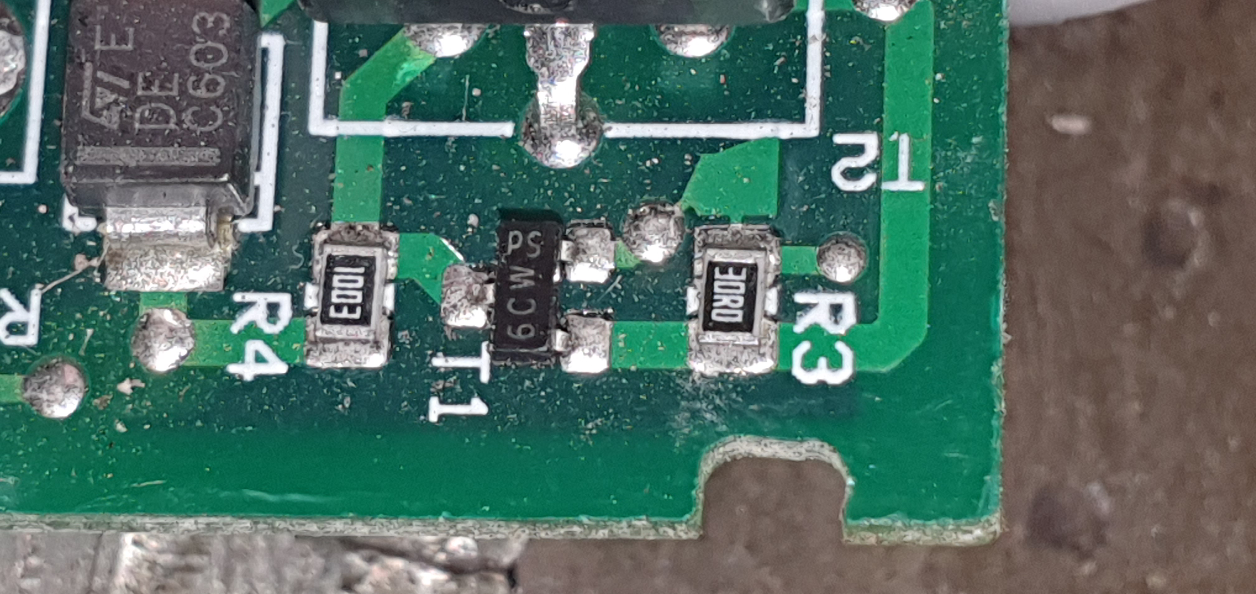

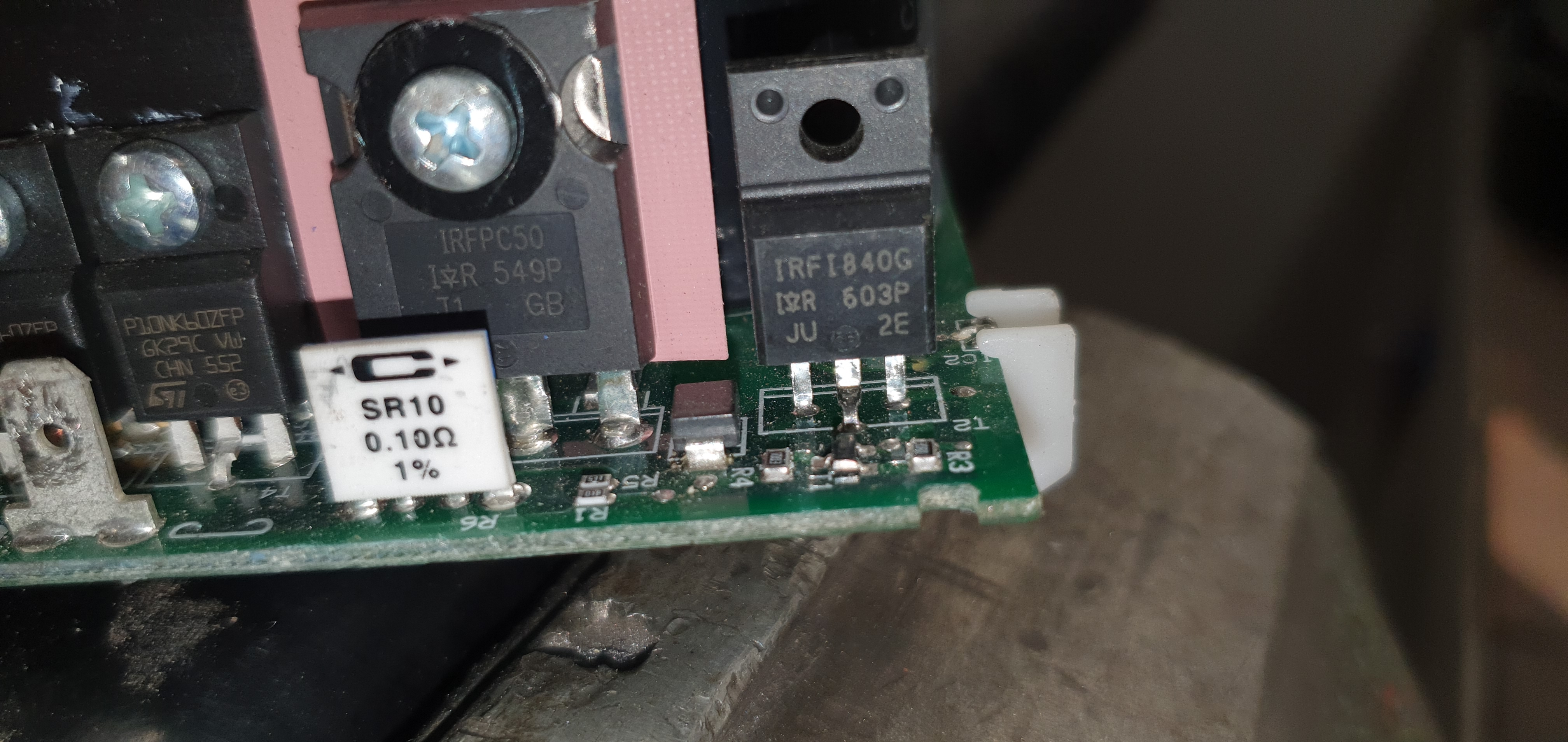

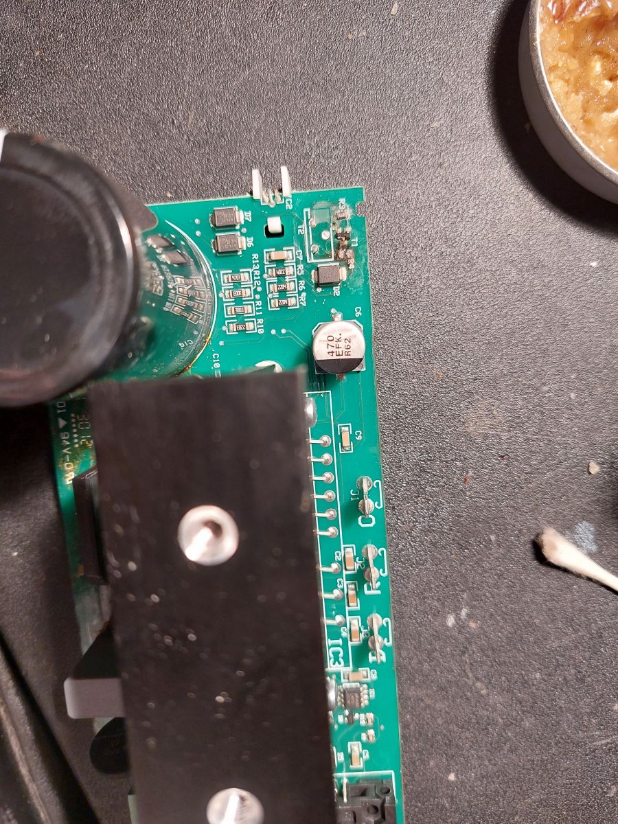

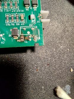

    Hello, I am writing to people in the topic if they would have information about damaged elements on the inverter board in the motor. The damaged elements are R4, T1, R3, T2 shown in the picture, unfortunately I am not able to read them because they were completely burnt. the inverter is in the CDM9 motor. Thank you in advance for the information Troubleshooting Crawford ECS930A + CDM9 Automation Drive: Motor Not Responding Troubleshooting Crawford ECS930A + CDM9 Automation Drive: Motor Not Responding
  • #13 19936466
    waldek418
    Posts: 7
    Rate: 9
    Hello, is it a board with a transmission lock sensor (inverter) or a control board in the engine?
  • #14 19936483
    dakin11
    Level 21  
    Posts: 565
    Rate: 59
    It is motor power board (inverter)

    Maybe it will help
    • Troubleshooting Crawford ECS930A + CDM9 Automation Drive: Motor Not Responding 20220318_164403.jpg (1.16 MB) You must be logged in to download this attachment.
    • Troubleshooting Crawford ECS930A + CDM9 Automation Drive: Motor Not Responding 20220318_164747.jpg (2.3 MB) You must be logged in to download this attachment.
  • #16 19951300
    dakin11
    Level 21  
    Posts: 565
    Rate: 59

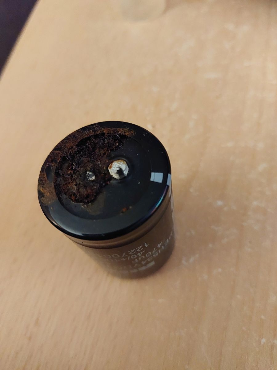

    waldek418 wrote:
    Maybe it will help
    Thanks very much, after replacing it works flawlessly, the cause of the damage was the electrolytic capacitor 470uF, it ran out. I have one more gate out of the 8 which displays E24 when lifting and makes noise as if the bearings have run out. I am waiting for a complete disassembly, plus I will replace the capacitor on the motor power plate.

    E24 is not treated as an error, it is displayed after a voltage failure and loss of position. I would suggest checking the power supply for a voltage drop.

    After replacing the capacitor in the second drive, the error is no longer displayed. With this 24, I will agree that there is a power outage, and if there is a weak power supply, these were checked before repair, so the inverter on the table and to be replaced and solder improvement. The operation brought a positive effect, the gate moves even much better and stops at the threshold. In the case of this drive, the fault 24 appeared in different positions of the gate and at that moment it stopped, it reset when it went completely up, it appeared even when it stood in the upper and lower position after stopping the calibrated position. There are 8 gates on my website, 6 of which have already completed 35,000 cycles within 8 years. The service was coming and they did not know what to do with it, they changed the rollers, seals, adjusted the pressure, adjusted the springs, and finally suggested replacing the cassette plus the engine, and then I went to work. In the photo, the capacitor I replaced speaks for itself. Troubleshooting Crawford ECS930A + CDM9 Automation Drive: Motor Not Responding

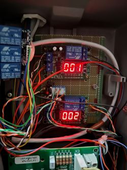

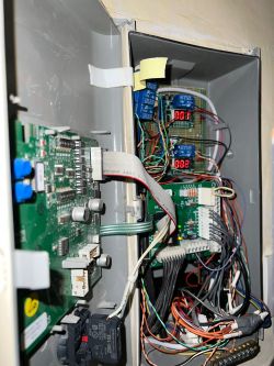

    I don't know why my contractor did this to repair my garage door. Now I have no idea how to fix this and want to change to another brand of operator completely!
    Problem is I have center motor and there isn't much other option!

    What the hell! That is not a fix -- That is a hack.
    Please PM me more photos of this, as I am curious to see what they did, and might be able to help fix the core issue that this is trying to. Wow.

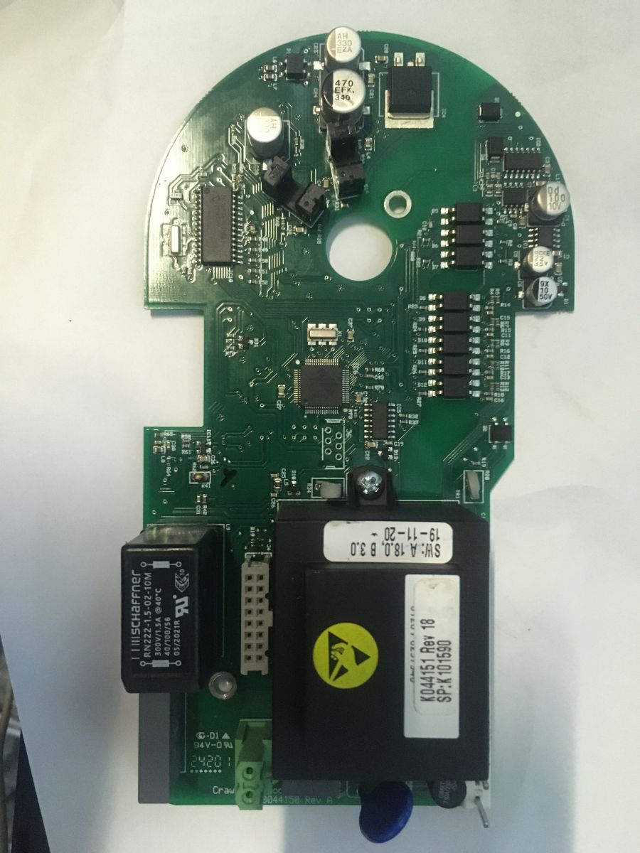

    carla
    Posts: 13
    I have a problem with the Crawford ECS 950 gate, CDM9 drive, E14 is lit on the display and the engine does not start. After switching SW1, E05 is lit, the engine does not start.
    Does any of you esteemed colleagues know what this error means? Where to look for the cause?
    I managed to read IC13, PIC18F2520 on the K047620 Rev:A board
    Does anyone have a batch for PIC16F76 and PIC30F5015 on the board (from the photo) )K0044150 Rev:A

Why does the motor stay idle when I press Up/Down?
The Hall-effect disengagement sensor (marked A 20E 0948 049A) may not see the clutch magnet. If the magnet is missing or weak the drive blocks all motion. Test by moving an external magnet over the sensor: the motor should run both ways [Elektroda, lz11980, post #16177980]

What causes inverter boards to burn R3/R4/T1/T2?
A dried-out 470 µF electrolytic capacitor spikes voltage, shorting gate drivers and resistors. Replacing the capacitor and the damaged components restores full operation [Elektroda, dakin11, post #19951300]
Which component is C603 (GP137) on the power PCB?
C603 is actually a 6.8 V Transient Voltage Suppressor, type SM6T6V8A; it protects logic rails from surges [Elektroda, chucu, post #20822086]
