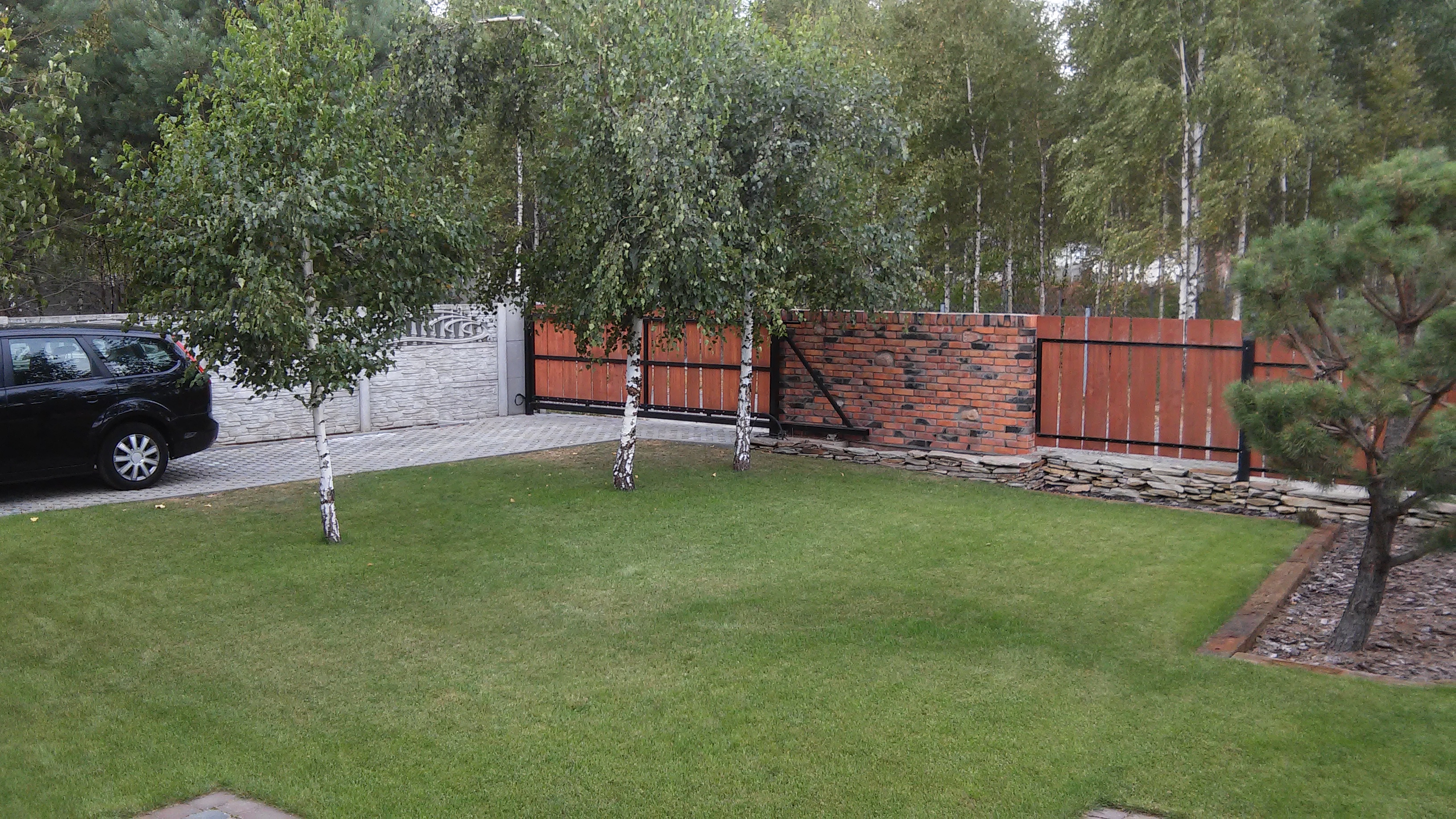

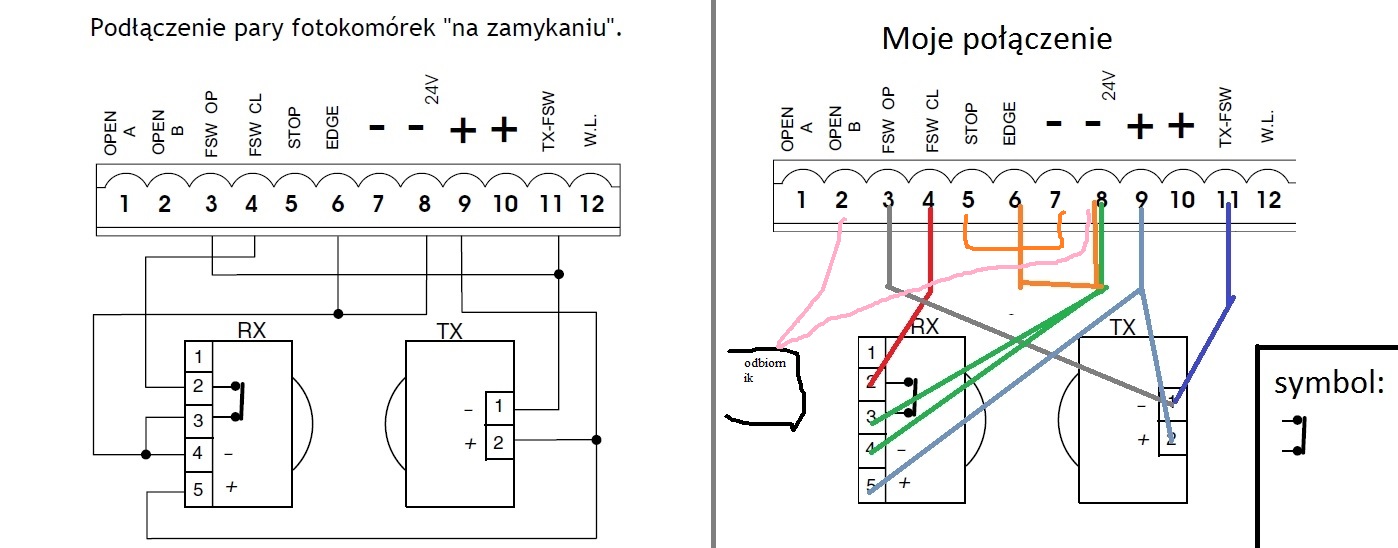

    I installed the gate drive and, as in the title of the topic "Faac 740 gate drive, it behaves as if it had no strength", the motor sounds as if it was buzzing and the gate very slowly opens or closes.
    It occurs under various circumstances (moments), sometimes in the middle of the cycle, at the end ... (force set to max - 50)
    Currently, when launching from the remote control, it will open to 10cm and the strange behavior described above begins, I will add that by opening the gate option from the remote control everything is ok, it will open to the set width and close again.
    The second problem is that I cannot activate the wicket option with an additional switch plugged into the connector 2 and 7 with the radio receiver connected to these connectors (see the drawing). Before adding the radio receiver, both wicket connector 2 and 7 and gate connector 1 and 7 were working.
    I am asking for help, especially regarding the first topic.
    The receiver has normally closed or normally open output contacts?

    Receiver connected as follows:
    NO - from 2
    COM with 8 (not 7 as I wrote earlier, but 7 and 8 is "-". Tested with both 7 and 8)
    There is still an NC contact but it is free.
    As for the capacitor, it is (10uF) and it is a new drive, and as I wrote earlier, the gate starts normally, the entire gate is only 10 cm and slows down the engine.
    If it was a capacitor, it seems to me that the gate would not open either and the same would happen as at the gate.

    Write what kind of gate is it? What big-heavy old-new structure? Because you don't write anything about it.
  • #6 16818616
    ordec
    Posts: 31
    Gate 4 meters clear + counterweight, filled with boards, weight certainly not more than 300-350 kg. He is 5 years old and now I added the drive and extended the counterweight and added the third trolley because the gate was sloping apart, the spacing of the trolleys was too small (this is how it looks like assembled by professionals). In my opinion, the manual opening is quite light.
    Check "dry" (with a meter and after connecting to an external power supply) what is happening with the NO and NC contacts. The defect clearly points to the receiver.
    Maybe the receiver is 12V and it's freaking out? (FAAC gives over 24V)

    And what will happen when I replaced the NO connectors with NC on the radio?
    and the receiver will be connected as follows:
    NC - with 2 and COM with 8 and the NO contact will remain free. Will that not be the problem?

    ordec wrote:
    Me again.
    NC - z 2 and COM z 8 and NO contact pos
    Then the additional opening button will not work, and the opening from the remote control will be delayed by a second or a few seconds.

    Regarding topic 2 - the NO connector was swapped with the NC on the radio, the gate now opens from an additional switch :D
