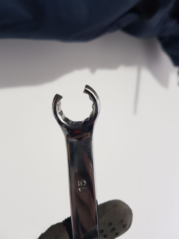

    The driver's door in golf V hung up, I read that the eccentric mandrel is adjusted with a 15 key, unfortunately the key is too wide and cannot be maneuvered. Anyone got a patent for this?

    macoss wrote:
    Unfortunately, the key is too wide and cannot be maneuvered.
    Change the key to another one.
    Did you unscrew the counter screw from below?
  • #3 17125520
    macoss
    Posts: 29
    I unscrewed, unfortunately none approaches, too little space.

  • #6 17130532
    macoss
    Posts: 29
    Below is a photo of the necessary key to make yourself. The adjustment is in a very narrow range, virtually less than the rotation of the stem. The door falls down automatically and the spindle rotates, so after turning it it is necessary to hold it with the key and lock from the bottom with the nut.
