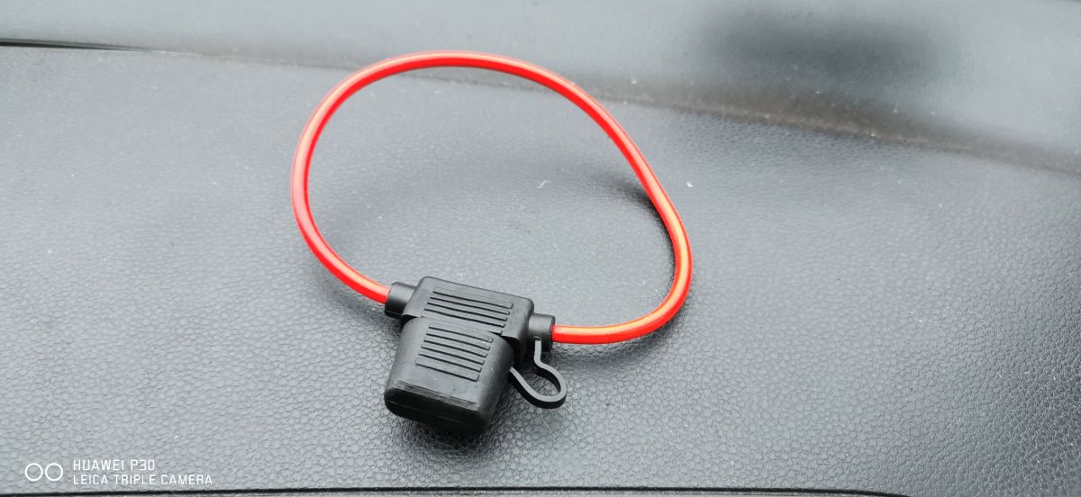

    #14 19354832
    hugo_boss86
    Posts: 21
    Gentlemen, I have to connect to the topic because the problem seems to be the same
    I also have an Ibiza 2Fl 1.9 and I put photos on the same problem. The only thing that melts the fuse on my bypass because someone previously melted the m socket, is it worth installing a new bypass (also already melted) or give it to an electrician right away? I have different experiences with handymen, unfortunately, hence I prefer to ask here first
    I bought a new single fuse socket looks solid what do you think?

  • #15 19355024
    jdubowski
    Tube devices specialist
    Posts: 21595
    Help: 2511
    Rate: 2804
    What is the cross-section of this cable? 1mm2 or more?
