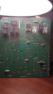

    Renault Clio III: Dipped Beam Headlights Malfunction - Relay Connection and BSM Box Diagram
    Today I desoldered the BSM. I was expecting a burned path, but to my eyes everything seems to be ok. If you can, Colleagues, look at the attached photo and judge if there is anything suspicious, then I will be very grateful.

    I understand that no one is sure of the efficiency or defects of this plate?

    Since you've found the relay, pick it up and extract the signals from its guts.

  • Low BSM relay drive voltage measured at 7.81 V
    #10 21694081
    Greechu
    I'm linking to the topic, I have an identical situation - no low beam. I checked everything, got to the BSM module, or whatever it's called, and found that the problem with me is exactly that after switching on the lights on the relay in the BSM should be given a signal of 12 V to one control pin, and from what I measured with a multimeter, it gives me about 7.81 V there, and with such a low voltage the relay does not want to excite. I further confirmed this by checking the excitation threshold of this relay on the table using a lab power supply. Maybe someone could help which component is responsible for this voltage, as I'm betting it's some component on the board that's messed up, as I haven't found any burnt tracks or cold solders. Help!
