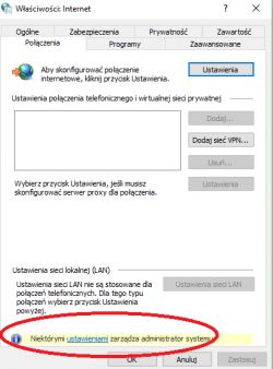

    Hello, today I decided to scan the computer with the program malwarebytes and adwcleaner, after resetting the computer in my browser which I use (opera) a popup pops up for me: "Some settings are managed by the system administrator" - How to fix
    However, when I want to change the proxy settings, this window pops up: "Some settings are managed by the system administrator" - How to fix
    I am currently using mozilla firefox, in the settings I turned off the proxy and it works, if not for the fact that I can not get on steam, origina and many other programs I need, everything is okay
    Scans from FRST are in the attachment, best regards

    yes, these settings do not know why they do not save me, disable the proxy and after re-entering this tab is still enabled

    I am logged in with an administrator account and I still don't get it, even if I'm not a new account

    Create a fixlist.txt file in the same folder where you have FRST, the contents of this file:
    HKLM\SOFTWARE\Policies\Microsoft\Windows\CurrentVersion\Internet Settings: [ProxySettingsPerUser] 0  Proxy [funkcja włączona]
    ProxyEnable: [HKLM-x32] => Proxy [funkcja włączona]
    ProxyServer: [HKLM] => http=127.0.0.1:8080;https=127.0.0.1:8080
    ProxyServer: [HKLM-x32] => http=127.0.0.1:8080;https=127.0.0.1:8080
    AutoConfigURL: [HKLM] => http=127.0.0.1:8080;https=127.0.0.1:8080
    ProxyEnable: [S-1-5-21-325949023-218170836-3068464474-1001] => Proxy [funkcja włączona]
    ProxyServer: [S-1-5-21-325949023-218170836-3068464474-1001] => http=127.0.0.1:8080;https=127.0.0.1:8080
    ManualProxies: 1http=127.0.0.1:8080;https=127.0.0.1:8080
    HKLM\SOFTWARE\Policies\Microsoft\Internet Explorer: Ograniczenia  DefaultScope {0633EE93-D776-472f-A0FF-E1416B8B2E3A} URL =
    FF NetworkProxy: Mozilla\Firefox\Profiles\526l1755.default -> type", 0
    AlternateDataStreams: C:\ProgramData:NT [40]
    AlternateDataStreams: C:\ProgramData:NT2 [432]
    AlternateDataStreams: C:\Users\All Users:NT [40]
    AlternateDataStreams: C:\Users\All Users:NT2 [432]
    AlternateDataStreams: C:\ProgramData\Dane aplikacji:NT [40]
    AlternateDataStreams: C:\ProgramData\Dane aplikacji:NT2 [432]
    AlternateDataStreams: C:\ProgramData\MTA San Andreas All:NT [40]
    AlternateDataStreams: C:\ProgramData\MTA San Andreas All:NT2 [432]
    AlternateDataStreams: C:\Users\holci\Dane aplikacji:NT [40]
    AlternateDataStreams: C:\Users\holci\Dane aplikacji:NT2 [432]
    AlternateDataStreams: C:\Users\holci\AppData\Roaming:NT [40]
    AlternateDataStreams: C:\Users\holci\AppData\Roaming:NT2 [432]
    AlternateDataStreams: C:\Users\Public\AppData:CSM [470]
    RemoveProxy:
    Run FRST, press the repair button. After repairing and restarting your computer, check if something has changed.
    Are you using a VPN application that is installed (ExpressVPN)? If not, you can remove it before performing the repair, VPN applications have the ability to change network connection settings, so incorrectly configured can cause problems.

    From time to time I have to use it only to hide my ip on teamspeak 3 messenger, now everything works, the problem I think is solved so I close the topic
    I did as the moderator wrote under the nickname "dt1", best regards.
