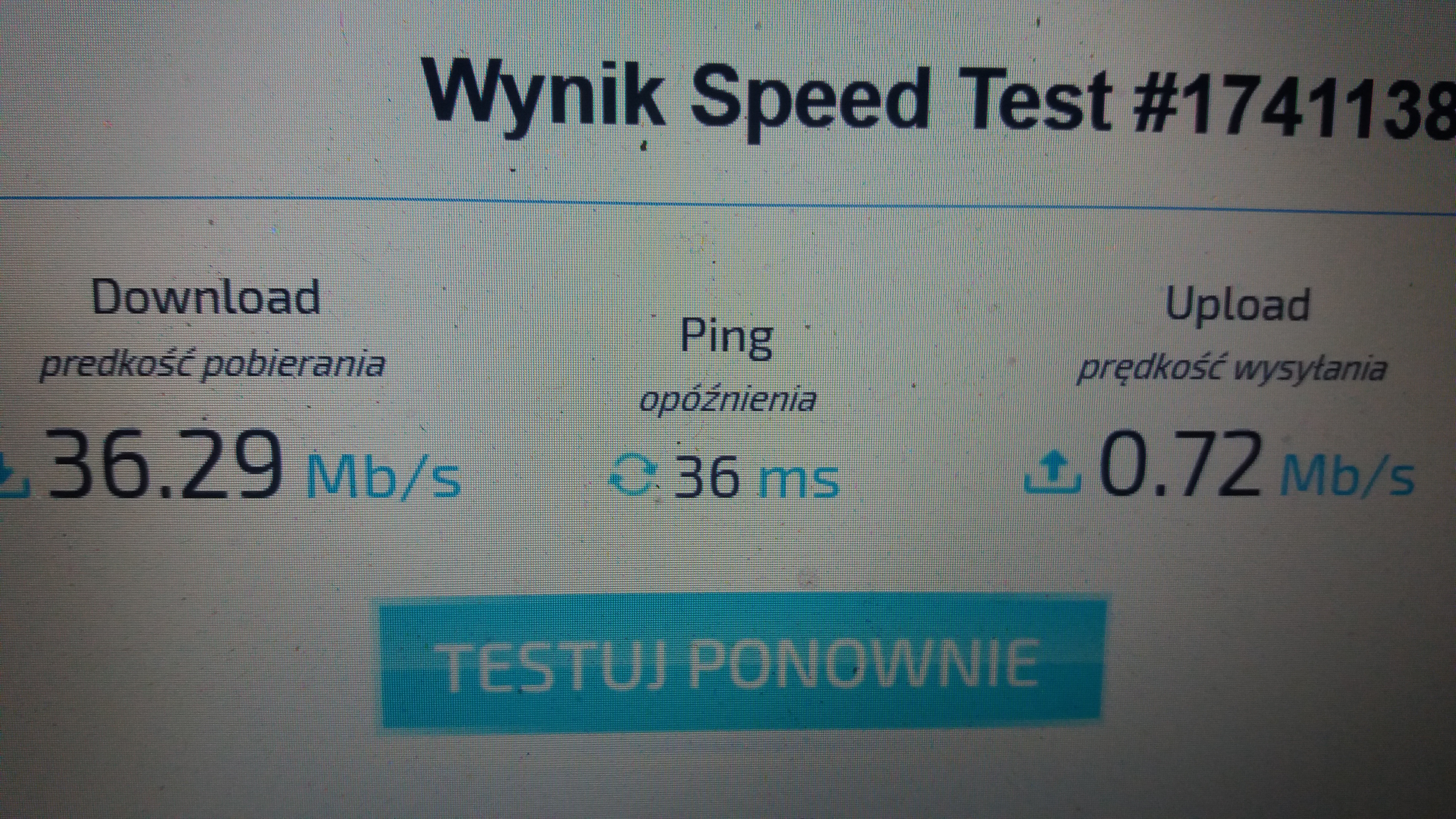

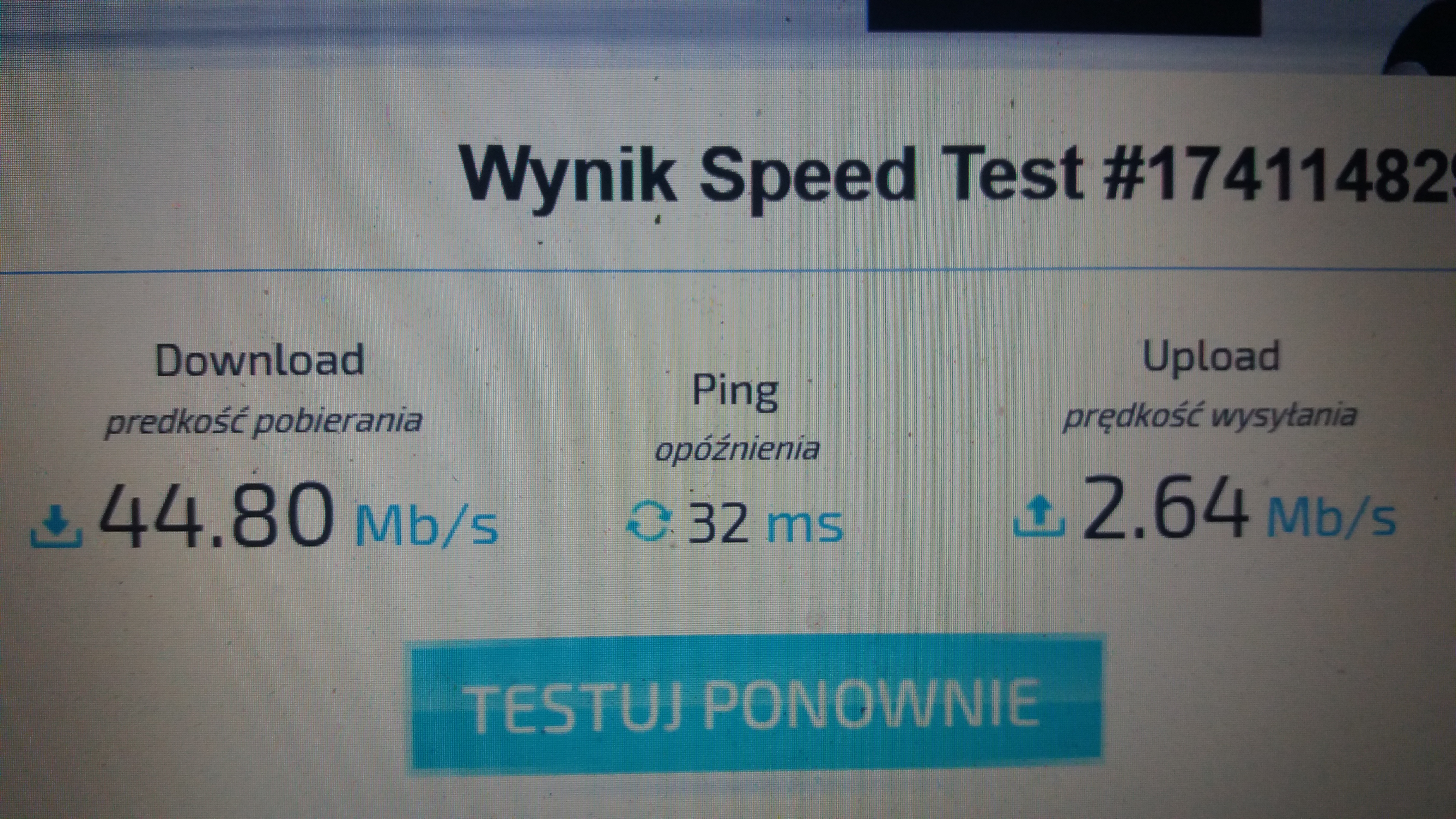

    Xiaomi Mi A1: No LTE/4G Coverage issue, Allegro Purchase, Compare with Samsung J5 2015, B20-B7 Xiaomi Mi A1: No LTE/4G Coverage issue, Allegro Purchase, Compare with Samsung J5 2015, B20-B7
    1.Samsung J5
    2.Xiaomi

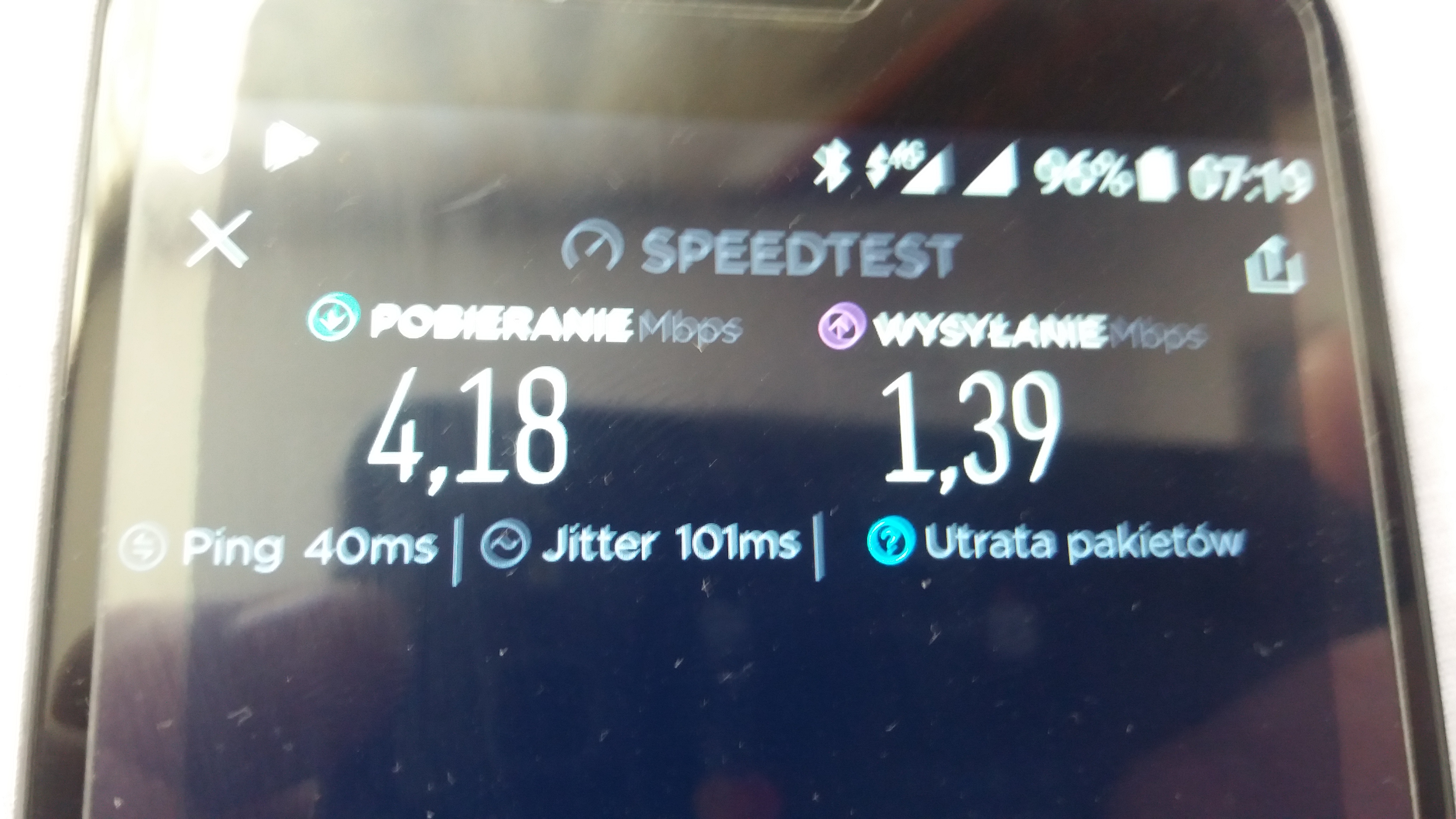

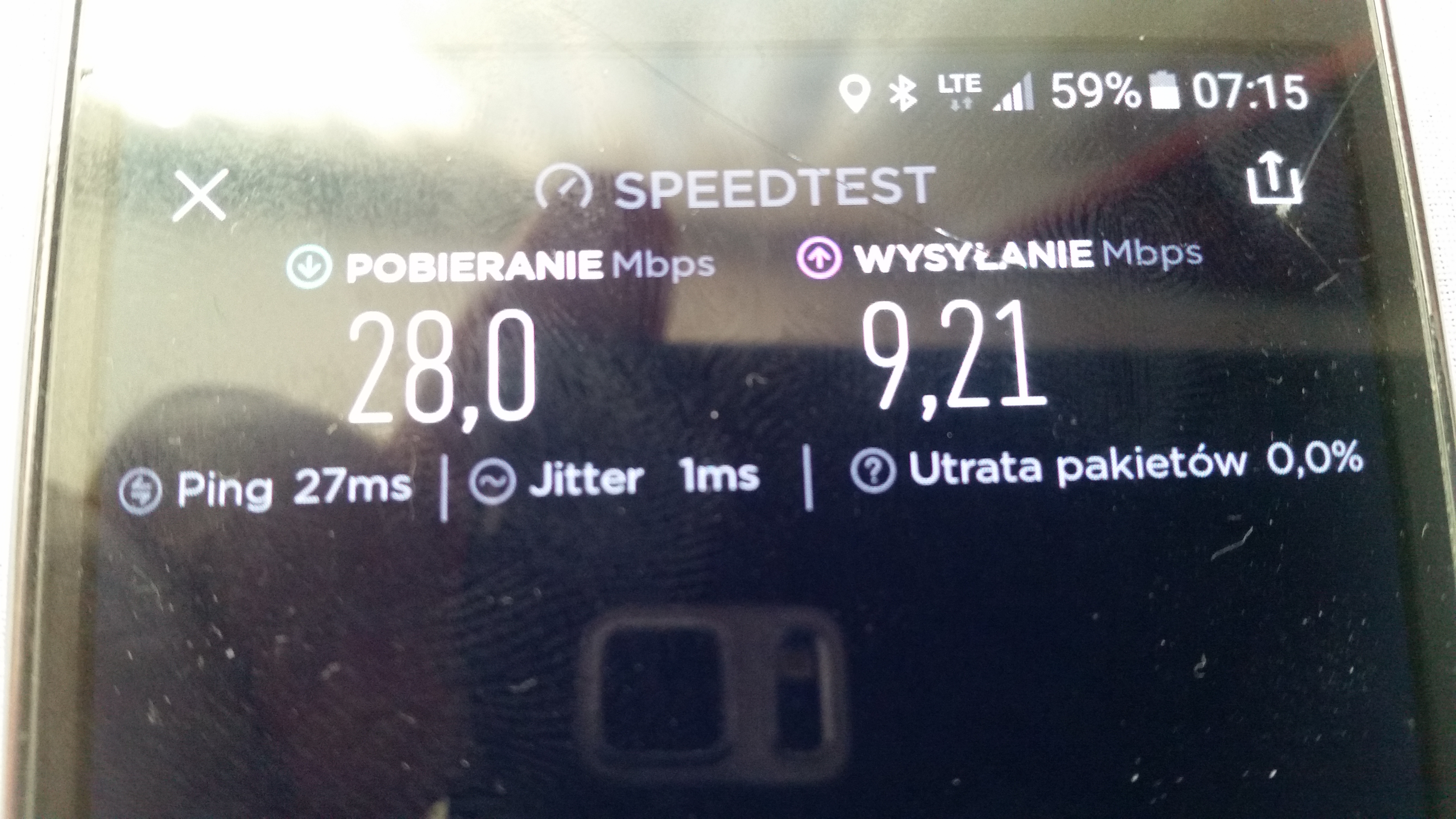

    1.Xiaomi.Here the case looks so great that speed is crazy, it jumps once so once so, and in j5 everything works steadily.
    2.Samsung J5
    • Xiaomi Mi A1: No LTE/4G Coverage issue, Allegro Purchase, Compare with Samsung J5 2015, B20-B7 Xiaomi.jpg (2.28 MB) You must be logged in to download this attachment.
    • Xiaomi Mi A1: No LTE/4G Coverage issue, Allegro Purchase, Compare with Samsung J5 2015, B20-B7 Samsung J5.jpg (3.98 MB) You must be logged in to download this attachment.

    what frequencies does xiaomi catch and what kind of j5?
  • #13 17145566
    darek2341
    Posts: 223
    Rate: 39
    Hello, the servers shows the same, all the time I'm sending 0. A download jumps from 15 to even 56, something is wrong.
  • #14 17147141
    Ordine
    Level 25  
    Posts: 807
    Help: 75
    Rate: 164
    15 and 56 what? kbps, mbps? I made a glass ball ...

    So I checked, the worst thing is with sending, downloading still in measure. And as I put the sim card into j5 it goes smoothly everywhere, and xiaomi once goes as far as it then starts to silt up.

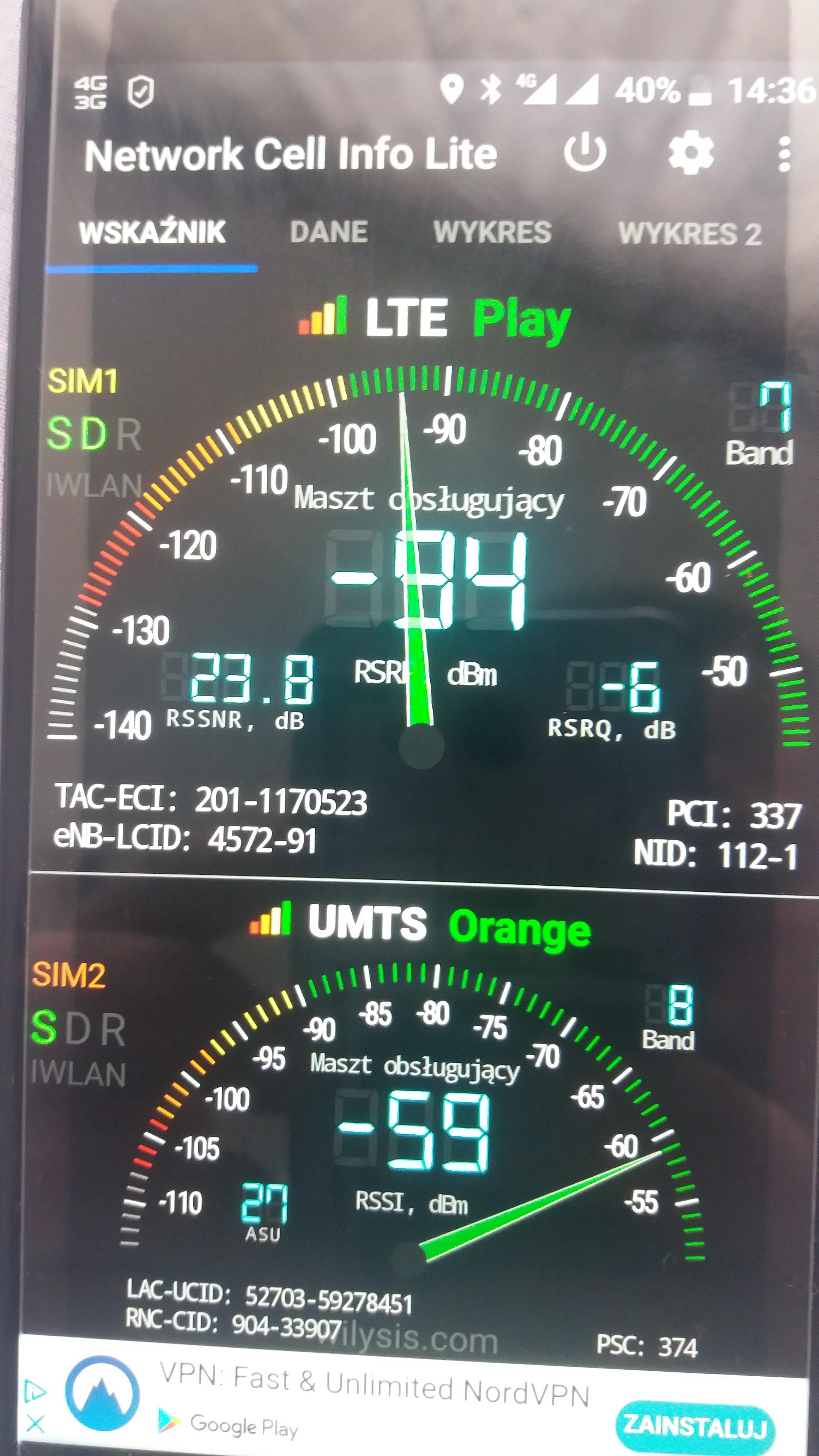

    Show Network Cell Info from the same place where Xiaomi works so poorly.
    And I will repeat it again just in case 4G = LTE

    Wines on the operator's side. Thank you to everyone. I greet you
