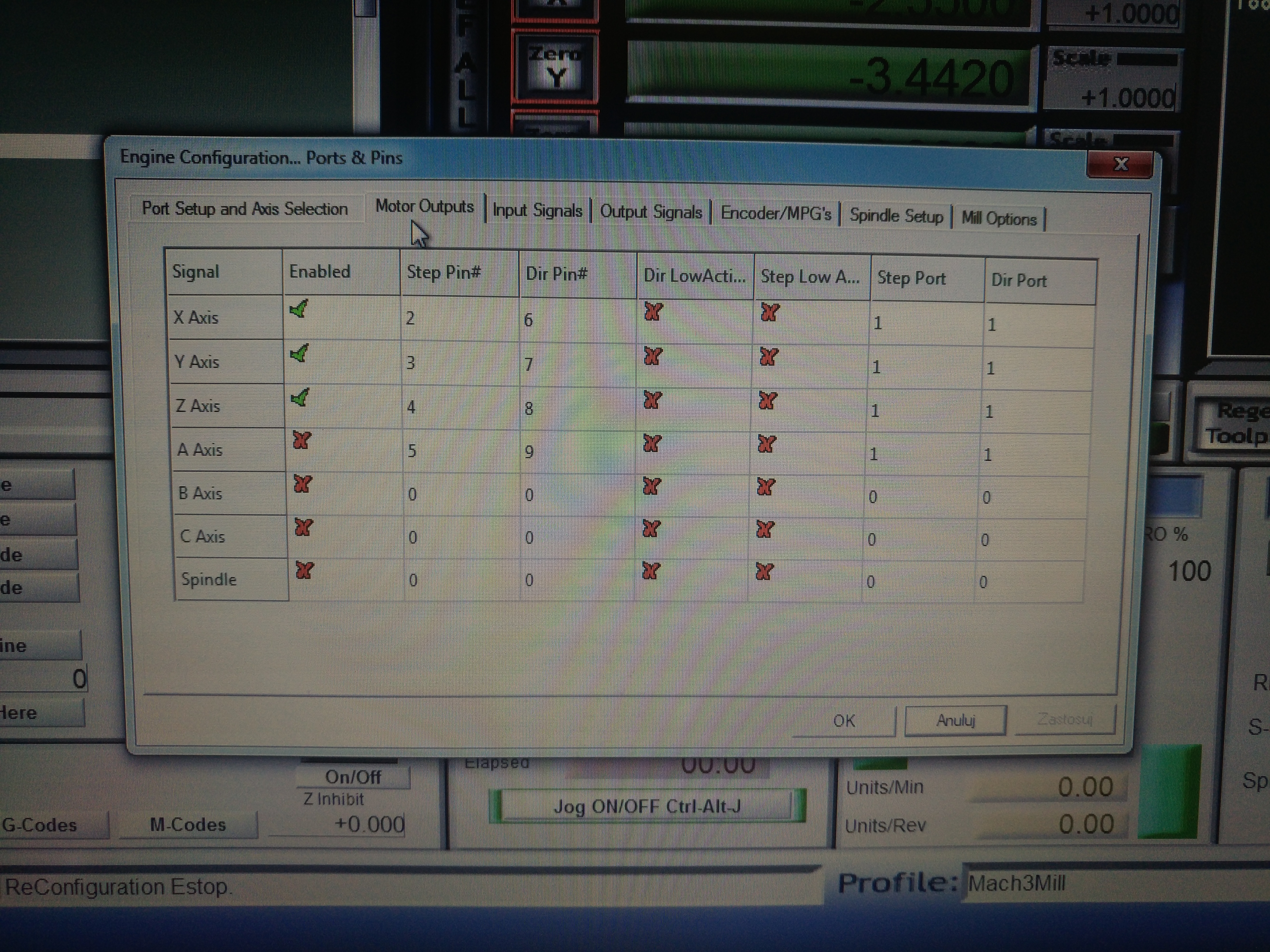

    Hello everyone, I need help starting the machine that is supposed to work on such a board: 4 Axes Mach3 USB Operation Problem: Setting up Pins, Limit Switches & Port Configurations along with mach3
    But I don't really know how to set it up, namely I was browsing various YouTube videos and I tried to set the pins like there but the board still does not work, maybe some of you have one and can help? The case is that the engine is spinning if I control it myself, but I have no idea how to set the limit switches to what pins and mach according to them does not see all ports according to no candle and automatic search does not work 4 Axes Mach3 USB Operation Problem: Setting up Pins, Limit Switches & Port ConfigurationsIMG_201803...640[1].jpg (5.63 MB)You must be logged in to download this attachment. 4 Axes Mach3 USB Operation Problem: Setting up Pins, Limit Switches & Port ConfigurationsIMG_201803...558[1].jpg (9.03 MB)You must be logged in to download this attachment.
    or maybe one of you has a list of pins on this board because it would also help a lot

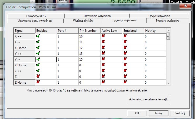

    I connected exactly as in the 12V diagram but I am not sure what pins to enter in the machu because I do not have any schedule and I did not find on the Internet either

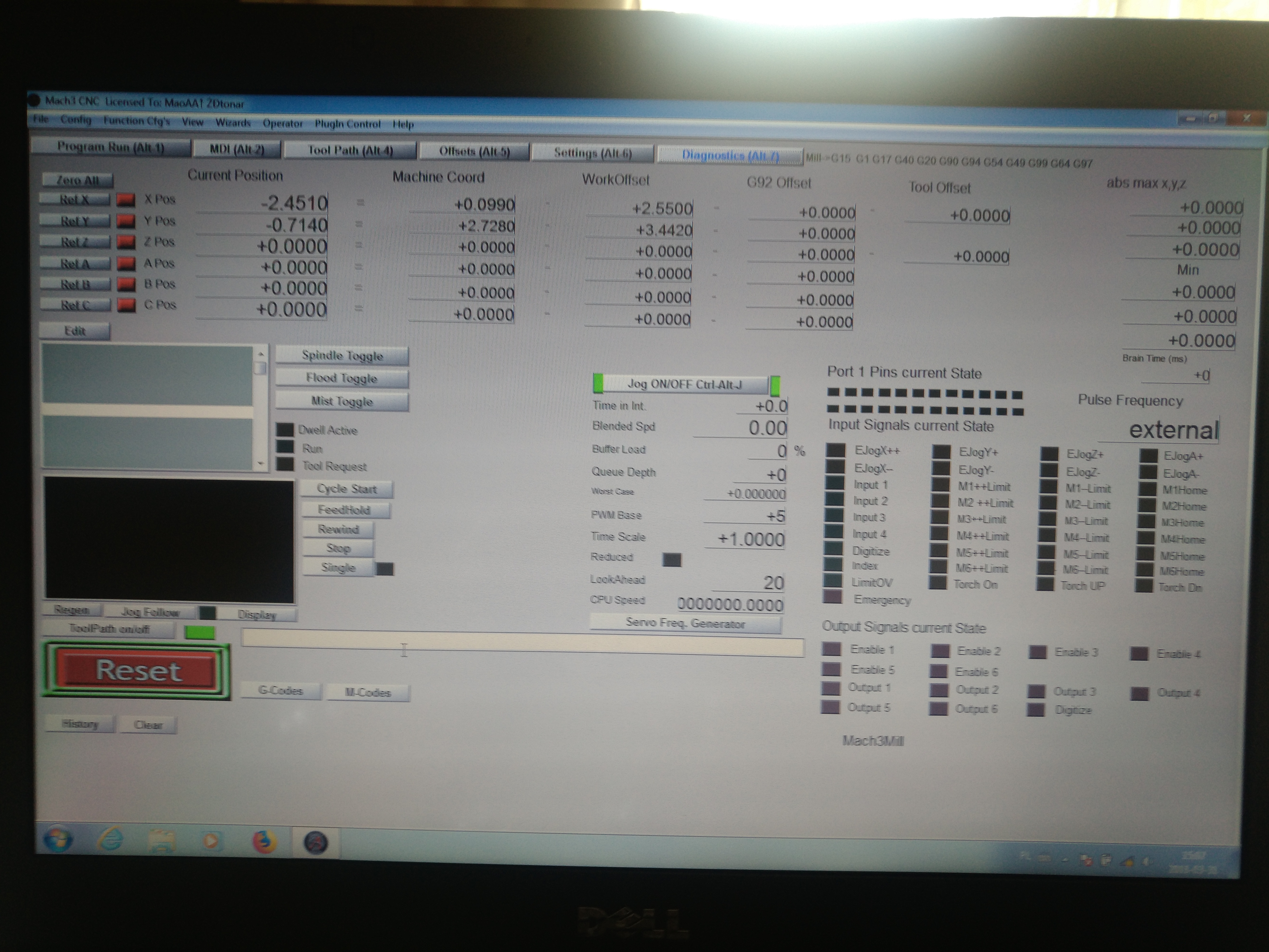

    Only those described in the picture can be used as inputs.
    After that, go to the "DIAGNOSTICS" tab and pass "-" to the IN inputs, you will see which ones light up.
    In the first post you are in the output signals tab, not the input signals.

    Thank you very much for your help, the limit switches are already working and thanks to this way I checked with this minus and I was able to correctly set the pins so that it started to work properly
    Thanks again for your help

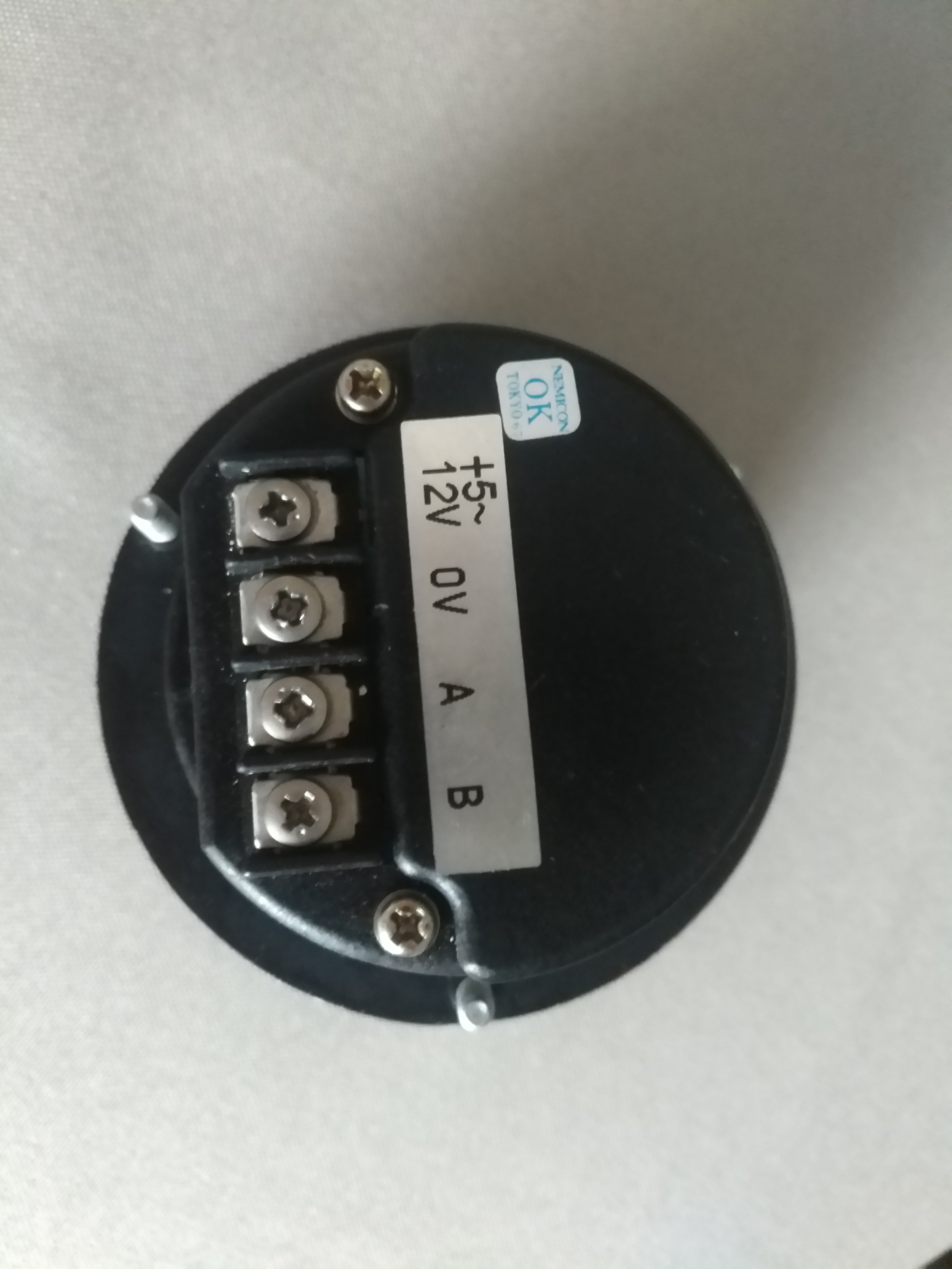

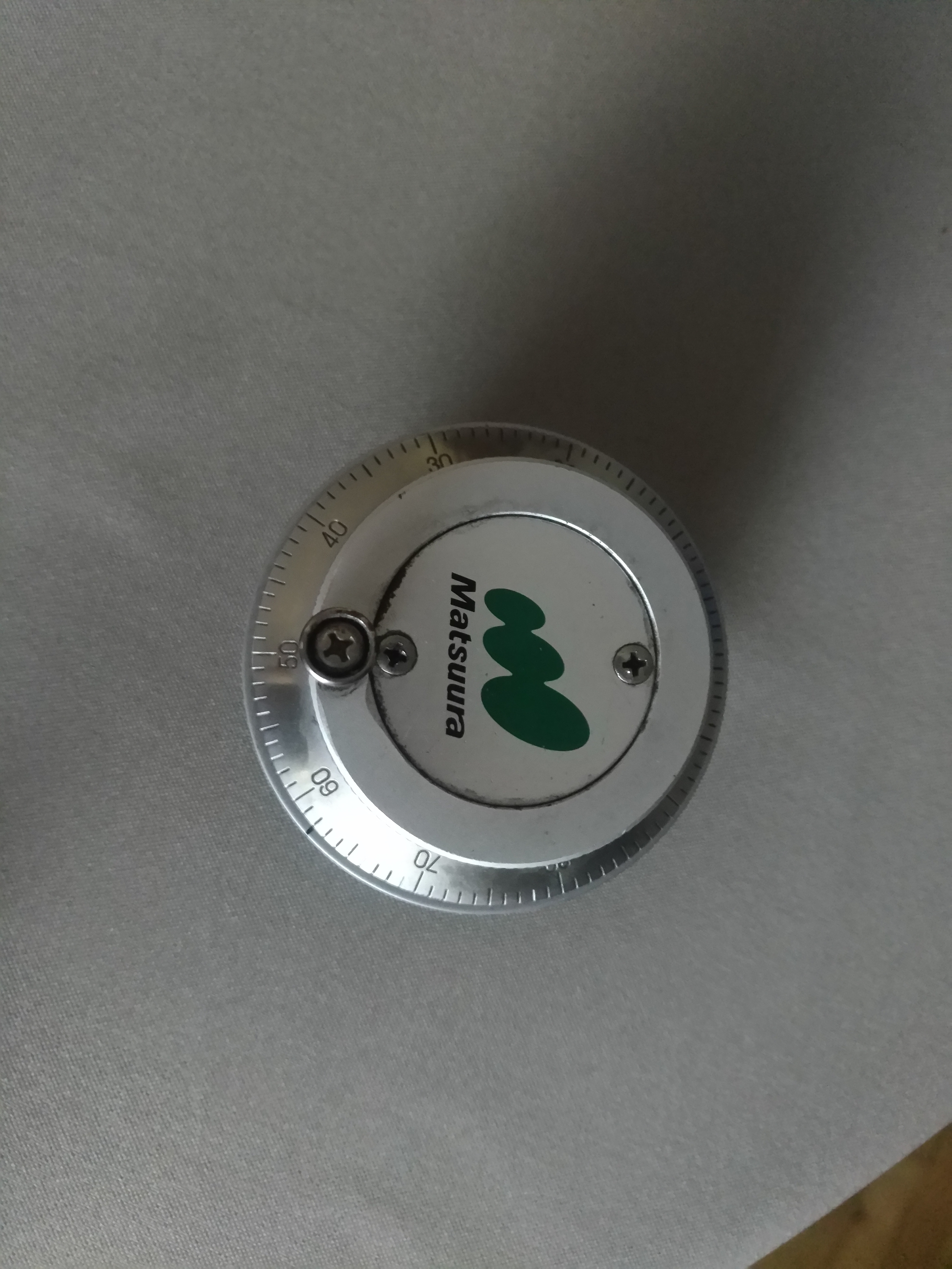

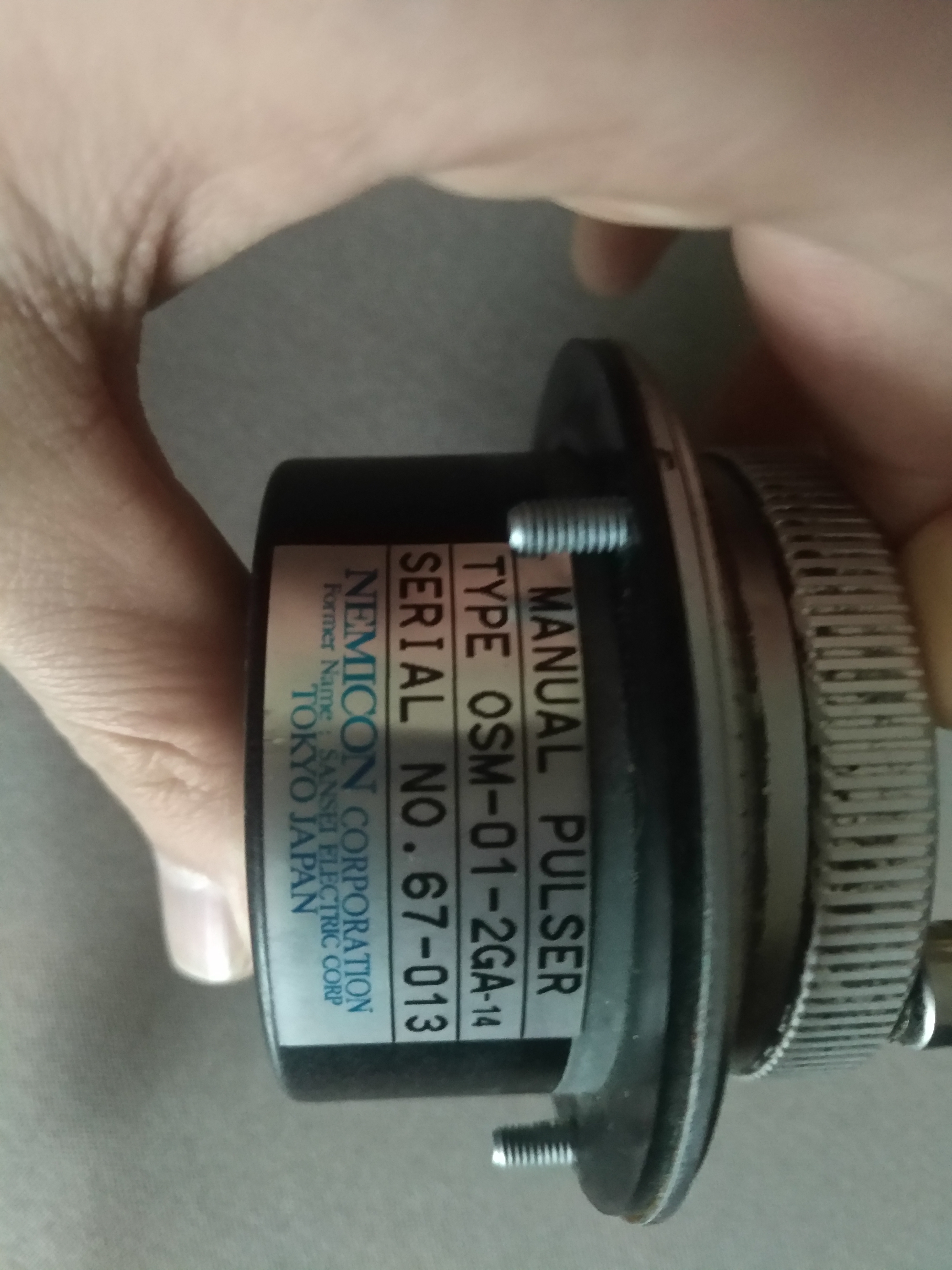

    I haven't finished well yet and I remembered already because I have a "wheel" for manual control 4 Axes Mach3 USB Operation Problem: Setting up Pins, Limit Switches & Port Configurations 4 Axes Mach3 USB Operation Problem: Setting up Pins, Limit Switches & Port Configurations
    But I have no idea how or where to connect it and how to set it up
