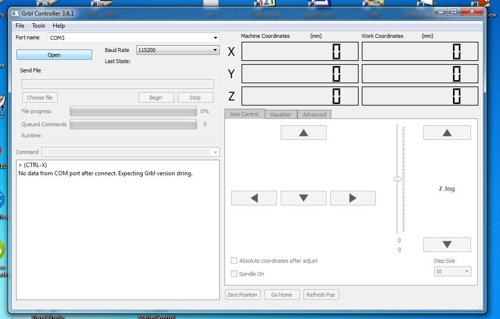

    Added after 9 [hours] 18 [minutes]:
    After uploading the UNO version to MEGA grbl 1.1h in the GRBL Controller, I receive the message as in the attached scan:

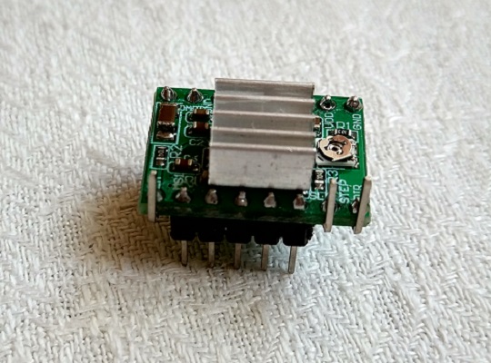

    I changed the connections of the STEP and DIR pins of individual A4988 stepsticks and the ENABLE pin accordingly (as shown above).
    I "prepared" stepstcki A4988 as in Photo_1. In Photo-2 I present test connections for two axes (X and Z).

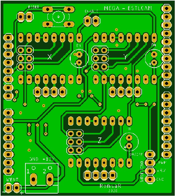

    After a long break, I`m back to the topic.
    I designed my own "shield" and ordered the board to be made from the Chinese. After a month of waiting, I received the ordered tiles. I soldered the elements and the tests were positive. I only have one doubt. Well, it turned out that the Mega 2560 with the Estlcam software loaded does not provide the "Stepper Enable/Disable" signal, which in the case of the GRBL software loaded is on pin 13. In this situation, the ENABLE pin of the A4988 controller will "hang in the air" (it will be on all the time). forced low level) and the engine will be powered all the time, which will result in greater heating of the controller and the engine. There will be the so-called holding moment.
    And here I have a question for experienced colleagues. Is this solution correct?

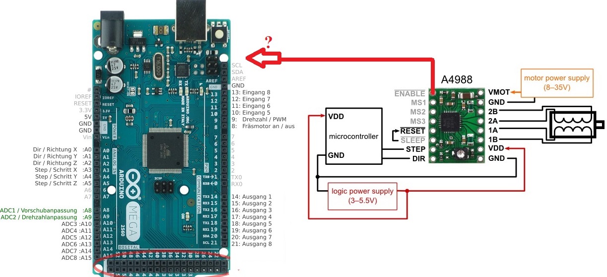

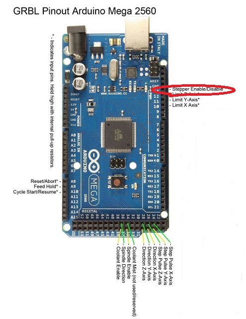

    Thanks for the information.
    As I understood, working with the lack of external connection to the EN pin is correct. Or so?
    I checked the heatsink temperature on the A4988 chip. During "standstill" the temperature was approximately 55 - 60 degrees C, during operation it reached 72 degrees C. Isn`t this too high?

    emarcus - Thank you for the very professional information. I just don`t really understand how I can use microstepping to lower the motor current using table 2 in Datasheets A4988.
    I will also check the operation of the entire system (Mega 2560 + Shield) in the designed housing, which I equipped with a 4010 12V fan.
