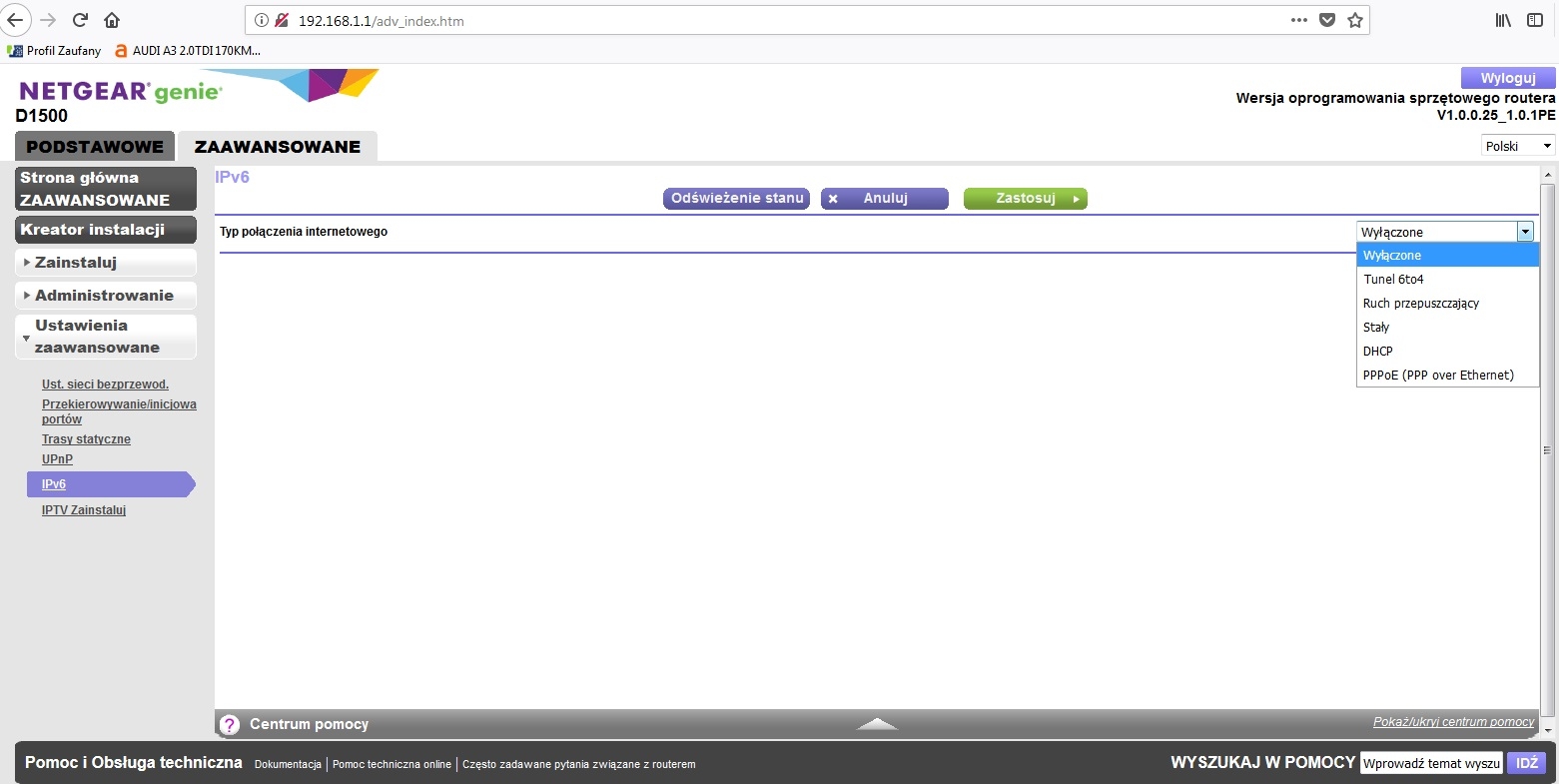

    2. IPv6
    Enable IPv6? Leave it turned off for now? If attached, which type to choose?

    2. IPv6
    Never. The problems themselves, and they do not need anything.
