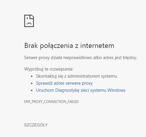

    Good morning,
    The problem is that I turned on my computer and I have wifi connection to the network and the computer is connected to the network.
    I go to the browser, enter the address and the website does not enter, but the information is:
    "No internet connection
    The proxy server is not working properly or the address is wrong "
    I tried on different browsers and with combofix. Unfortunately combofix hangs on stage 4 (I turned off the antivirus).
    I also tried unchecking in google chrome "Use a proxy server for LAN" but it still doesn't work.

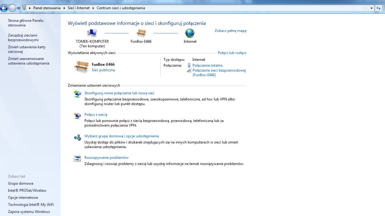

    Show me the screen of the control panel - network settings.
  • #9 17145259
    TomekTom5000
    Posts: 11
    Rate: 9
    The first screen with wifi only the second one with a cable.

    And on Wi-Fi and on a LAN cable connection, the Internet is on. From what I can see here.

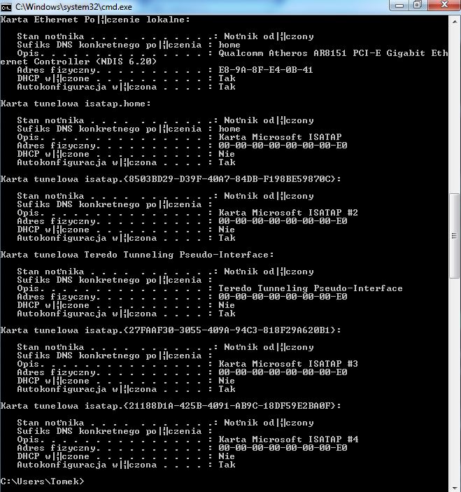

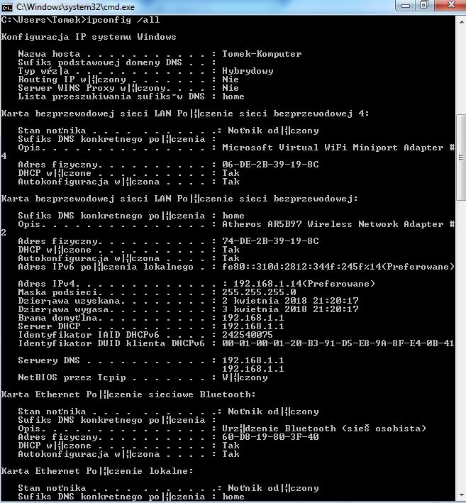

    Added after 19 [minutes]:
    I'm pasting 2 screenshots of cmd with the ipconfig / all command. I don't know if this will help.
    • The websites are not working. The laptop is connected to a WIFI network. ipconfig all 2.JPG (108.75 KB) You must be logged in to download this attachment.
    • The websites are not working. The laptop is connected to a WIFI network. ipconfig all 1.JPG (116.15 KB) You must be logged in to download this attachment.

    Why is there a public network set up there? - there should be a home network.
