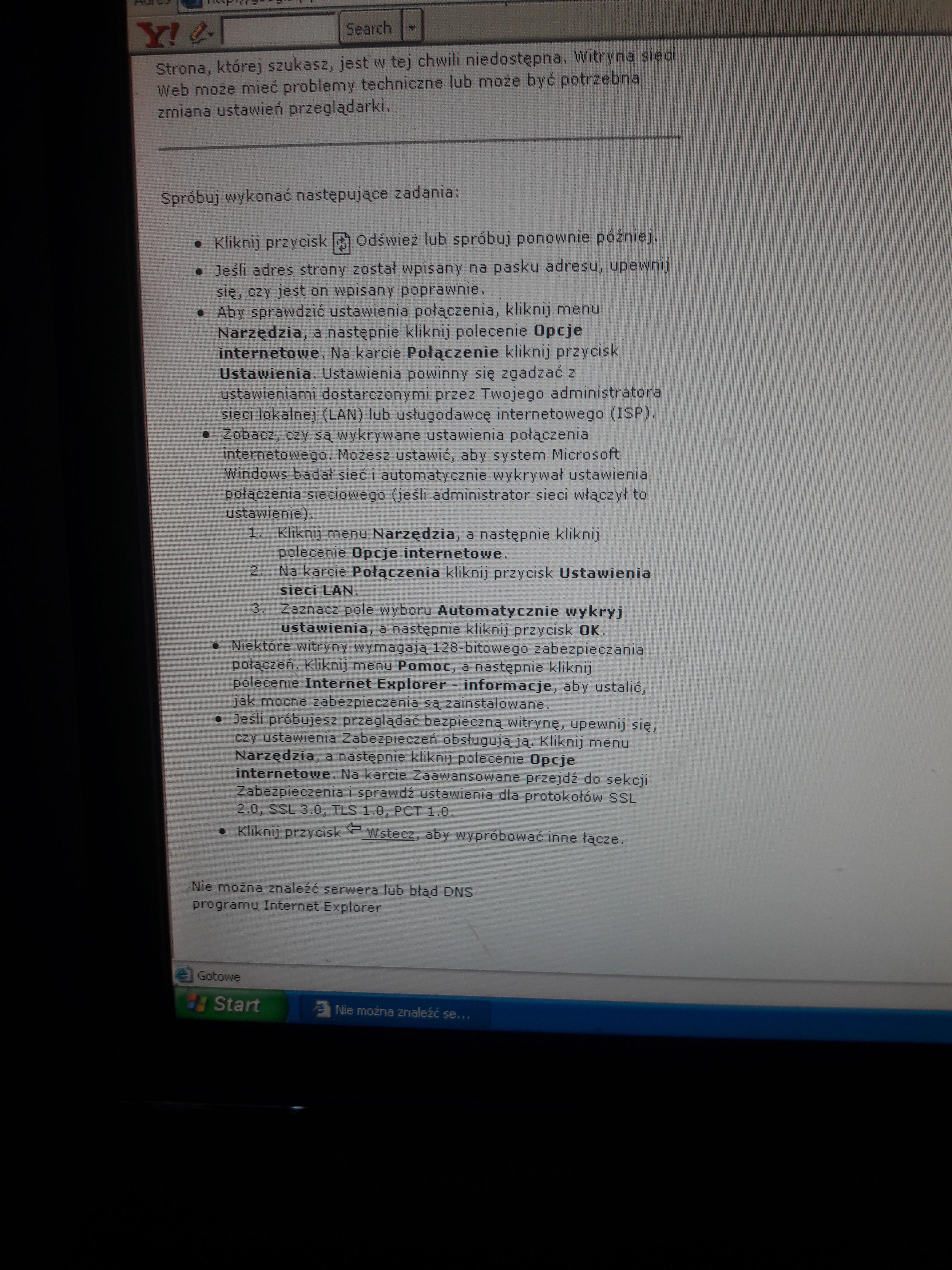

    Hello . As in topic, I have a problem with the Internet. After formatting the system and installing the drivers, my browser doesn't work. But the driver supplement program normally received internet access. What to do with this ? Already tried to change dnsy and set automatic but it did not help. I have automatic LAN settings without using a proxy and it doesn't work either.
    • Internet Issues Post-System Format: Browser Inaccessibility Despite Successful Driver Installation 15200009118411093395335.jpg (1.74 MB) You must be logged in to download this attachment.

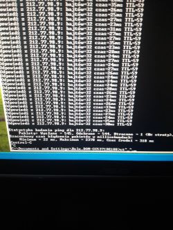

    Check the date on your computer.
    check ping to server: run -> CMD -> ping www.wp.pl -t
  • #3 17074952
    Buuumbolok
    Posts: 16
    the date is correct.
    Ping;

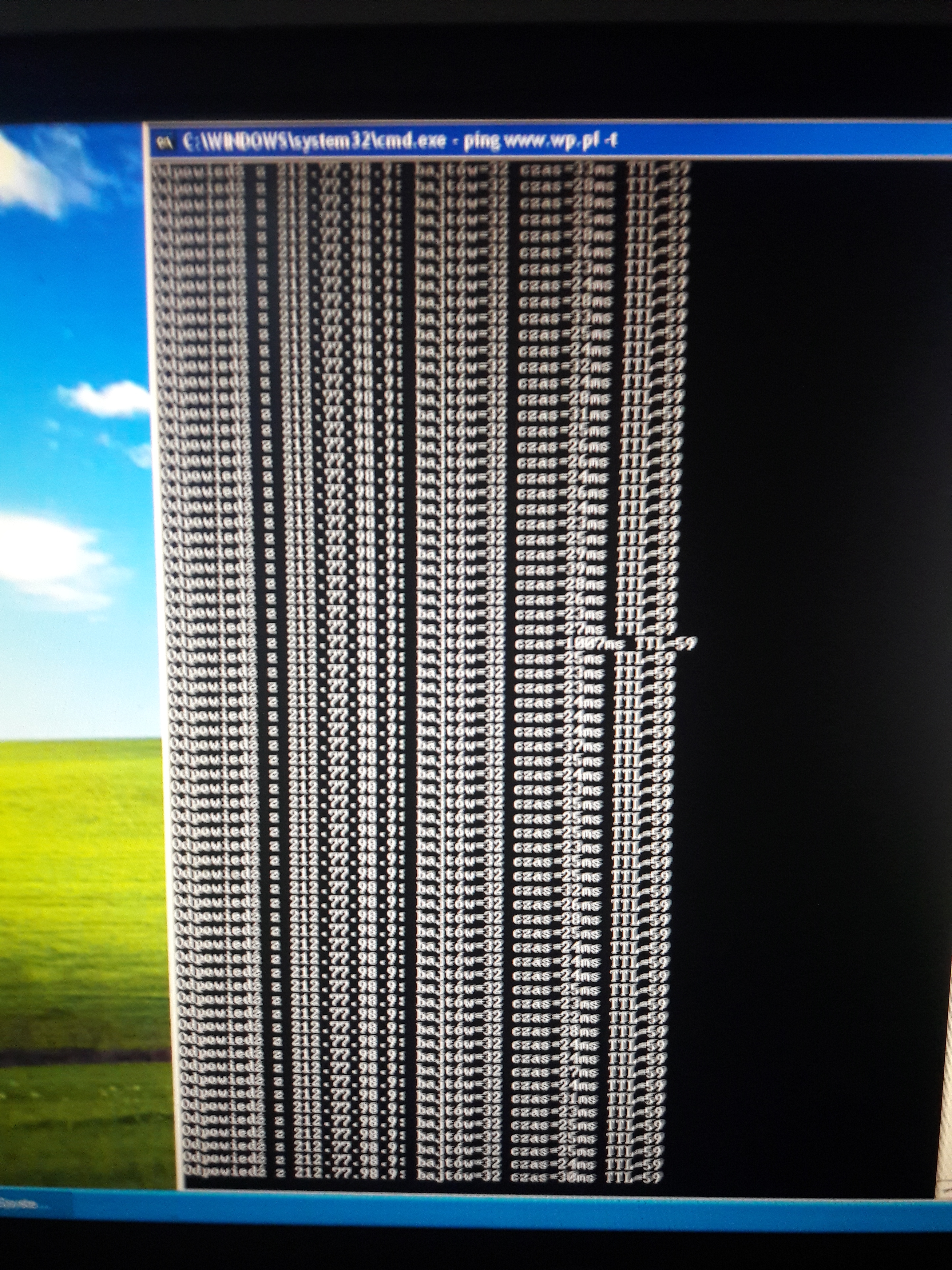

    You forgot to add at the end: "- t"
    To exit it press Ctrl-C
  • #5 17074967
    Buuumbolok
    Posts: 16
    I added -t and it has been going like this for 5min Internet Issues Post-System Format: Browser Inaccessibility Despite Successful Driver Installation

    To exit from it press Ctrl-C.
    It looks like you have access to the network.

    What browsers have you tried out?
    What pages are you trying to access?
  • #9 17074995
    Buuumbolok
    Posts: 16
    Internet Explorer, Mozilla, Chrome. I tried various websites wp, Google, fb. And nothing works, but for a change, e.g. bing.com works.
