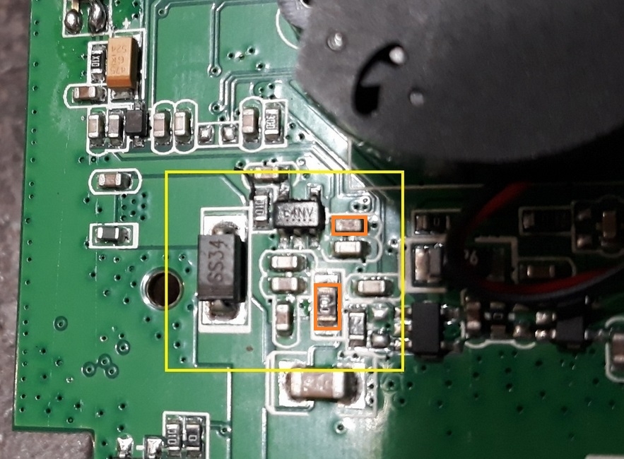

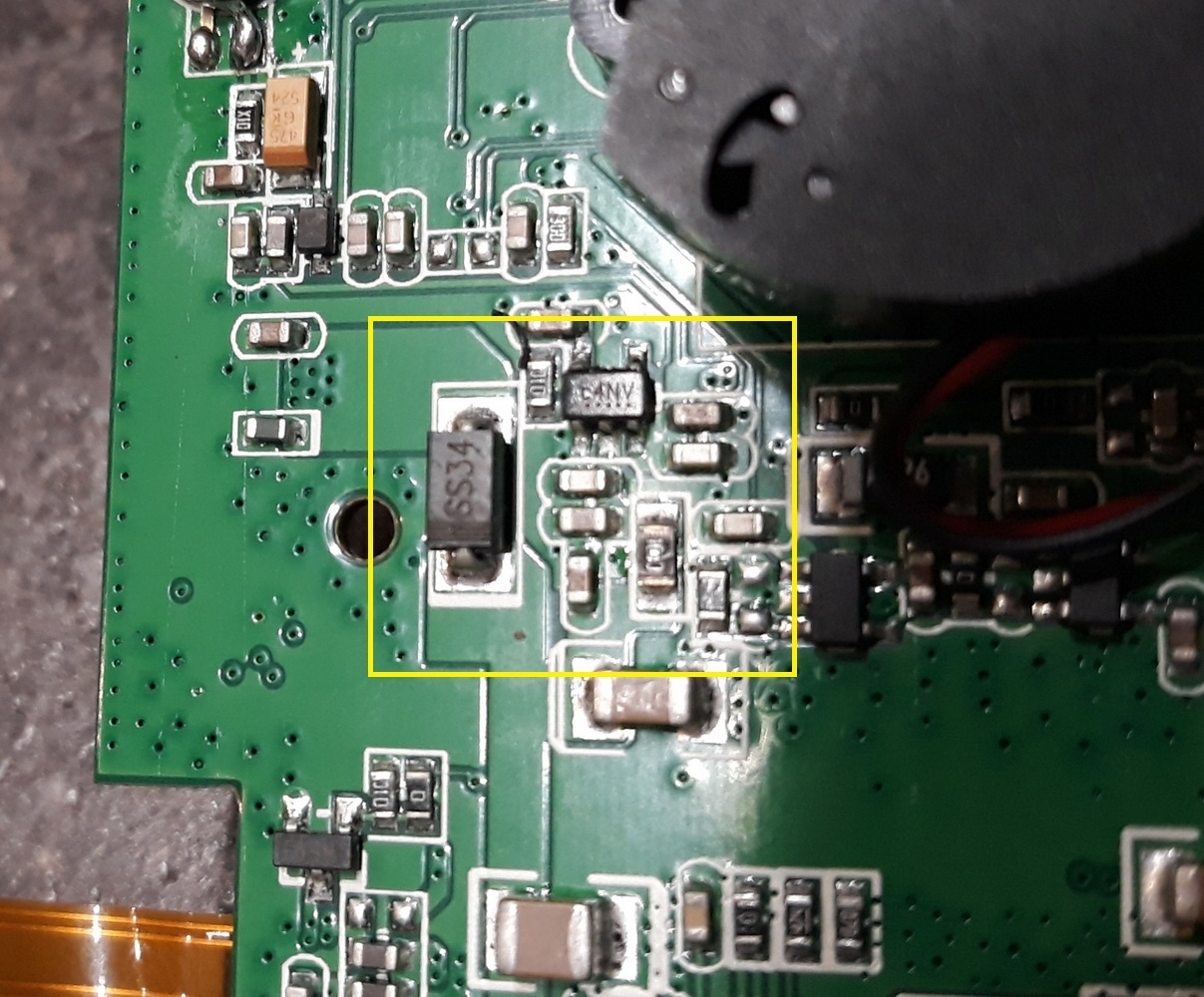

    I connected the photo-trap for the power supply with the fact that instead of under 9V it was under 19V
    Now, after inserting the battery, it does not react, I unscrew it, the board near the SS34 diode gets hot, the diode replacement did not help, it still burns the finger after touching the disc.
    Can you revive it or a basket?

    Christophorus wrote:
    The picture shows that there are at least two resistors burned (literally). More items may be damaged.
    which one ? Can it be exchanged?

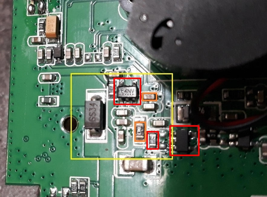

    The picture shows that it was burned (literally ) there are at least two resistors. More items may be damaged.
    are these resistors?

    Is it possible to mention it? these are very small elements ...

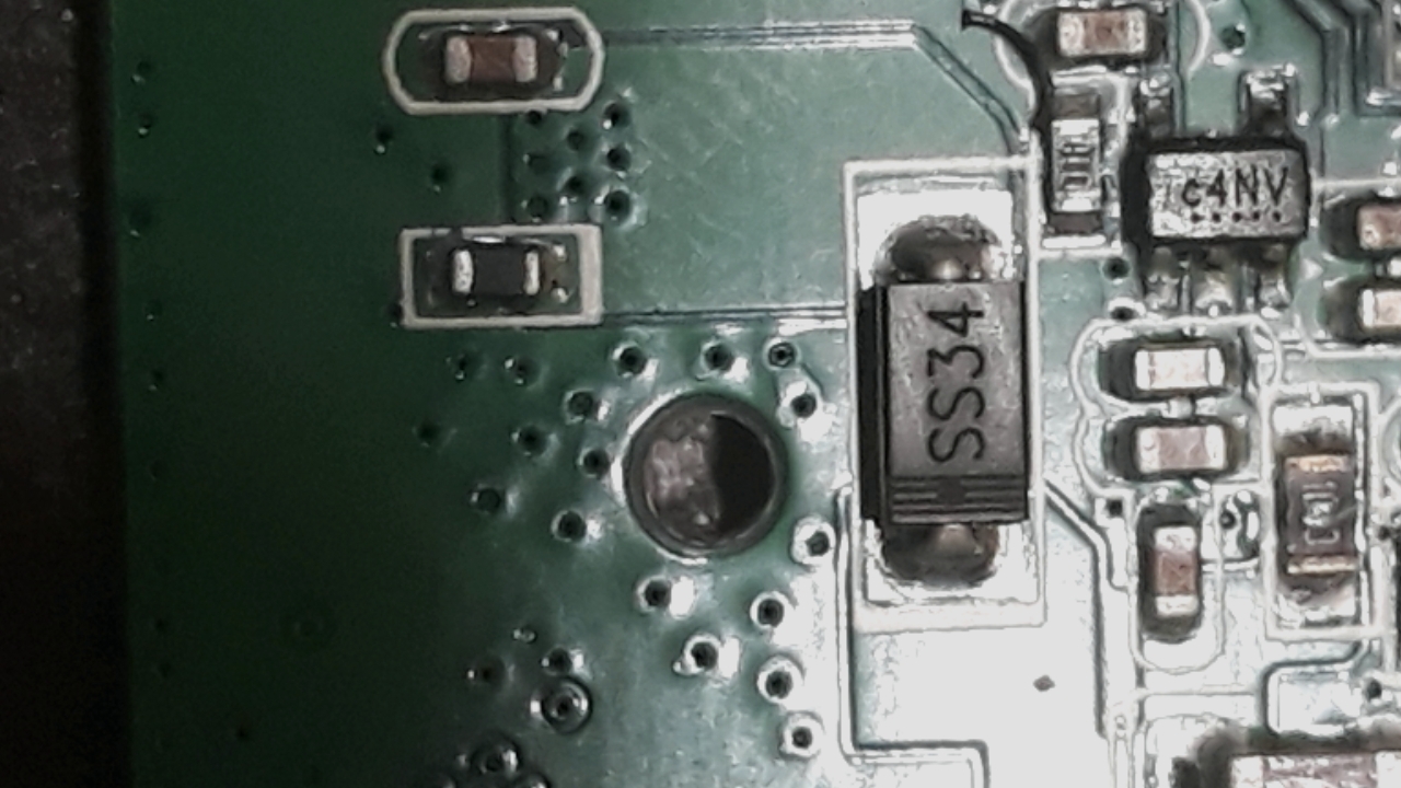

    It can be replaced by having precise tools and an experience in soldering precision elements. A bigger problem may be with the identification of damaged elements. If this C4NV system could be identified, the values of the elements cooperating with it could be identified on the basis of the application note. Unfortunately, I have not found much information about this C4NV. On the Russian-language forum I found information that this element is in a photo trap about the designation HC-550M and maybe it is a 5V voltage regulator from the series with the designation S-812C33BMC-C4NT2x.
    Yes, my model trap is HC350M so probably everything is the same as the HC550M
    The input via the power supply is 9V
    It seems to me that the skin is not worth a layette? What do you think ?
    19V input likely damaged the S-812C regulator
    This S-812C regulator can withstand a maximum of 16V on input, so the 19V which "got" probably damaged it. Digit 33 in the S-812C designation 33 The BMC-C4NT2x can indicate 3.3V output voltage. I found the regulator at a price of 0.84 euros plus shipping. Perhaps it could be replaced by another regulator. It is also unclear whether this second similar item which I marked in the picture in post # 4 is not damaged. The value of the damaged components of the power circuits themselves may be several (PLN), unless the processor has been damaged.
