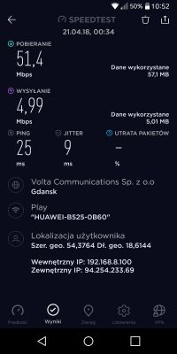

    Yesterday I purchased the huawei b525 modem for the Play card and after the tests I get the best speeds with the 1800 + 2600 aggregation, i.e. around 50 Mbps. I do not know if it makes sense to invest in an external antenna. My location is Dąbrówka Warszawska near Radom

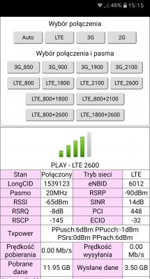

    Insert screen from LTEWatch or Huawei Manager.

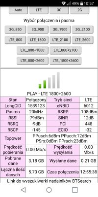

    Huawei B525 Modem: Best Antenna Connection for 1800+2600 Aggregation in Dąbrówka Warszawska, Radom Huawei B525 Modem: Best Antenna Connection for 1800+2600 Aggregation in Dąbrówka Warszawska, Radom
    Added after 11 [minutes]:
    There are some aggregation breaks and such unstable ones

    A session of 12 hours is conscious switching on / off of the equipment? Is unplanned disconnection?
    Is this measurement with the router outside, i.e. window sill, balcony, etc.?
    What distance separates you from the chimney of the heat and power plant at Żelazna? And do you see him well?
    Because with the station located there you connect (last screen).
  • #5 17180238
    jawal1980
    Posts: 13
    Rate: 7
    Modem in the window and speedtest from yesterday and screen from hmenagera from today. I do not see Bts from iron quite a large section. There is Bts in the village of Wierzbica this is closer and to this bts in Wierzbica goes radiolini with iron according to uke
  • #6 17180285
    matek451
    Posts: 31166
    Help: 4340
    Rate: 5776
    Connection to LTE2600 as a basic band from the heat plant chimney at Żelazna, during aggregation probably with LTE1800. LTE + aggregation is shown only when the connection is active. Speeds good for such poor signal parameters, UL from here so low. You need an external antenna working in the 1800-2600MHz band. You set up for Zelazna, Wierzbica and Krogulcza Sucha one by one, enforce LTE2600, LTE1800 and LTE2100 bands and LTE2600 + 1800 aggregation using HManager and choose BTS and bandwidth to give the best speed. in Play, the optimal offer is an RBM card for the 5 card from the RWK and the Free Internet LTE service with no limit on it. The cost of 5-15 PLN per month.

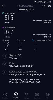

  • #15 17316752
    jawal1980
    Posts: 13
    Rate: 7
    Update after purchase and installation of the antenna.
    Antenna from cybertech 1800-2600 + 10 meters of H155 cable Huawei B525 Modem: Best Antenna Connection for 1800+2600 Aggregation in Dąbrówka Warszawska, Radom Huawei B525 Modem: Best Antenna Connection for 1800+2600 Aggregation in Dąbrówka Warszawska, Radom
    Speed test after wi-fi around 15.00 and tests on the cable give results from 90 Mbps to 120 Mbps even in the evening.
    I will add that bts is about 10 km away. I also honestly recommend the antenna and the huawei B525 router.
