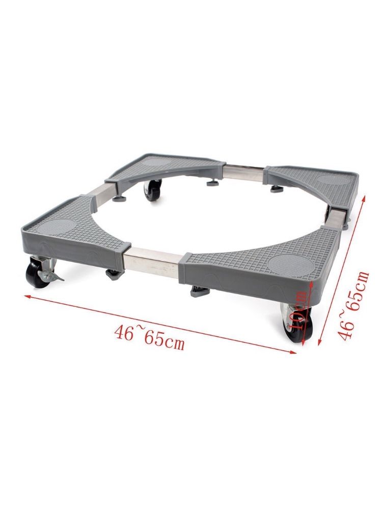

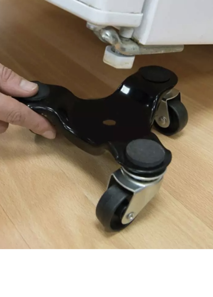

  • Clarifying faucet adapter and wheeled pallet setup
    #4 17149487
    Melaania3
    Posts: 16
    Thank you very much for your answer. My faucet looks like the first photo attached. Should I also? Such things? what you show in the picture, connect directly to the tap or unscrew the tap and confuse the valve that the pan presents then in place of the tap. When it comes to putting the washing machine down, I meant the pallet on wheels, which can be seen in the second attached photo. Thank you very much again. Regards.

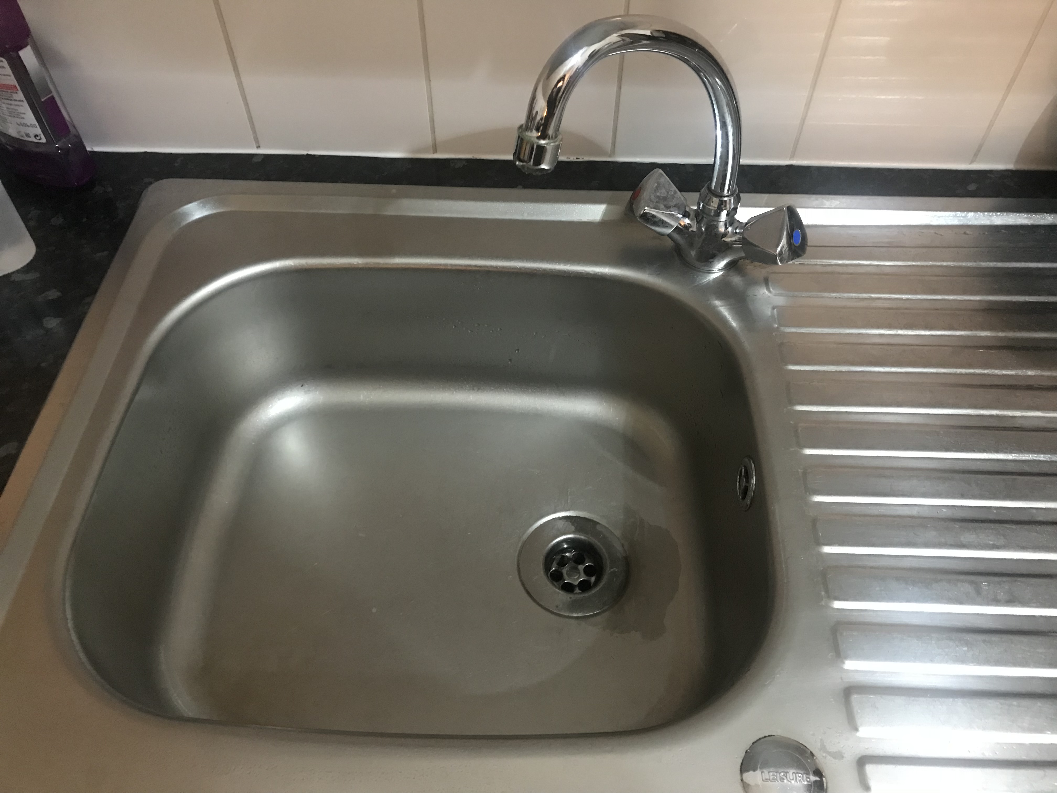

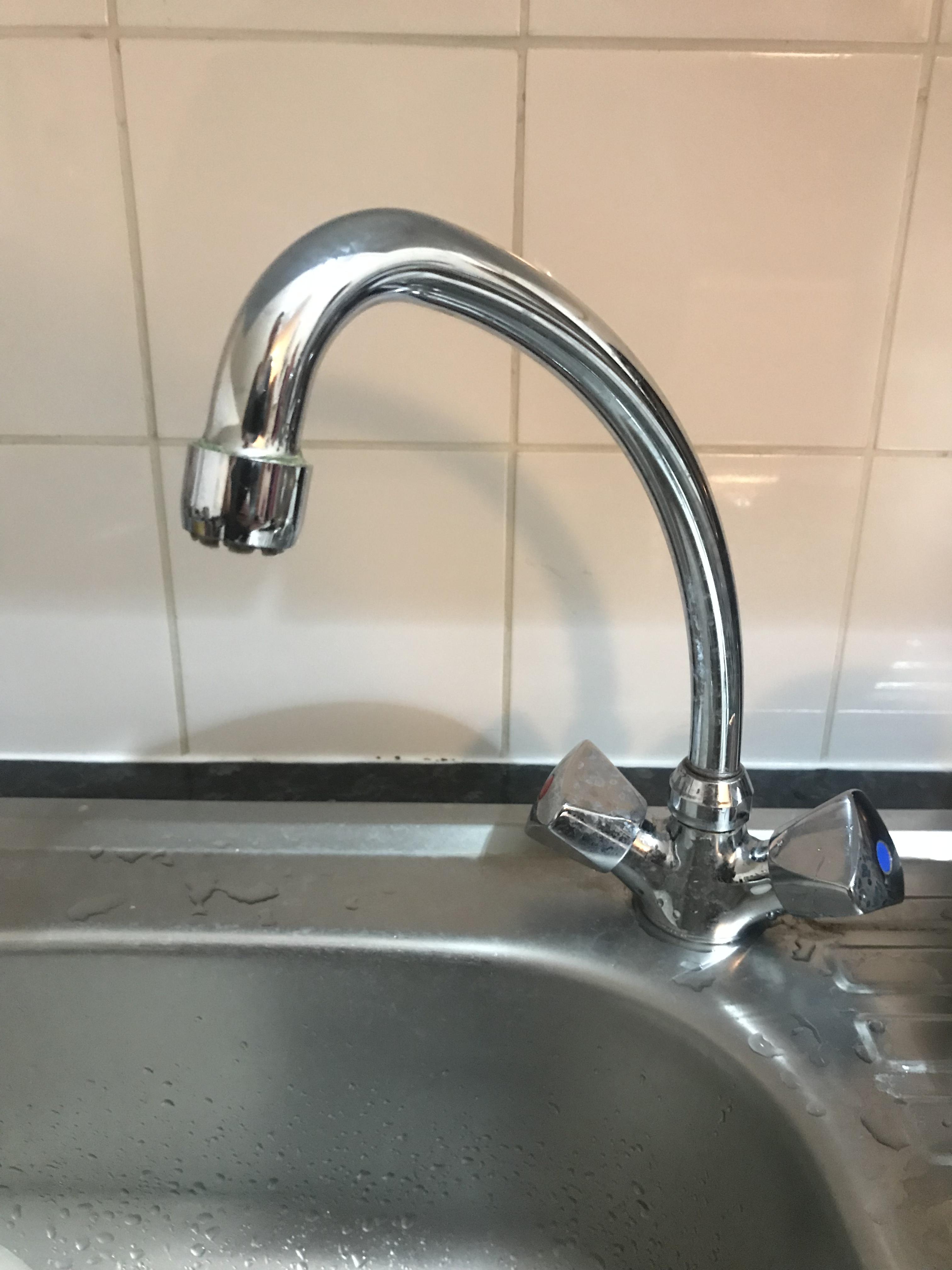

    Here is a picture of the sink and faucet
    • Connecting a Portable Washing Machine to Sink: One-Tap Hot & Cold, No Special Drain Setup E94FC134-A973-4386-86E9-4FBE55E5D6BC.jpeg (827.87 KB) You must be logged in to download this attachment.
    • Connecting a Portable Washing Machine to Sink: One-Tap Hot & Cold, No Special Drain Setup F5C80F30-9D53-43FB-971D-DC724A7FC9A3.jpeg (1.83 MB) You must be logged in to download this attachment.
  • #9 17149557
    jdubowski
    Tube devices specialist
    Posts: 21595
    Help: 2511
    Rate: 2804
    Melaania3 wrote:
    I should connect these "things" that you show in the picture directly to the tap or also unscrew the tap and matte the valve that you are presenting in place of the tap.
    No - in this case, you need to connect to the place where the pipe comes out of the wall. The disassembly will be more difficult, so it will be easier to install an additional valve on the sink to connect the washing machine hose.

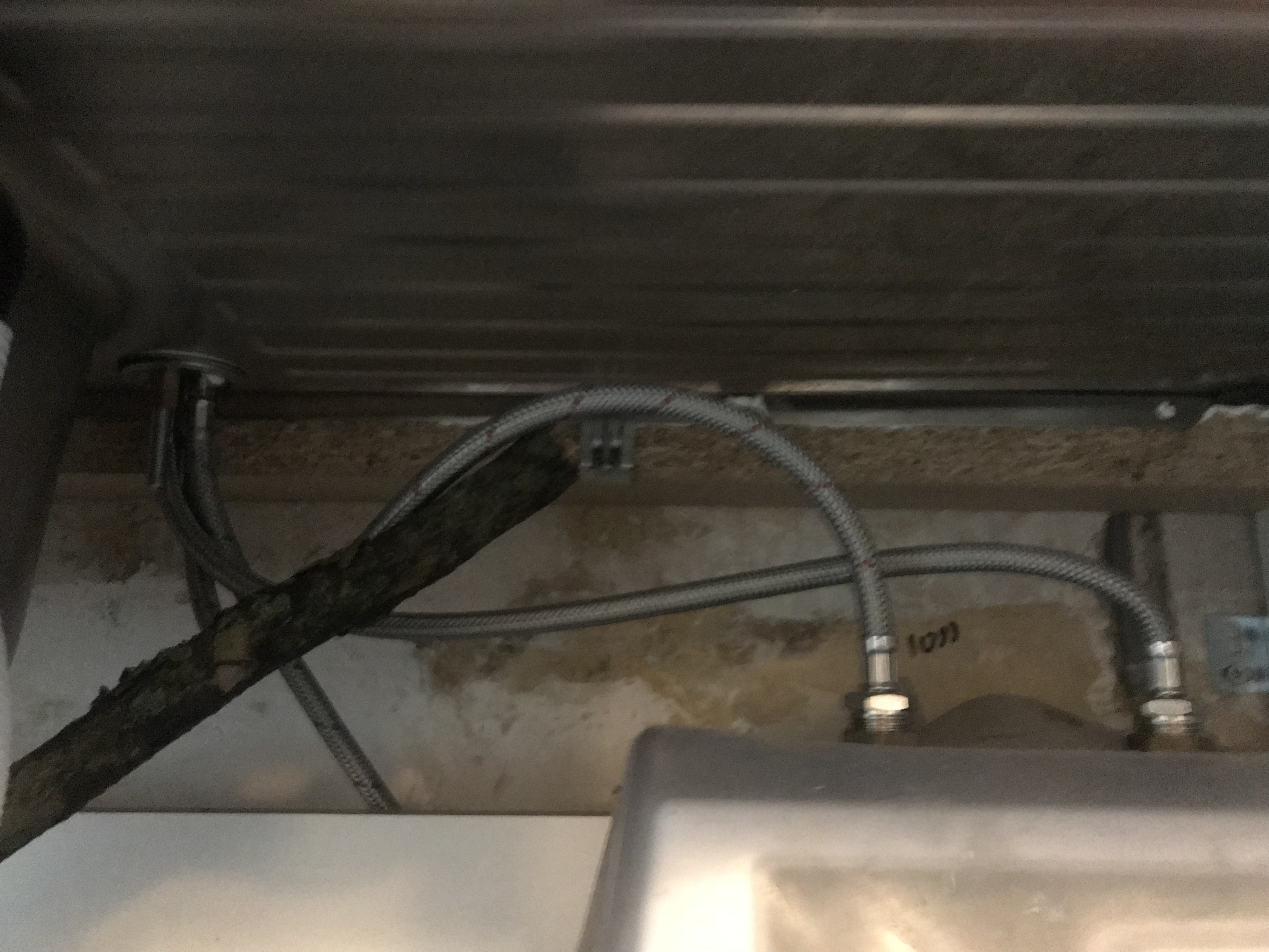

    There are no valves under the sink.
  • #11 17149570
    Krzysztof Kamienski
    Posts: 21895
    Help: 2033
    Rate: 5167
    @ Melaania3 What about the water pipes for the battery? None in the photo. An additional valve is installed there.

    Connecting a Portable Washing Machine to Sink: One-Tap Hot & Cold, No Special Drain Setup Connecting a Portable Washing Machine to Sink: One-Tap Hot & Cold, No Special Drain Setup
    I need the simplest solution possible. It is not possible to dismantle old cables and install new ones because the owner of the rented apartment does not agree to it. Thank you.

    One thing makes me wonder, three hoses come out of the battery, two for valves (which, in fact, are not there and should be), and the third hose?
  • #18 17149637
    Krzysztof Kamienski
    Posts: 21895
    Help: 2033
    Rate: 5167
    @ Melaania3 Dear Melanie, there is no need to dismantle anything here. :D on the contrary. Fit the valve upstream of the hose with cold water. After extension, hang the drain hose on the sink.

    He is behind the boiler. I suppose two are connected to the boiler and the third to the water directly.
    #20 17149647
    Krzysztof Kamienski
    Posts: 21895
    Help: 2033
    Rate: 5167
    Power supply and drain of the boiler - a special battery. But why are two coming out of the wall?

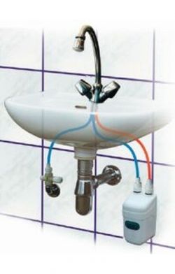

    @steam A faucet dedicated to an instantaneous water heater. Opening the hot water valve directs its flow to the heater (or boiler) through the third hose, and from the boiler to the hot water spout with the second hose. Cold unchanged.
    Added after 4 [minutes]:
    @steam More like a flow heater.
  • #25 17149793
    Parowy
    Level 22  
    Posts: 955
    Help: 55
    Rate: 227
    Key words :D
    So what the two hoses come out of is not a wall or a boiler, but a flow water heater, it means that the cold water supply to the system is located behind the heater and there theoretically should be a valve installed, which could be changed into a combo valve.
    Relatively low cost.
    But it will not be at all convenient when you need a washing machine there: plug in - do the washing - unplug.
    It remains to match the washing machine's power connection to the end of the spout, instead of the "strainer".

11. Can I share the sink with an electric instantaneous water heater?
Yes. The heater uses a special three-hose faucet. The combo valve attaches to the heater’s cold feed line before it enters the faucet, leaving hot-water routing untouched [Elektroda, Krzysztof Kamienski, post #17149736]

16. Expert tip for noise and vibration control
Place the washer on a wheeled dolly with rubber pads; lab tests show a 30 % vibration drop and easier repositioning [“Portable Appliance Vibration Study”, 2022].
