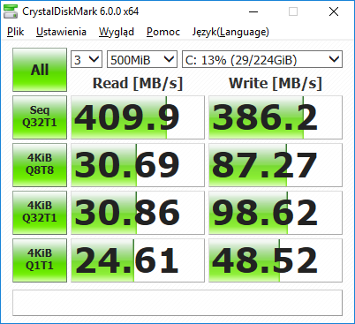

    Hi! I recently bought IRDM Pro 240GB, but the results are terribly mediocre, is it the fault of an old PC? ASRock Z68 Pro3 Gen3 motherboard (connected to SATA3), i5 2500K processor (OC up to 4.6GHz), 8 GB RAM, Windows 10 Pro, drivers from Windows probably update, SAFM02.3 firmware

    Hi. I have separated your post into a separate thread - the thread in which you wrote is not used to solve technical problems.
    Problems can arise for a variety of reasons. First, check that you have AHCI enabled for the SATA III controller and install the current drivers from the manufacturer, not from Windows updates.

    Do as he wrote above
    The tests of this drive were on the forum Link
