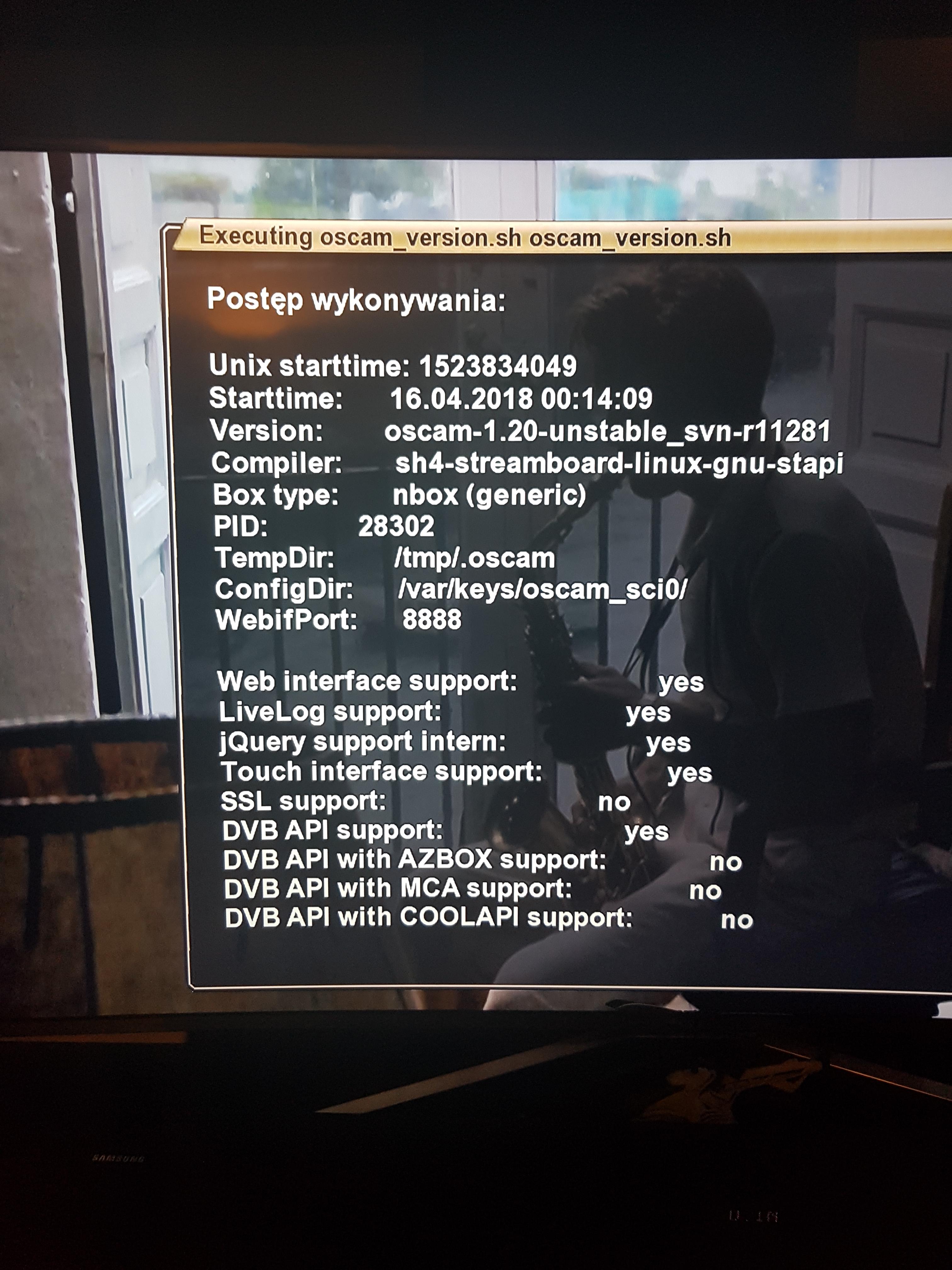

    I hope someone will be able to help me because I don't have the strength for this decoder anymore. I have Enigma installed on my n-box decoder model: ITI-5800SX. Everything worked until reinstallation because the previous owner set a password he forgot. After reinstalling, there was a problem with jamming channels during recording. I am green in this topic and I have no idea what settings to enter in to fix it. I have already tried to update the plugins and everything else, I updated the softcam but nothing helps. Someone will help, because I will hit me right away. Help please!

    Provide more details: what did you install, what emulator did you run, what card, what do you mean by jamming channels?

    The card is needed to view coded channels.
    You need logs from the emulator (probably it is oscam) to help you with anything.

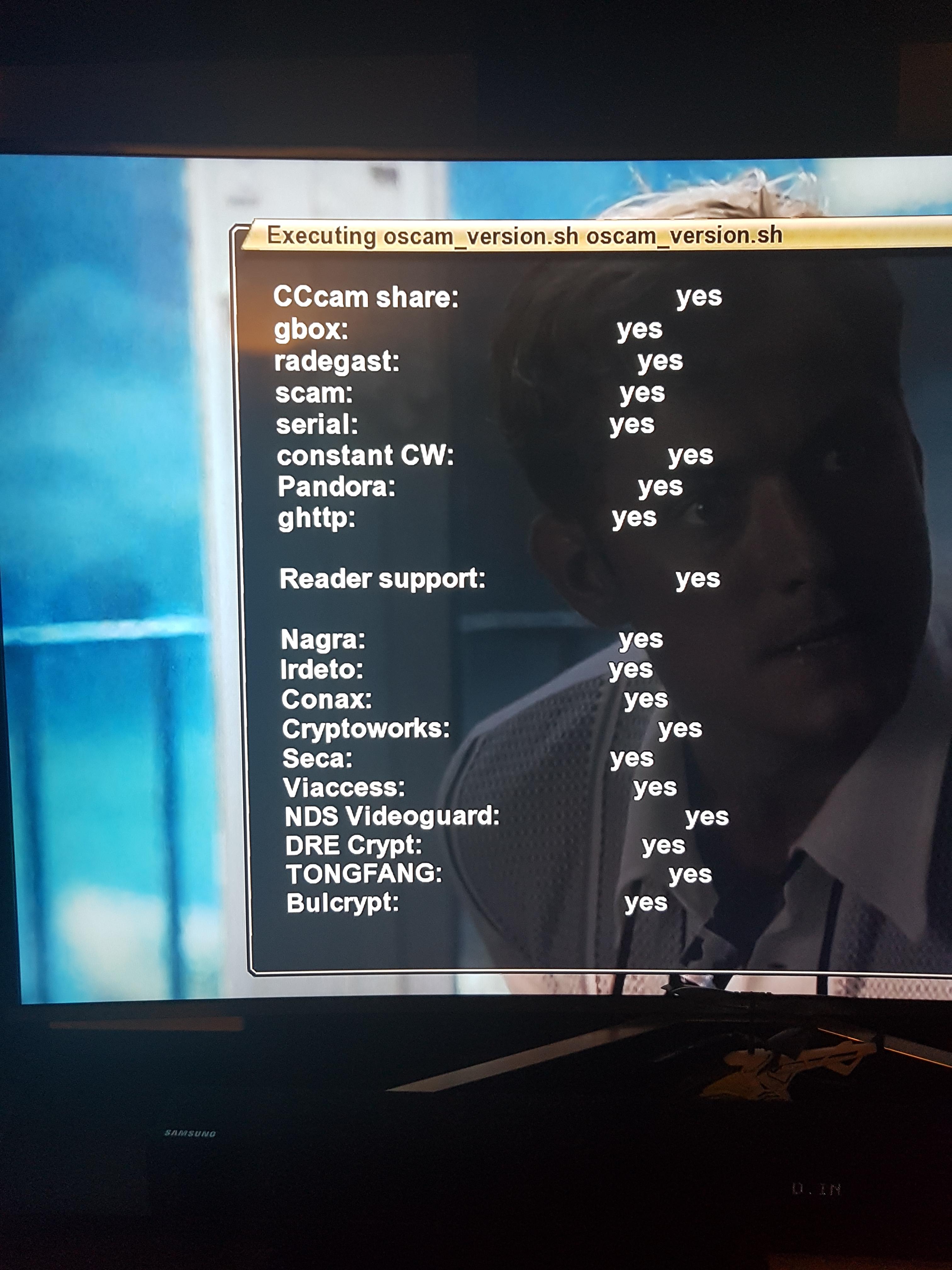

  • #6 17176013
    gemini159
    Posts: 29
    Rate: 18
    That's all I could find. I don't know if these screenshots will be useful.

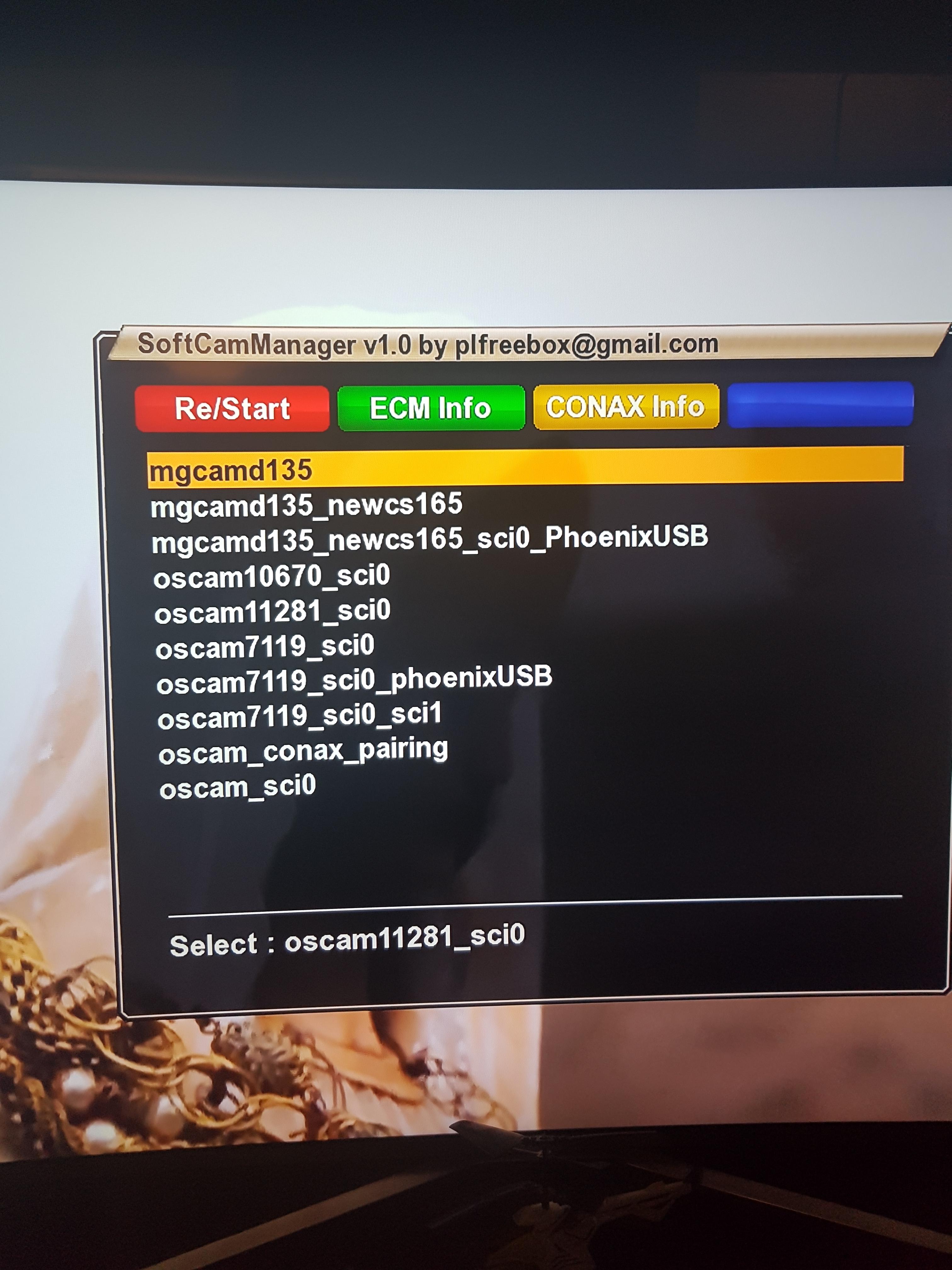

    #7 17177506
    rtomek
    Level 19  
    Posts: 358
    Help: 26
    Rate: 60
    Change the oscam test to a lower 10670, i.e. press blue, SoftcamManager, oscam10670_sci0 on the remote control, click OK and then red ReStart.
    If you have a tuner with a modchip it should help.
  • #8 17177634
    gemini159
    Posts: 29
    Rate: 18
    I've tried it all and unfortunately it's still the same. I am thinking more and more about buying something else. I do not know what is caused by such jamming channels.

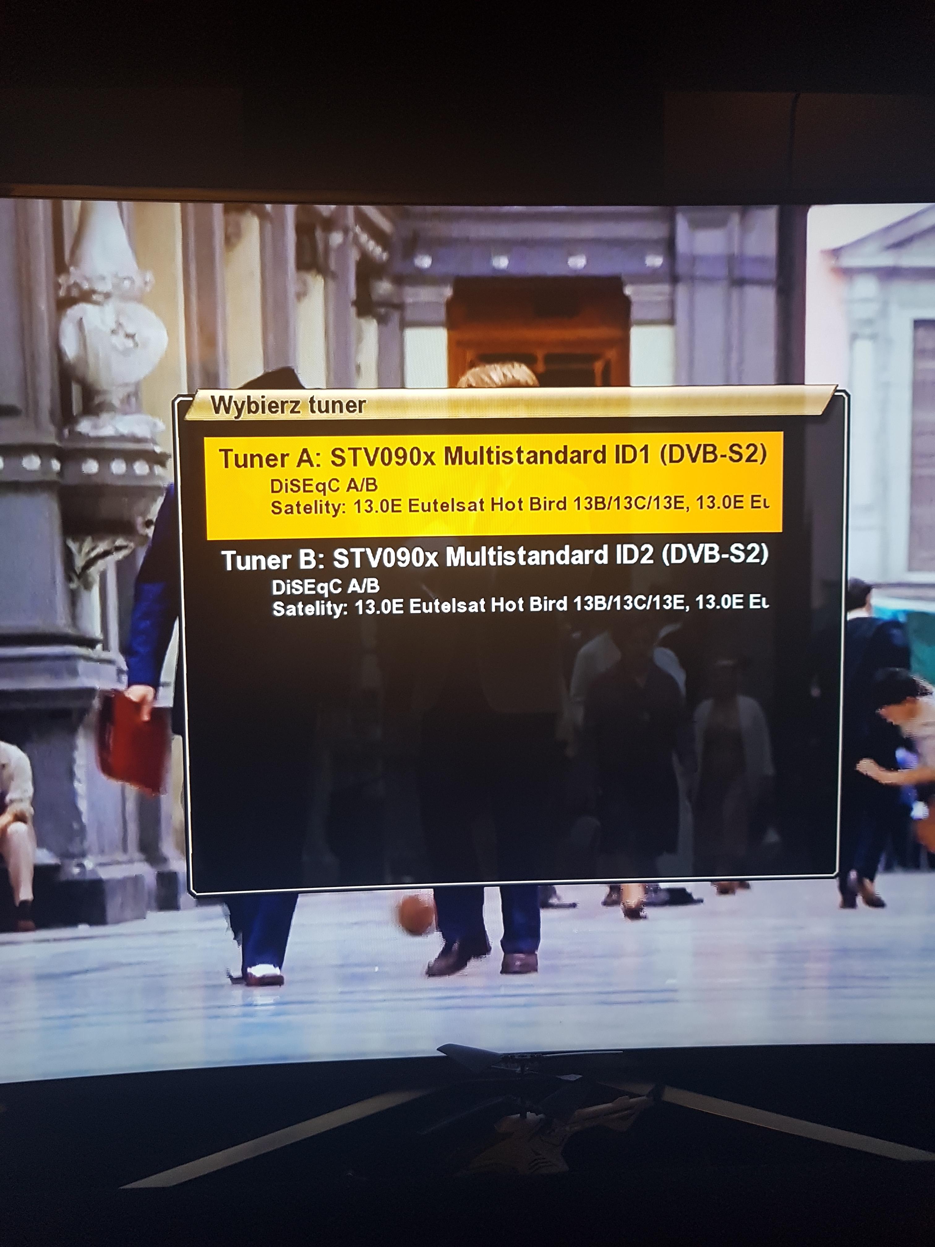

    What service provider?
    What decoder series? Enter the first 4 characters.
    If you don't have Astra, turn off diseqc in the tuner configuration.
    Provide the details of the antenna installation.
  • #10 17178123
    gemini159
    Posts: 29
    Rate: 18
    That was the specific answer. After turning off diseqc helped. Everything works as it should. Thank you very much.
