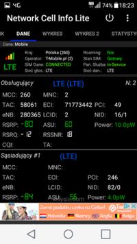

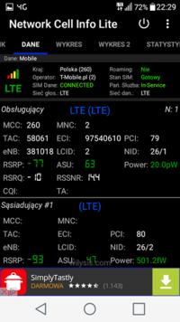

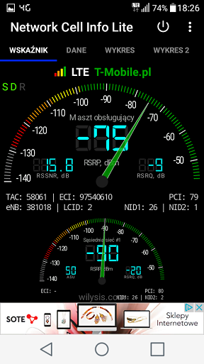

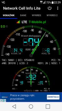

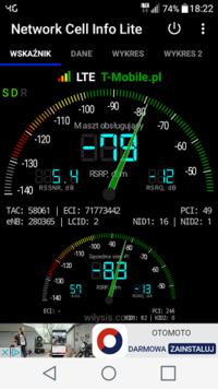

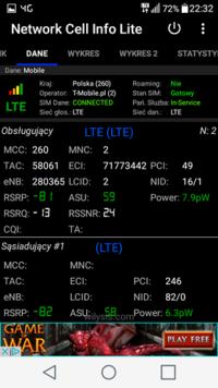

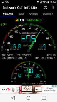

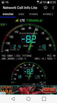

    Hello, for a few days I have tmobile without limits from huawei b525, place of residence ul. Złota 17, Chotomów. I'm after testing with a phone from LTE (LG Leon H340n) under transmitters on Partyzantów 27 (LTE1800) and Partyzantów 2 (LTE800) (both in Chotomów). Unfortunately, I can not test both frequencies at home with modem b525 because neither the ltewatchh and the toolbox are working (I tried on 3 laptops with different systems, in the net it can be read that people in tmobile on b525 these programs do not go) and I do not have to force frequency data. I wrote about this problem to the side on tmobile but they also write that they do not plan to update the software so that these programs work or send back to the hardware manufacturer. After contacting the side of huawei through the chat page they said that they do not have access to branded softs and possibly I can try to find out something at an authorized huawei site (I will try to call) although I do not think that they will want to dig in the softy.
    Now let's get to the merits. After tests (attachments at the bottom) on Partyzantów 27 Lte1800 in peak hours (test around 18:30) is tragically 5mbs dl, 28mbs ul, in the evening / at night (test around 22:30) is not better. On Partisan 2, the LTE800 is much better.
    Now the question. If you are unable to run the ltewatch or toolbox (as all signs in the sky and earth indicate), then after connecting the antennas / antenna for the LTE800 band and directing it towards this transmitter, the router will connect to the given station, or rather it will be random ?
    From what I read on the forum, the antennas I can connect to LTE800 are atk10 (800-980mhz) or atk20 (on the dipole is written 850-960mhz and on the cybertech 800-960mhz so I do not know if they are different constructions, is there a mistake in the description and whether atk20 will help improve the LTE800 signal). Which of these would you recommend and whether to buy two to polarize in two levels?

    Partyzantów 27, LTE1800, godzina 18:30
    Tmobile Unlimited: Huawei B525s, LTE800, Antenna Recommendations for Złota 17, Chotomów Area Tmobile Unlimited: Huawei B525s, LTE800, Antenna Recommendations for Złota 17, Chotomów Area Tmobile Unlimited: Huawei B525s, LTE800, Antenna Recommendations for Złota 17, Chotomów Area
    Partyzantów 27, LTE1800, godzina, 22:30

    It will connect to a stronger station (I'm not sure if it uses RSSI or RSRP).
    Antenna regulates the strength of the station, in this way you force.
    In order to connect to the weaker station by means of the antenna, the stations must be angularly distant from the sibie enough to suppress 'enough' unwanted stations.

    How did you decompose bandwidth during testing for partisans?
    because the antenna has to be on the band.

    Based on the topic link it turned out that the one from Partyzantów 2 is on LTE800. But now I see that the LTE800 and LTE1800 permit numbers are the same. So now I'm in a full stop because I have no idea which band I connected with ... Can you check it out?] Link [/url]

    Without LTEwatch or toobox, no.
    There is still permission for LTE2600.

    I remembered that I have a LG Leon phone on which one could have forced a band (band) by entering the hidden menu by inserting the appropriate code. Today I will try to test it. Thanks to @bogiebog for this question about decaying the bandwidth, because thanks to this the light in the head lights up that something is wrong. I will continue to fight these tests, maybe I will succeed.
