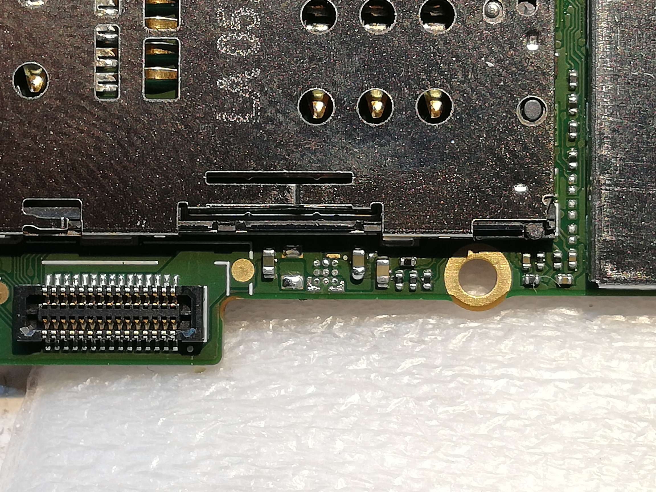

    The phone after replacing the screen someone undressed and damaged this system photo
    Would anyone have charging solutions and what could this damaged system be from?
    The phone, after charging the battery, works separately, but does not charge.
    Xiaomi Redmi 4X Charging Issue & Damaged System: Screen Replacement, Solutions & Clues Xiaomi Redmi 4X Charging Issue & Damaged System: Screen Replacement, Solutions & Clues

    Desolder the layout and show what the fields on the board look like, it can only be a double protection diode and you can easily bypass it.

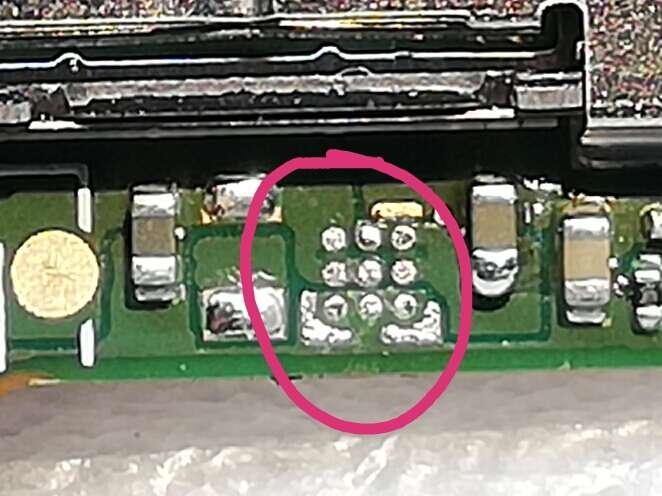

    this is how it looks
    Next to the left is a tape that goes to the bottom plate with USB, so rather this system will have a lot to do with charging.
    Added after 4 [minutes]:
    Can this arrangement be bypassed? If so, which pads do you need to connect?

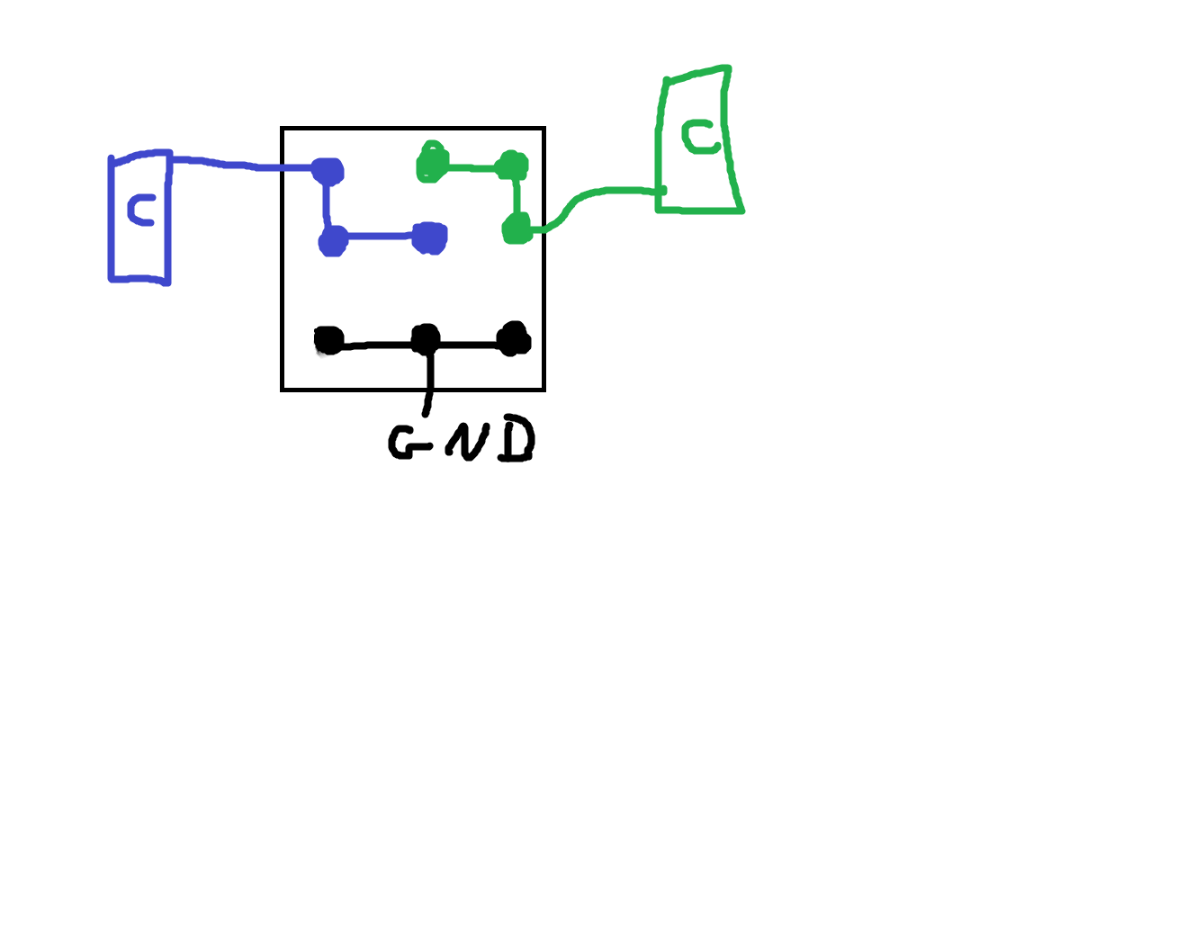

    so these pads are connected
    Is it enough to combine the blue and green pads for charging to return?

    Connect blue with green and should flash.

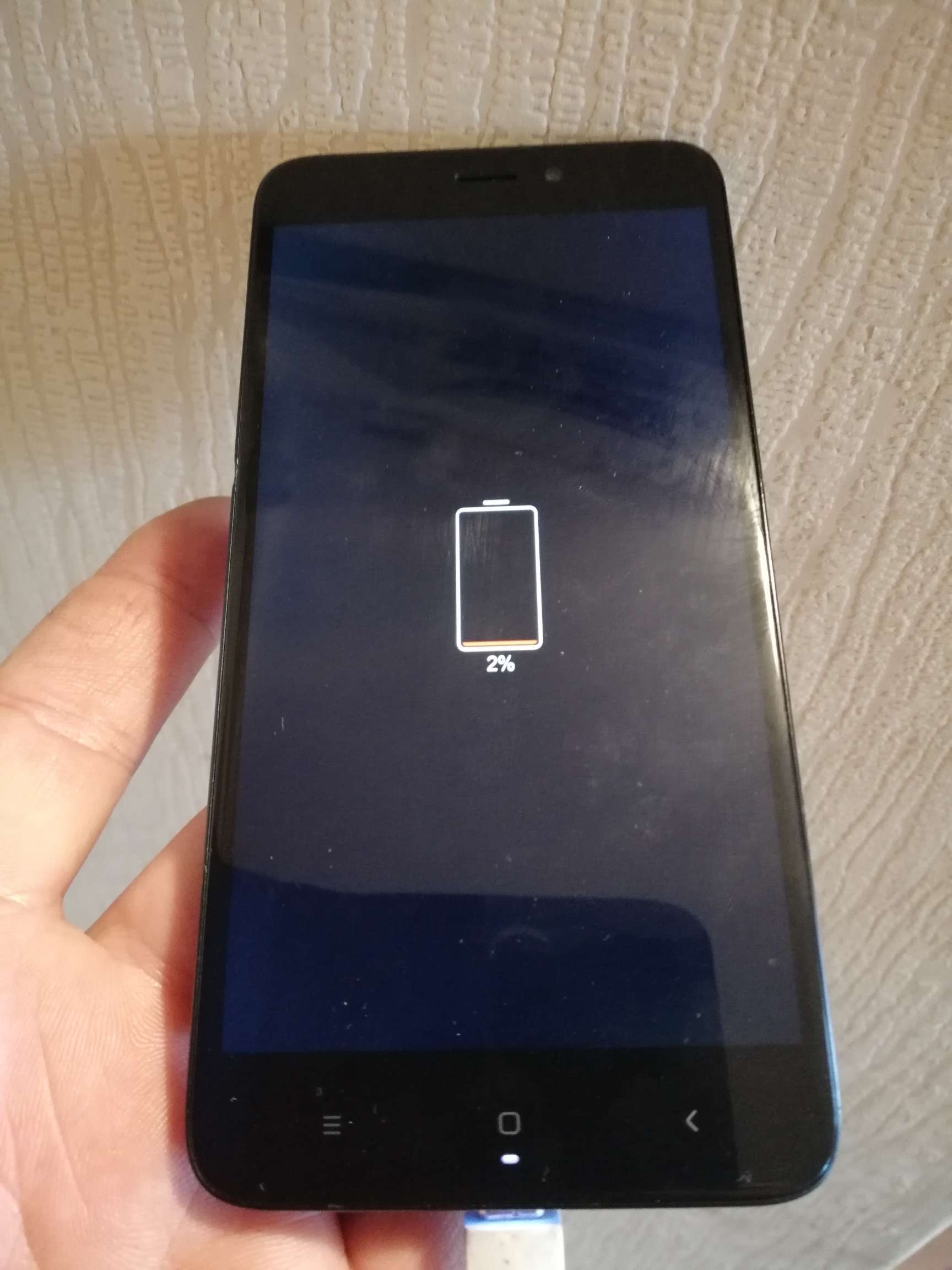

    After connecting the green pads with the blue phone works again thank you. Xiaomi Redmi 4X Charging Issue & Damaged System: Screen Replacement, Solutions & Clues
