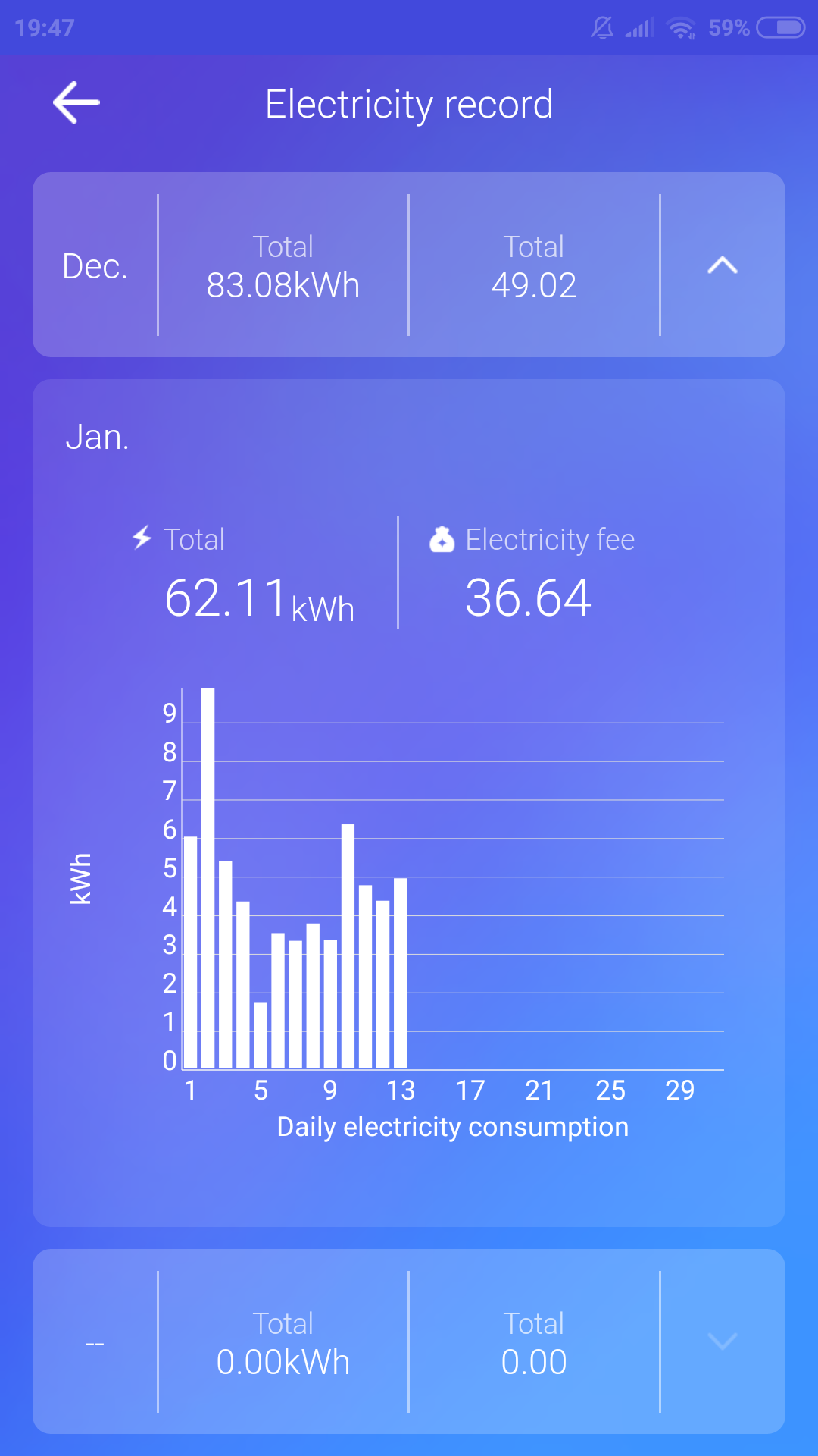

    PLN 140 x 6 months when you need to heat it is PLN 840 for half a year.
    Is it a lot for you? You press a button and that's what interests you.
    Calculate how much coal you burn in the furnace or how much wood in the fireplace and this job and you don't have a constant temperature.

    Yesterday I checked what it looks like for me and from 19 p.m. to 7 a.m. at an outside temperature of -4 degrees, my device used 5 kW temperature set to 24 degrees, which gives me in the apartment between 22-23 degrees

    And how is your climate warming up? The cost of heating the apartment with air conditioning is 40m2
    For me, 145.19kWh used since the beginning of December, which is some 86 PLN. I do not save on electricity. Setting 23-24 degrees. I turn off the heating at night because it is stuffy, hot and it does not go to sleep. It happened to be lit in the fireplace, but it is for the climate. Once I throw in, fire up and I have 26 degrees at home that you have to open the windows because it's hot. There are over 20 degrees at home all the time.
    As long as there are no severe frosts, it works perfectly. I hope that the 50l electric boiler will generate as much electricity as heating the entire apartment with air conditioning.
