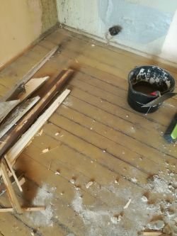

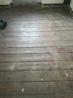

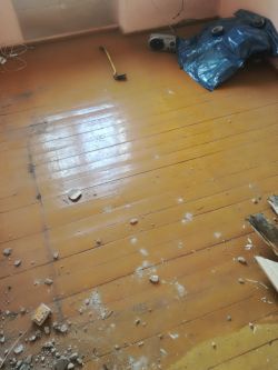

    In general, I was in favor of leaving the old boards on top, unfortunately, but in places they are in a condition that is not suitable for it, I will finish them off to prevent creaking, which is not really the case.
    As of today, it will look like today I'm going to tear down one of the partition walls, there will be one large room 3.30m, I would align with OSB boards, I will put the wall again and hey with the rest.
    zimny8 wrote:
    If evenly, you can immediately put the panels on the sponge, apart from the OSB.
    - will nothing happen? The floor is gentle with places.
    Slabs are a cost, if you can avoid it, gladly .... if I am today after demolition, I will add a photo, it may somehow help, a tenement house from 1880.

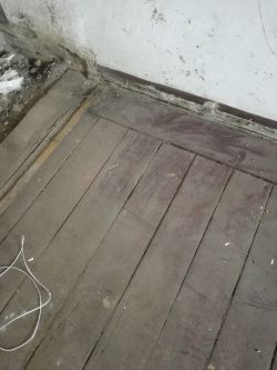

    In places it moves in places of nails driven in. Nailed on joists but nailed probably in 1880 and so to this day, the previous owner did nothing completely Restoring Old Tenement House Floor: OSB Boards, Joists, and Leveling Tips for DIY Renovation Restoring Old Tenement House Floor: OSB Boards, Joists, and Leveling Tips for DIY Renovation Restoring Old Tenement House Floor: OSB Boards, Joists, and Leveling Tips for DIY Renovation Restoring Old Tenement House Floor: OSB Boards, Joists, and Leveling Tips for DIY Renovation .
    that's how it looks today

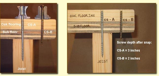

    There are special screws for refurbishing such a floor.
