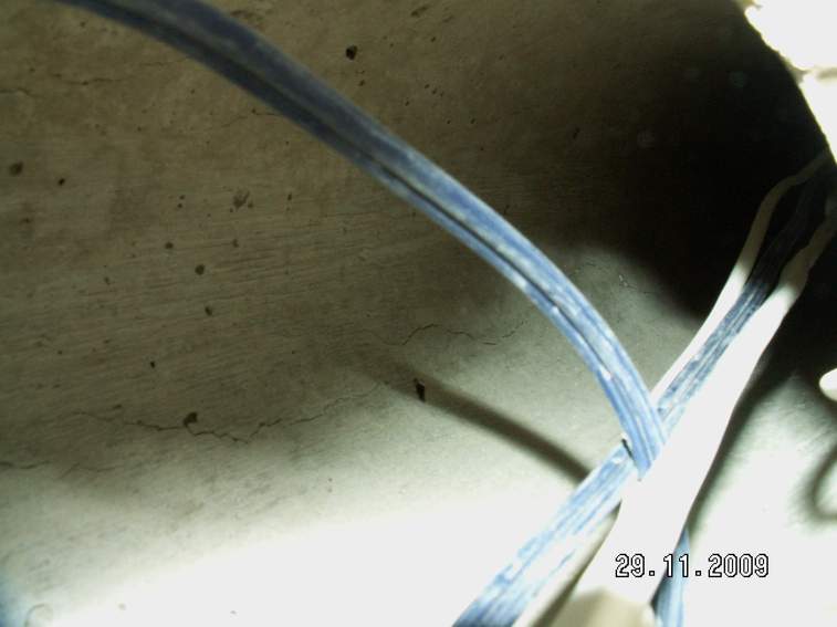

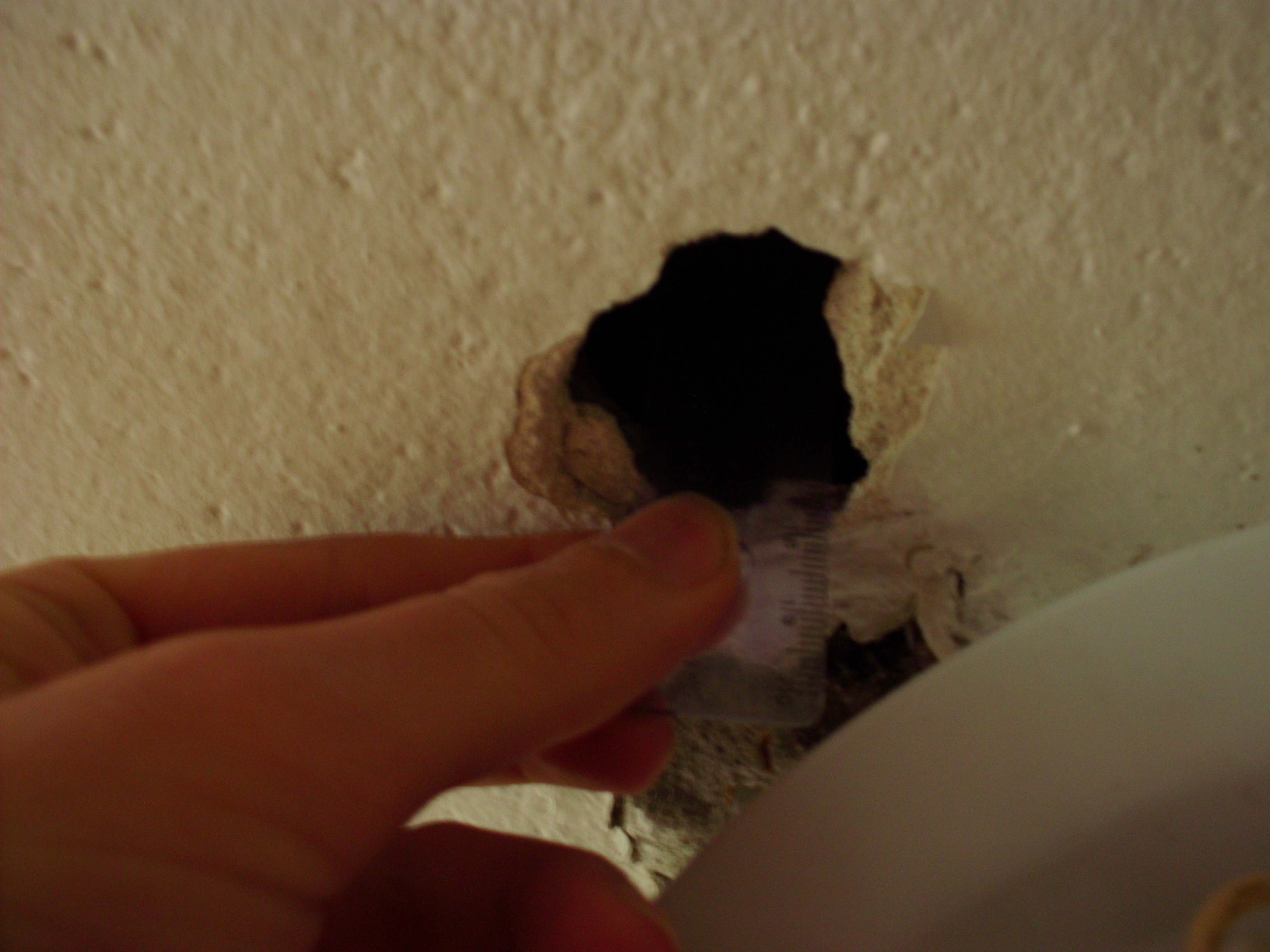

    Hello, I am a resident of a 10-story building with the so-called "big plate". During the renovation and drilling new holes in the ceiling, I broke through a thin layer of plaster (I don't know if it was even 1 cm thick) and a large open space appeared to me. It probably extends over the entire kitchen and is about 22 cm between the plaster and the concrete ceiling. Is this normal in this construction or did someone make a terrible fuszerka? Will plaster be enough to patch this hole so that it looks whatever it is?

    Maybe it's a suspended ceiling made of plasterboard. The board is 12mm thick.

    It may be suspended, but I don't see any cardboard there. Its different thickness is strange. Where the hole was created, it is thin and crumbles from the touch, in other places it is over 5-6 cm and you can normally attach pins. In addition, there is a lot of debris on the mines, some fist-sized pieces.

    Then put your phone in there with the lamp on and record the image in a circle and you'll see what's there.

    Releasing the structure. In my house there are channels with a tubular cross-section (vertical) in the walls, so in the thinnest place the wall is also about 1 cm. It does not weaken the slabs too much, but significantly reduces the weight of the building and the pressure on the foundation.

    There is solid concrete there, so bricks are not an option. I wonder if these are not deliberately created spaces to improve sound attenuation / reduce heat loss.

    Or maybe there is no point in making a theory, just look at the photo? :D
    :arrow: Giselhert you just hit the channel. Perhaps this hole was already made there at the construction stage and was covered with plaster by the contractors.
    Often, the channels were used to pull wires and to make it easier, a hole was cut every 2 - 3 m, which was later covered with plaster.

    If they are channels, as you suggest, they are in the shape of an inverted U, i.e. open from the bottom because there is only a thin layer of plaster there. I've sealed it with putty for now and hope the ceiling doesn't fall on my head one day :D
