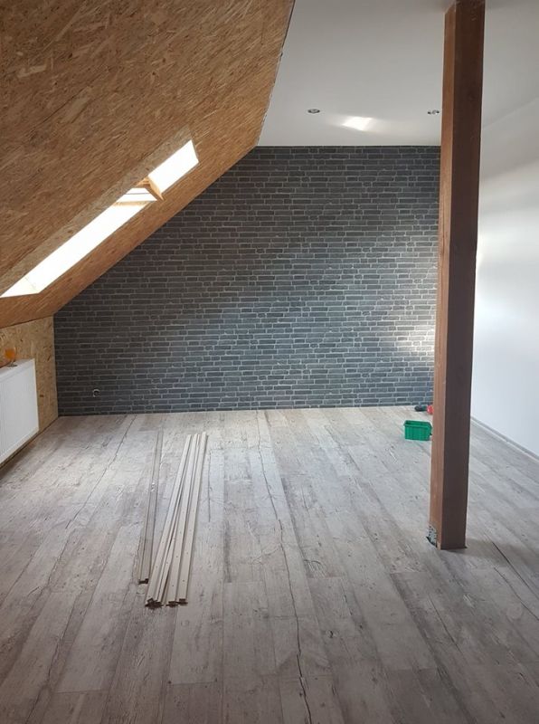

    Hello, the renovation team offered us to finish the slants in the OSB attic, the idea is great, of course, visually also not bad. But no one said about the harmfulness of these plates ... children will live.
    The rooms are about 25 m2, the entire wall with a slant on the length of 6.40, moreover, I am sending a photo in the attachment. I am referring to you experienced people, please, what should I do about it? Leave as is? The more opinions I read, the more confused I am. I don't want to break down my unknowing harm to my teens, and they are getting ready to sleep in their rooms today.
    Is OSB Harmful in a Child's Room? Renovation Team's Suggestions & Safety Measures
    is it enough to paint it with something?

    Where did you read about the harmfulness of OSB boards? I ignore the questionable sense, costs, visual aspects and "standard" technical solutions in such a place (ie mineral wool and drywall on top), but I would not care. OSB boards are used in many places and nobody pays attention to the supposed harmfulness, I even asked someone about it quickly and said not to worry about it at all. In addition, you can see that the team is weak, because it is not done aesthetically.
  • #3 17434487
    Jorysiu79
    I know that the quality leaves a lot to be desired, unfortunately, when a woman is alone on the battlefield, the effects are the same ... but this is not the end of this work because I have suspended the work for the moment.
    As for the harmfulness of the plates. The gentleman who founded the lighting informed me that they contain formaldehydes and other toxic chemicals
    Added after 23 [minutes]:
    and you cannot put GK on it
    I got just this answer to my query:
    A raw plate as a finish is a visually interesting idea ???
    The OSB board gives off formaldehyde and it cannot be found in living quarters in the form you have.
    There are even standards that define the maximum area of OSB in living quarters. Here I see no alternative but to disassemble these panels and finish them with something else, plaster or wooden board.

    Call a specialist and have him put plaster on the board.
    It looks very bad.

    Hello my friend,
    as long as I have been working on repairs, I have never heard of something like this, and probably about many other things as well :)
    Out of curiosity, I read a little about it and
    https://www.swisskrono.pl/mdb/Plyta-OSB/produkt
    The text mentions the hygiene class E1, so
    https://wuteh.com.pl/klasa-higienicznosci-e1/
    These are specific companies, so the reliability of this information can be different.
    For the sake of peace, I would recommend you to find out what exactly and what manufacturer of discs were used, then obtain a technical sheet and approvals of this product, you can come to the forum and we will read whether it is harmful or not :)
    As for the quality of workmanship, well ... I am not a carpenter, but a lot .. does not stop :)

    How should the GK go, it is OSB for disassembly and mineral wool underneath (probably not there, but that's just my guess) and a frame to make the GK properly.

    It is possible, as long as these specific boards meet the requirements of the mentioned E1 class :)

    In this case, there is no question of build quality. At the end of the plate, zero fold (and if they wanted to, the plate was stained with paint after painting the ceiling, a protruding piece of an angle bar at the post ...

    THERE IS A FRAME AND WOOL

    Toxic formaldehyde is released from such OSB boards, therefore they are not suitable for use in living quarters, especially in children's rooms.
    There are appropriate standards for this, let's get to know the specifics of the discs used in this case, before we give a verdict.

    that is, it must meet!
    According to the book "Documentation and specifications in public procurement" in the field of OSB boards:
    - formaldehyde content - class 1 | = 8mg / 100g
    Let me put it this way, I'll try to get information from a warehouse ..
    I feel helpless, deceived and I will honestly say stupid ... and I'm terribly sorry that I got so messed up

    Just paint it. Colorless.
    Secondly, you cannot even imagine how much formaldehyde is generated by kitchen furniture. I have a Chinese meter, the morning massacre is in the kitchen.
