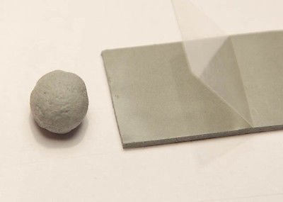

    3. You use something like this, it adapts as needed
    Choosing the Right Thermopad: Acer Aspire S3 Laptop Cooling System Replacement & Thermal Paste
    are high-class thermocouples also used originally in laptops "Laird Technologies T-flex 760 Thermal PAD Wärmeleitpad GPU"
    You can use aluminum or copper plates under certain circumstances but at your own risk - chipping the core with very uneven heat sink
