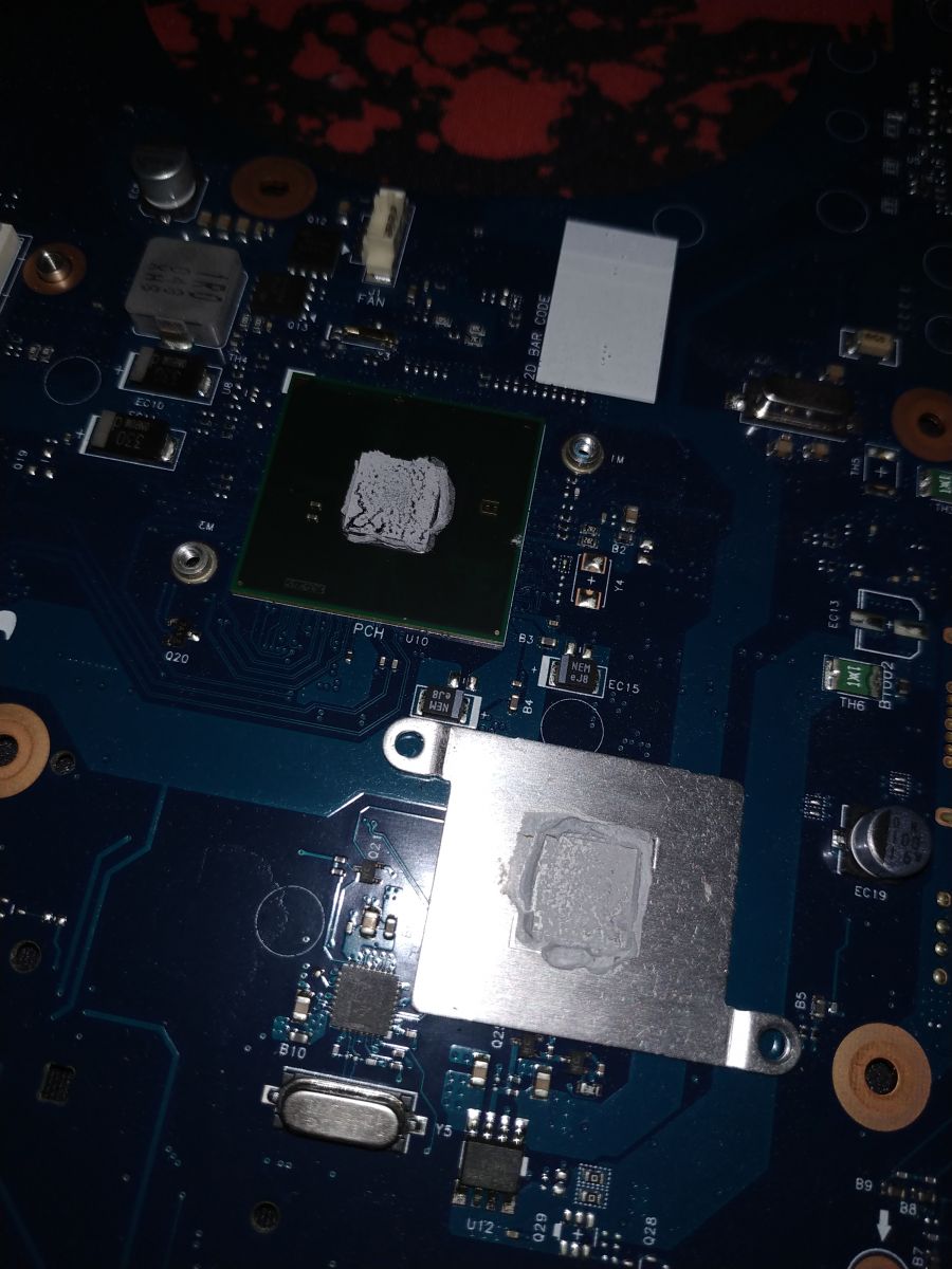

  • #11 18464160
    krzysztofer100
    Posts: 255
    Rate: 35
    sosarek wrote:
    Show me how it's mounted
    Now I have the cooling dismantled but I haven't cleaned the paste from the core yet and the cooling pressure left such a trace
    Processor after thermal paste replacement - Heats up quickly under load
    The ONLY thing I haven't mentioned so far is this thermopad thermal paste on the chipset, but I don't think it had such a huge impact, especially since before replacing the thermal paste everything worked great and never exceeded 60 degrees under load
  • #12 18464163
    sosarek
    Posts: 83875
    Help: 9320
    Rate: 15532
    The paste should only be on the cores and not the elements around because it can lead to a short circuit (if with silver).
    If the thermocouple is intact, don't touch it.
    Z
    Pka, Poznań, 60-850

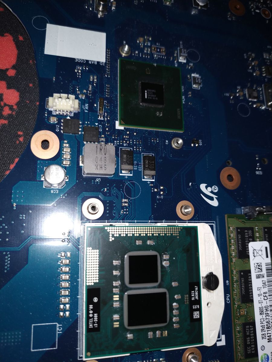

  • #13 18464166
    krzysztofer100
    Posts: 255
    Rate: 35
    I take back what I wrote, there is no thermopad here, only a paste that is already dried, but would it have such an effect on the processor?
    Added after 16 [minutes]:
    krzysztofer100 wrote:
    only paste that is already dried
    Everything cleaned and degreased on the mirror, I put everything together and in a moment I will send a screen of temperatures from the Speccy program

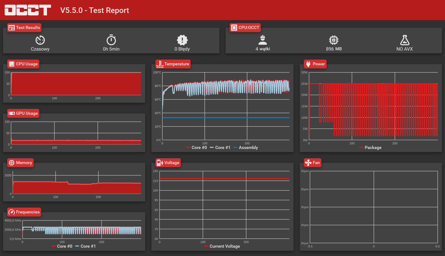

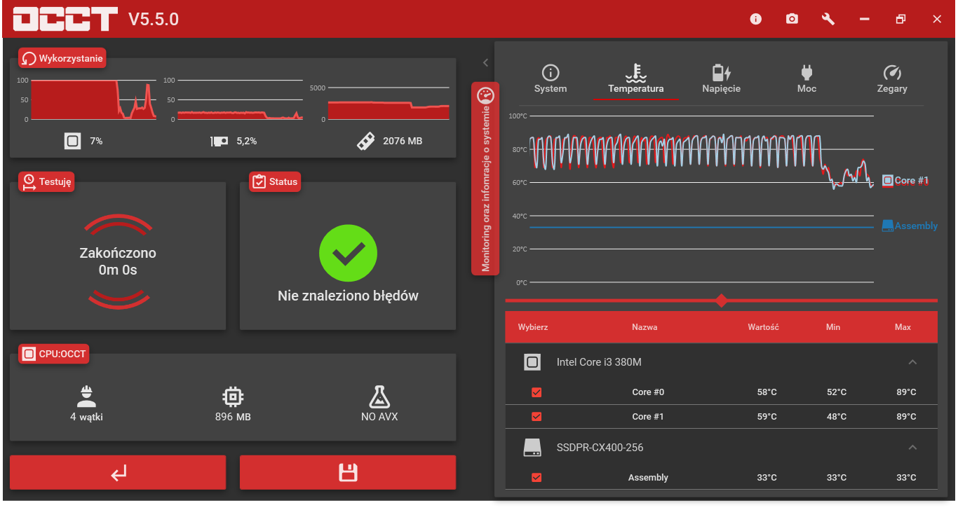

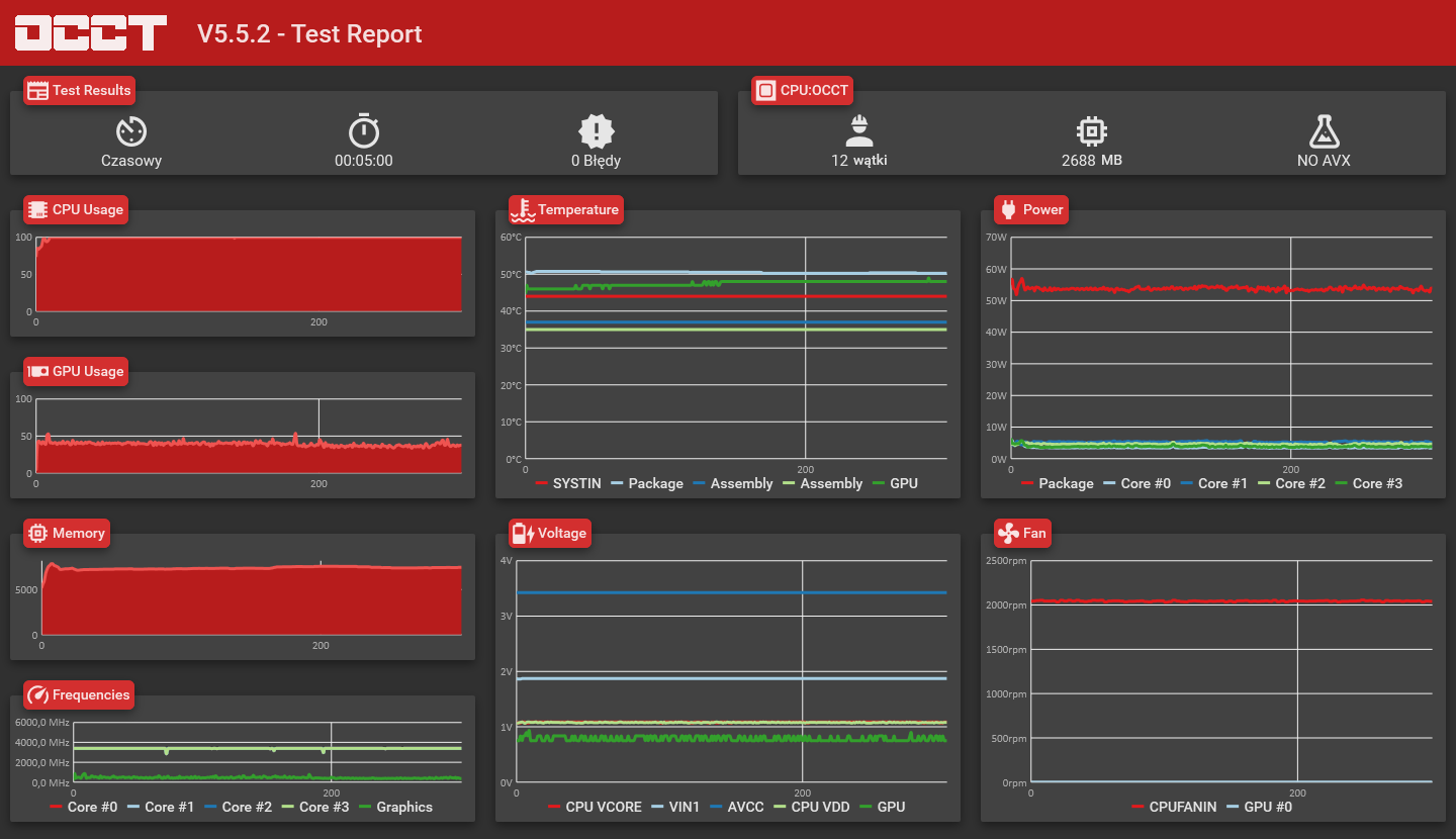

  • #15 18464349
    krzysztofer100
    Posts: 255
    Rate: 35
    OCCT results from a laptop. The temperature jumps by more than 10 degrees, something is clearly wrong, the maximum temperature is 89 degrees, at 90 it turns off, fortunately the entire 5-minute test passed, I suspect that if the test lasted longer, it would not complete it due to the power being turned off at 90 degrees. The temperature at load jumps every 10 degrees, when it cools down it goes evenly after 1-max 2, but as soon as it starts to be loaded it jumps by 3-5-10 degrees, different.
    For comparison, the result of the same test on my pc
    Here, the computer was clearly bored during the test compared to the temperature jumps on the laptop
    Screenshot of OCCT after the test on a laptop
    Processor after thermal paste replacement - Heats up quickly under loadOCCT-Scree...134125.png (126.61 kB)You must be logged in to download this attachment.

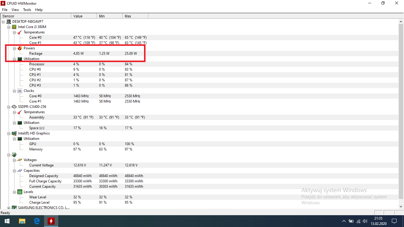

  • #19 18464527
    krzysztofer100
    Posts: 255
    Rate: 35
    miecho18 wrote:
    what voltage?
  • #20 18464532
    miecho18
    IT specialist
    Posts: 18700
    Help: 3087
    Rate: 2777
    Please tell me what it is because I can't see it. The frequency and power consumed by the processor jumps due to throttling, but it is normal for the processor to overheat.
  • #21 18464537
    krzysztofer100
    Posts: 255
    Rate: 35
    That's what I meant about the POWER tab. I will note that before all this overheating I pulled out the bios battery because the laptop was not started for a long time and nothing happened after switching on. After that, I disassembled the entire laptop to clean everything and this problem began. I don't have the strength for it anymore, because I don't like to disassemble this laptop for the 5th time, because you have to disassemble the whole thing into the first parts
  • #22 18464538
