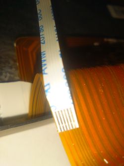

    Hello!
    I have a 7 inch display. Can it be adapted to the Raspberry Pi?

  • #2 17218985
    michcior
    Level 30  
    Posts: 1132
    Help: 159
    Rate: 462
    You didn't show the most interesting thing, the tip. Show what connector it has, how many pins it has.

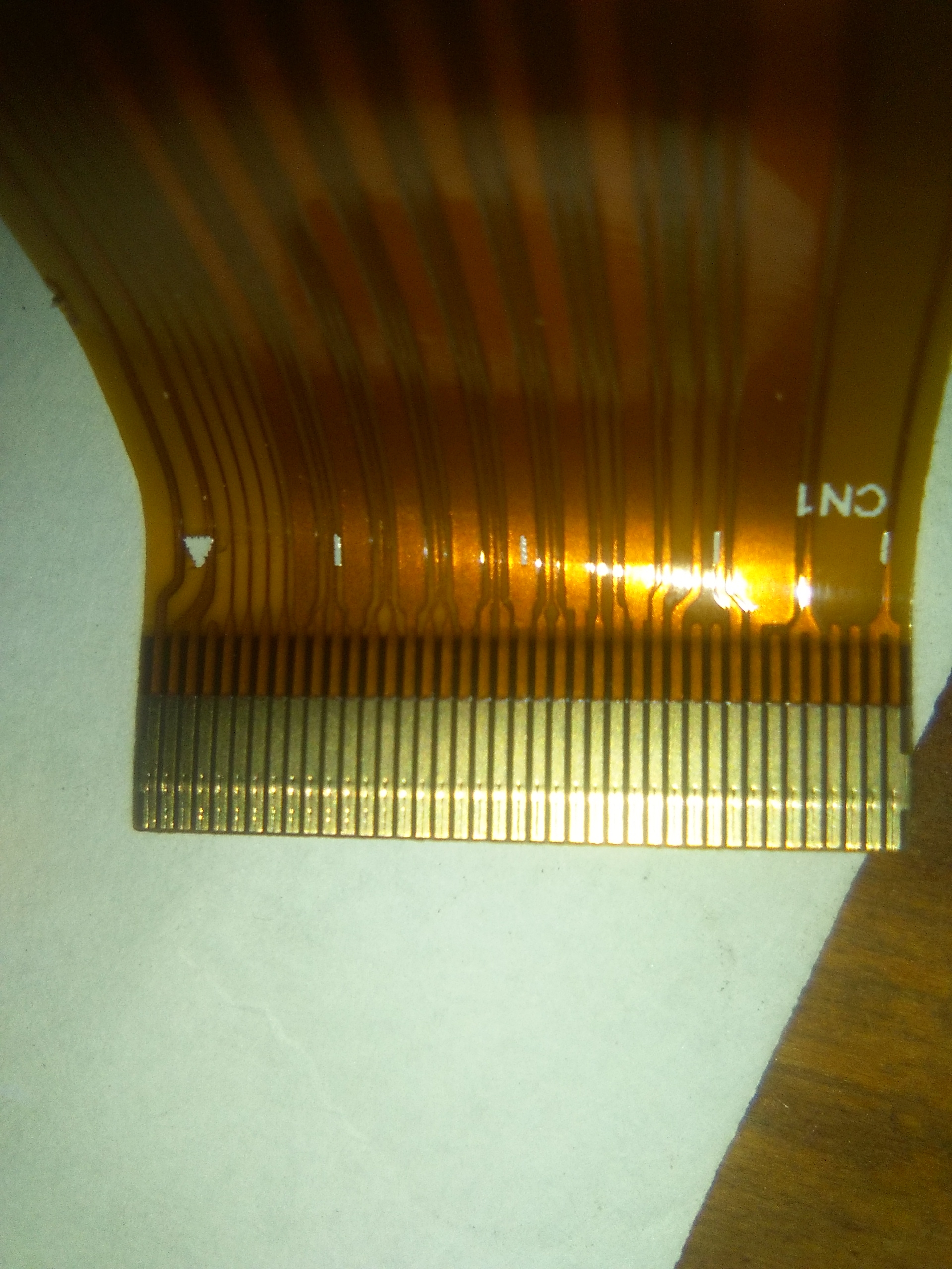

  • #3 17219017
    grzegorz.d3
    Posts: 318
    Rate: 18
    Here are the pins.

  • #4 17219028
    lechoo
    Posts: 5161
    Help: 377
    Rate: 546
    This matrix probably has a 40-pin LVDS connector, you won't plug it into RPi.
  • #5 17219260
    michcior
    Level 30  
    Posts: 1132
    Help: 159
    Rate: 462
    No connection, via an HDMI adapter, only you need to know what are the signals on this tape. Will not fit any standard 40 pin LVDS tapes. In total, the DSI on the 40 pin tape is also similar, so there is no certainty that it is not a DSI.
    Well, you gotta get past that tape. You can't go without it.
