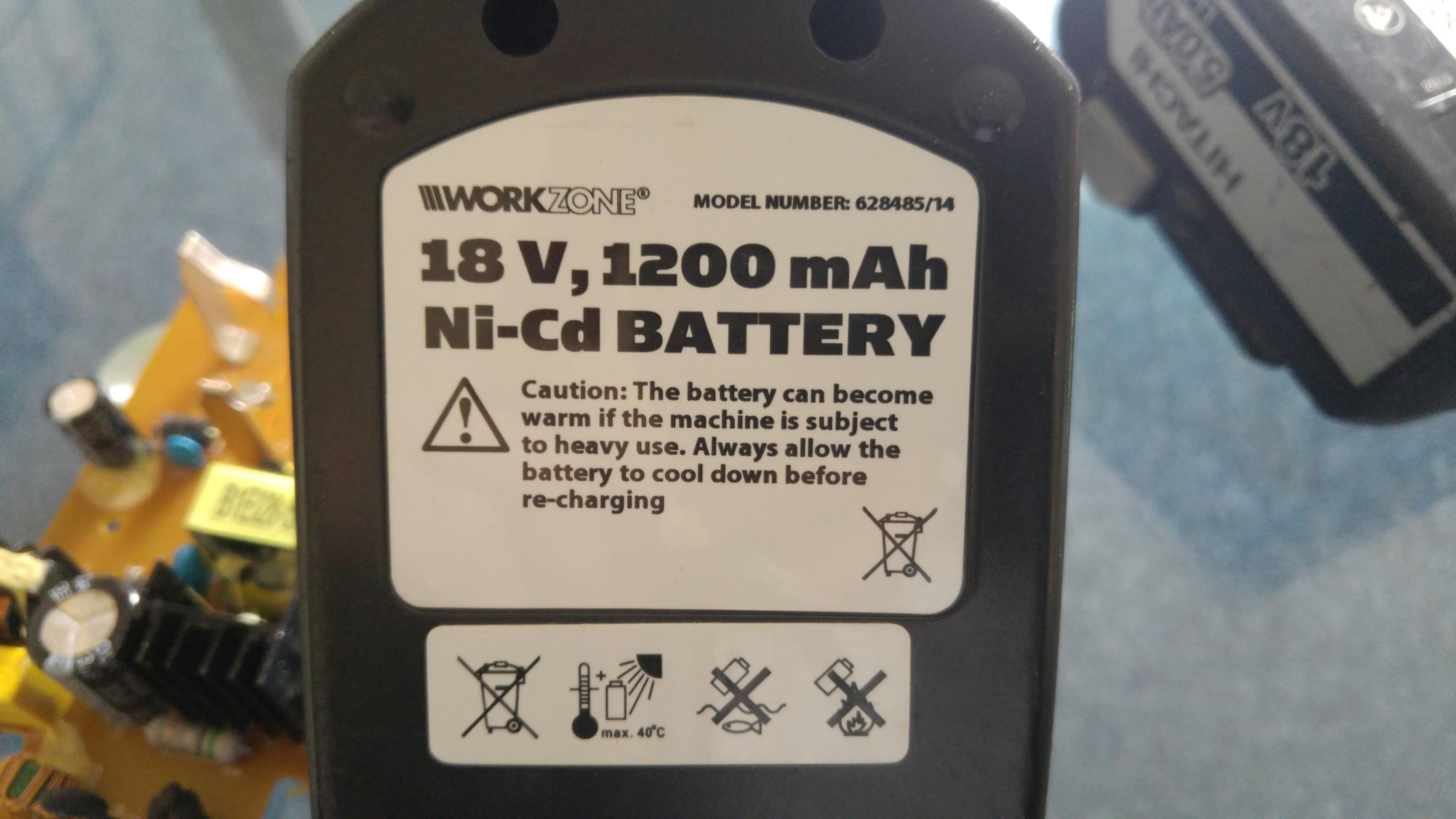

    Hello everyone :)
    I have an 18V screwdriver powered by a Ni-Cd 1200 mAh battery.
    I got a battery, also 18 V only 5 Ah and Li-Ion.
    My question is, is it possible to convert my old charger to a new battery? I searched the forum and found several posts about the same conversion, but one says that it can be done without a problem, and in another that it is not possible. Besides, these are posts from 2015.
    Below he adds some pictures which I hope you will find helpful.
    Charger Pictures:
    Converting 18V Ni-Cd Charger for Use with 5Ah Li-Ion Battery: Feasibility and Process Converting 18V Ni-Cd Charger for Use with 5Ah Li-Ion Battery: Feasibility and Process
    Picture of the current Ni-Cd battery
    Photos of the new battery
    Thanks a lot for any help.
    If it is not possible to remake my charger, maybe it is possible to make one, e.g. from a laptop charger, which also has a Li-Ion battery.
    I would like to add that I wanted to transfer the cells from this 5Ah battery to my old 1.2 Ah.
    Edit:
    The reason to change the battery is because my current battery is very poor. After full charge, it keeps about 5 minutes of continuous work and that's it. I think I know why it happened.
    I just checked what current goes from the charger straight to the battery and it is NOTE 38V.
    It's probably way too much. Does this mean the end of the charger?

    Start with the charger ... can you use it (you don't need a special Li-Ion one) but you need to output about 21V
    The second important thing, open a new purchase, there you will have an electronics board on the cells, take a photo and give it, it's about pins and markings, This is a discharge protection module and maybe a balance, because it will ultimately decide whether you will need a specialized charger or I can just charge what you have.
    Yet there is another solution, but do it later, so don't be afraid of anything the solution will be found

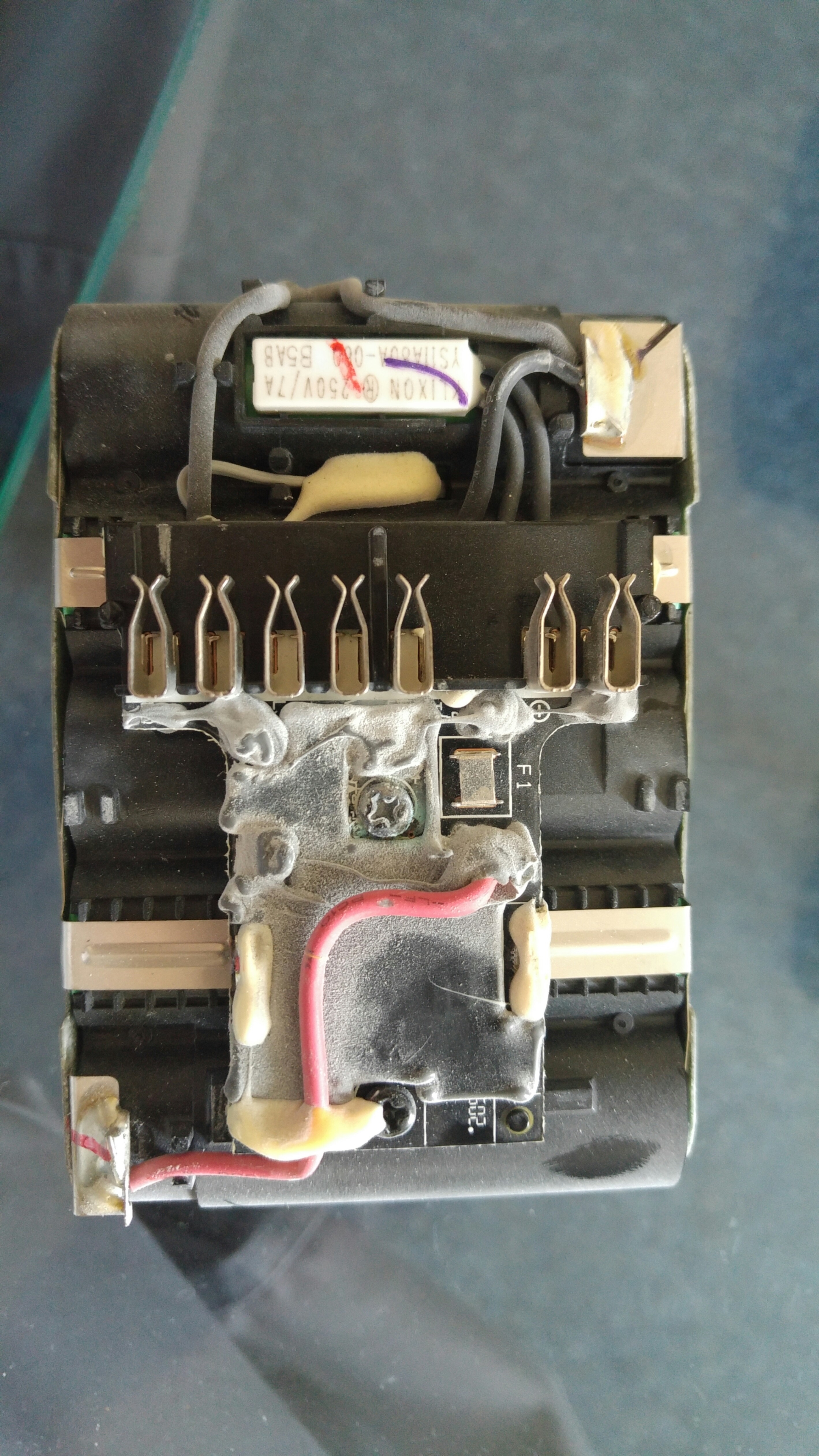

    I do not know about my charger, I do not see anything that could indicate its damage, and yet the current is 38v at the output.
    I throw in the photo, but this plate is all stuck and you can't really see anything.

    Try to gently remove this cover, we need to see the module.
    Unless someone from your colleagues unscrewed the battery and says about the pins.
    A lot of these pins. You can see that the links were probably balanced from the outside. Chargers.
    Big + and - this is the output. maybe it will also be possible to recharge after them

    Unfortunately, after many attempts to remove this glue or whatever it is, it has not been possible to get rid of it. It was coming off piece by piece, but it did not break away from the plate itself, and I didn't want to try to do it with anything sharp.
    I feel like I will be left with one good battery I am unable to charge and damaged original battery and charger :)

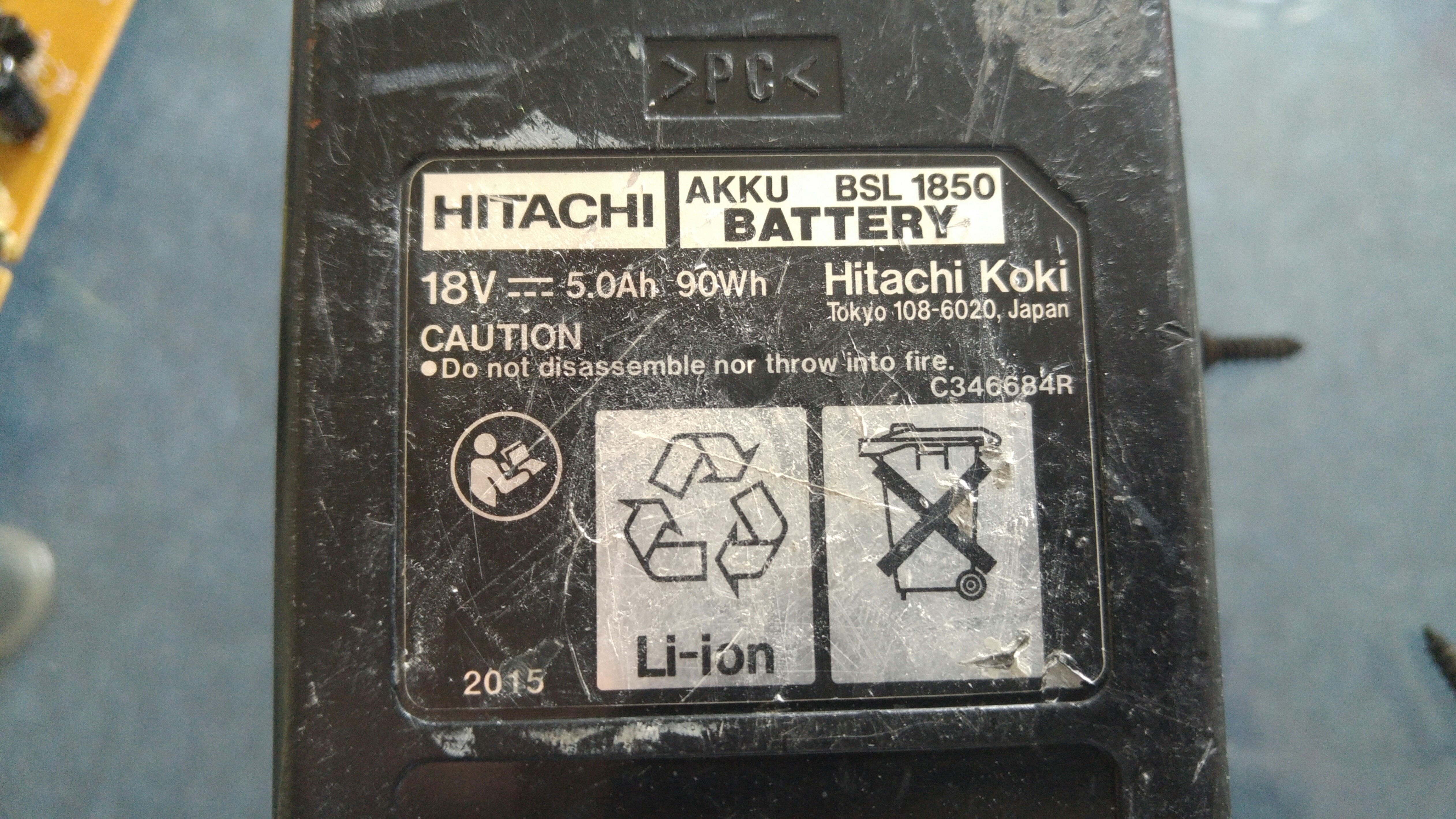

    This in the picture in # 3 is it a new Li-ion battery, an old charger, or something else?
    As for the battery, it should have some marking - maybe you can find a description on the manufacturer's website according to this?
    The Li-ion cell itself should be charged to a voltage not greater than that specified by the manufacturer - they can be different, usually from 4.1V to 4.2V, and you have to watch it very carefully - exceeding the specified voltage generally damages the cell, and sometimes what is Near. This cell may contain a circuit that protects it against inappropriate charging and discharging - with this circuit it tolerates a slightly higher voltage.
    The balancer ensures that the cells are charged evenly. It must be at the battery. If it is not there, the battery will probably not last long.

    The plate in the battery is extremely small, I suspect that it is a normal charge / discharge protection. termiczne.balance is unlikely to be there.
    But going back to charging, there is C + on the first left pin. (charge)
    And 100% I would connect there (+) from charging, i.e. pins (C +, -)

    The picture shows a li-ion battery for which I need a charger.
    The model is bsl 1850, See you here

    Well, you can get the charger for 100 and you're in trouble
    Say, will these 10 cells go into the old housing?
  • #15 17226036
    dominik12171
    Posts: 27
    Rate: 7
    will not enter, but it is so cool that I have a hitachi screwdriver :) So the topic of reworking the battery is basically outdated. So the only thing left is to buy the original?
