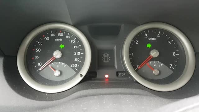

    Renault Megane II 2003 1.9DCI 120HP
    I have a problem when starting the car on a warm engine and when the car stays in the sun longer. In the morning there are usually less problems with starting. This has been happening for several months, starting a car on a warm engine takes 10 to 50 minutes. After connecting to the computer, no errors pop up. I also gave the car a week to a mechanic who deals with electronics, but he failed to repair it.
    Symptoms:
    -After pressing start / stop, all the lights turn on, after a while the message "Oil level ok" appears
    The candle heating indicator does not show (if it shows, the car fires)
    -The starter does not spin
    -The fan usually turns on under the hood (it is loud and sometimes it does not turn off even after removing the card and closing the car)
    To start the car, you need to keep clicking start / stop until the candle heating indicator appears.
    That's how he fired this morning. [movie: 043e51dccb] https://filmy.elektroda.pl/67_1526558977.mp4 [/ movie: 043e51dccb]
    Have you had similar problems, or do you know where the problem is?
