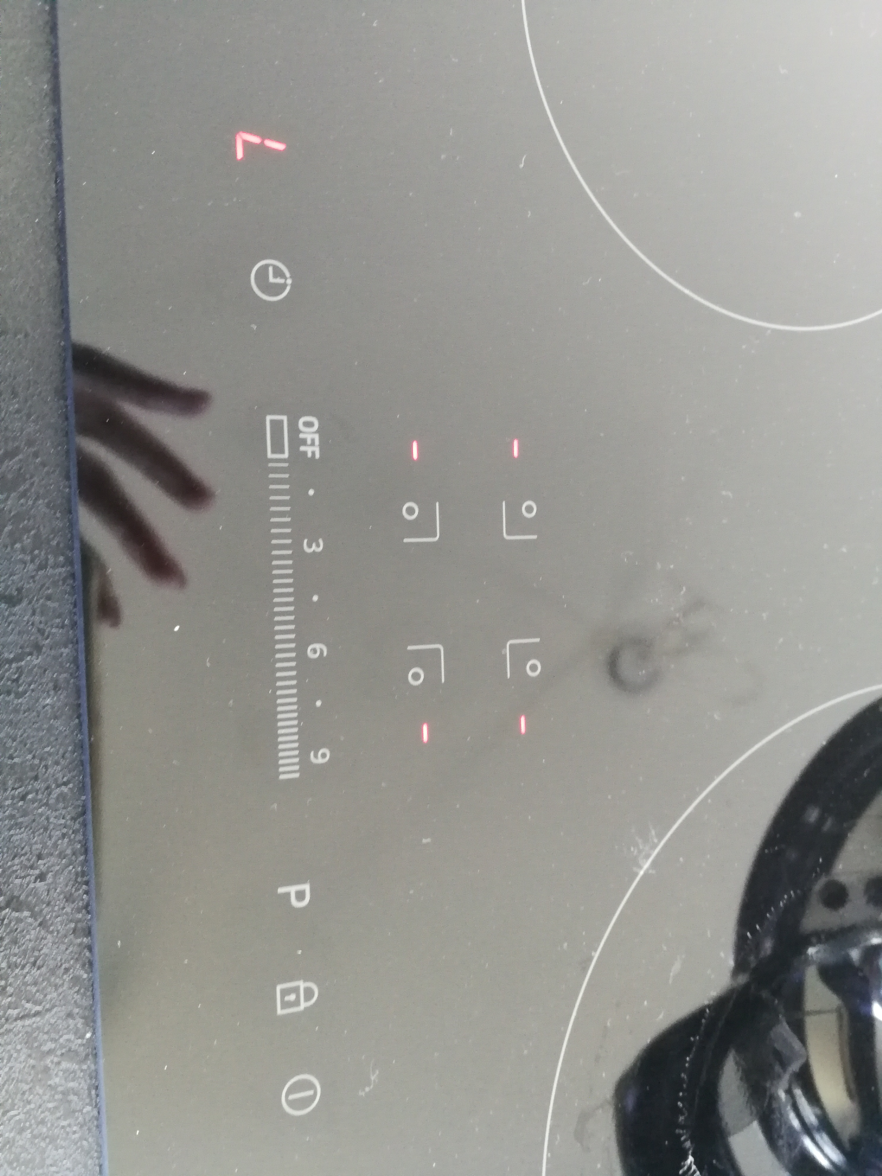

    Welcome to the Samsung L induction plate, the L symbol appears to me, how to get rid of it?
    • Samsung L Induction Hob: Troubleshooting the L Symbol & How to Remove It IMG_20180525_162110.jpg (2.77 MB) You must be logged in to download this attachment.

    Read. The answer will be.
    link
    This is just an example of what the message means. If I knew the model of the record, you could find instructions for it.
    The model is glued from the bottom of the board. Examples of stickers in the Samsung brand: link

    All you need to do is unlock the "against children" protection. Hold the padlock mark for 3 seconds.
