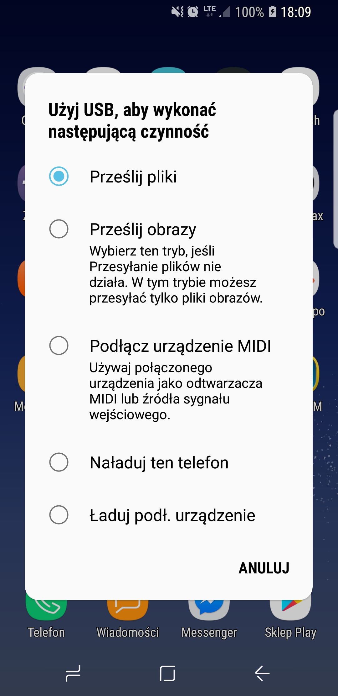

    So the problem - after connecting the phone (galaxyS8 +) to the radio via a USB cable, the radio does not read music. Earlier it read normally, music sorted into folders. After selecting the "upload files" option on the phone the radio shows the message "error19", after choosing from the list of other connection options it is the same or "N / A USB"
    I connected another phone and everything is ok, the radio reads it normally, just like other flash drives with music, so the problem is in S8. The only question is - where? Settings searched and nothing sensible ..

    For me it always worked with the "pkikow" setting, otherwise I would not choose the option and so it shows "error19" or "N / A USB" where everything was ok before.
    Added after 4 [hours] 46 [minutes]:
    jdubowski wrote:
    The phone has a 100% charged battery? If not, top up and try again.
    The phone is "fresh" charged to 100%, still "error19" with every possible option. Pioneer DEH-1800UBG - - Does not read the phone (USB connection)Screenshot...ttings.jpg (388.46 kB)You must be logged in to download this attachment.

  • #8 19612945
    Alis_Gacha
    You enter the radio, system, android WIRED menu and choose memory. It should work
