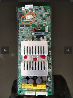

    I have a question because the JBL Extreme loudspeaker refused to work and does not turn on anymore, and when I plug in the charger it shows me 4 LEDs and 5 flashing, after which everything goes out after a while. And now the question of how the battery goes there, how many V should it be because when I measured it with a meter, it had over 8V on both terminals, in addition, the owner told me that while playing it did not respond to any buttons and after running out of battery it did not want to start. 19.37V power supply on the charger plug
  • #14 18570832
    bartekp2436
    Posts: 6
    Rate: 19
    After connecting the charger the power button lights up and after unplugging it goes off?
  • #15 18571552
    fronek22
    Posts: 277
    Rate: 94
    The power or any other button is not illuminated, only the 4 LEDs from charging are on and the fifth is flashing and after a while everything goes out.
  • #16 18574947
    bartekp2436
    Posts: 6
    Rate: 19
    In this case, the software in the bluetooth module was damaged. You need to connect to the service port and program again. We provide such services, please check Tech Clinic in Google.
  • #17 18575515
    fronek22
    Posts: 277
    Rate: 94
    I undressed further and I think I found the reason - the tape is damaged, but now the question is what caused it damage??

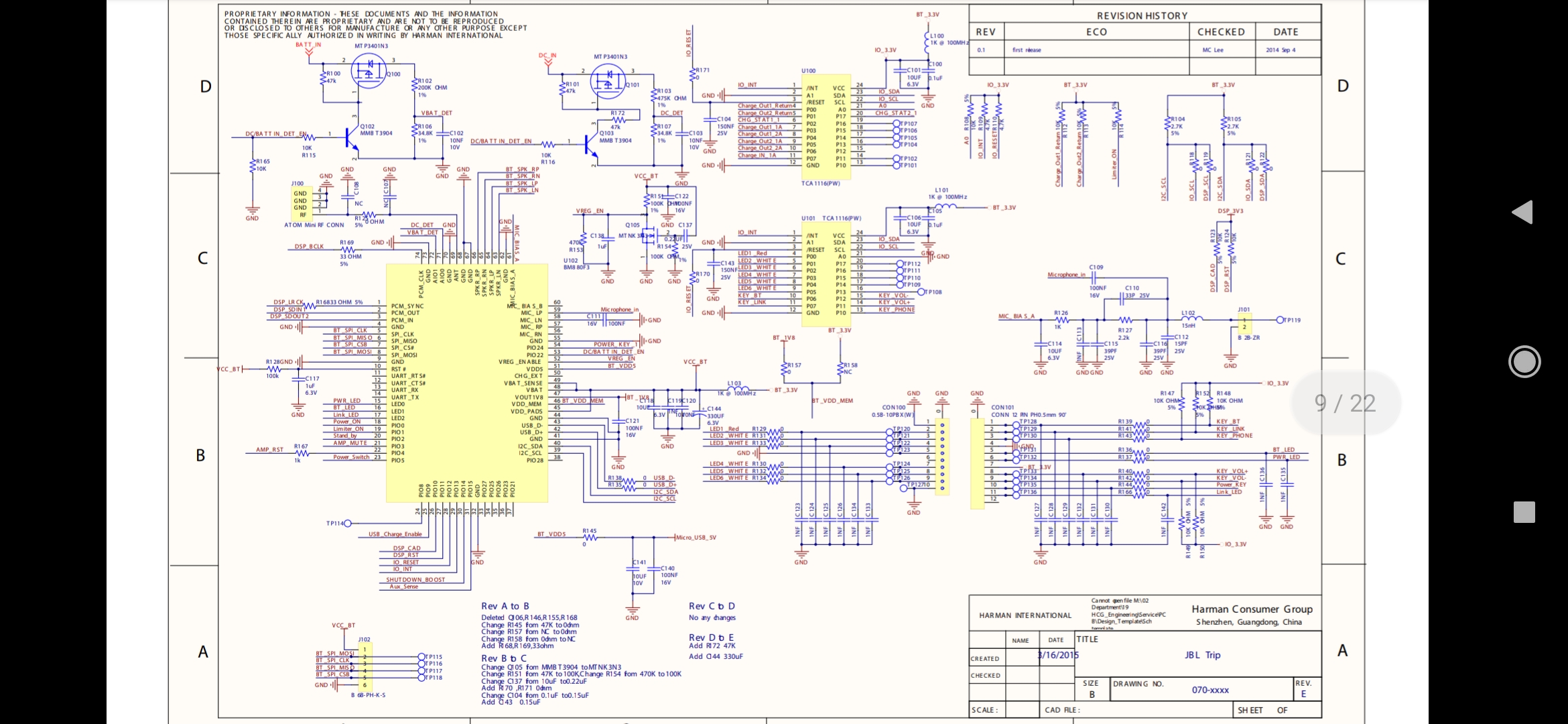

    There may be a short circuit on the 3V3 line, please check the voltage at ports 1 and 6 of the service port.

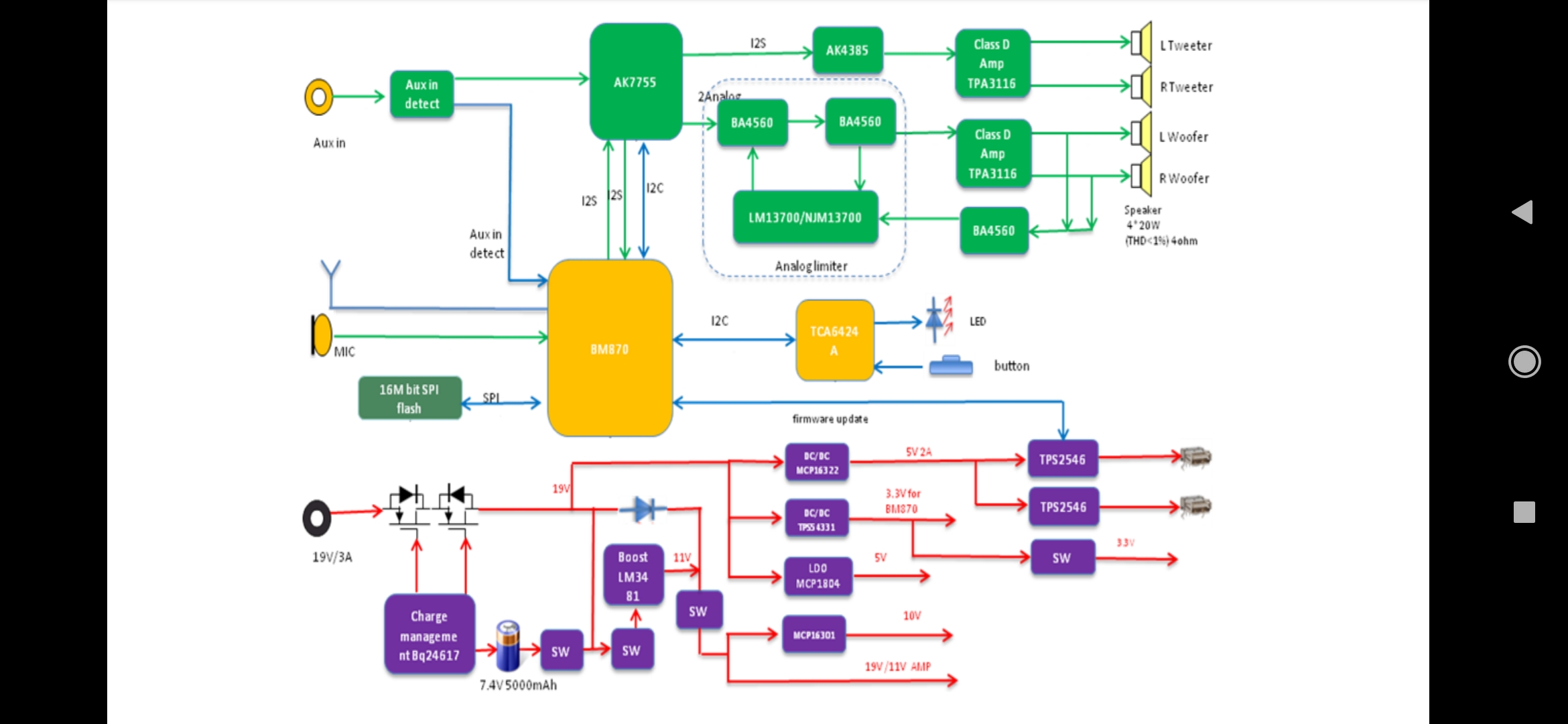

    Here is this module, it is a 8mmx8mm system on 64 balls, you can forget about doing it on an amateur, you can try to bake it, but it is only functional, it is only very soft and you need to upload a new one. It is possible to include some button in the logic systems u101 or u102 and they must be replaced.
    Diagram of things that can help you.
