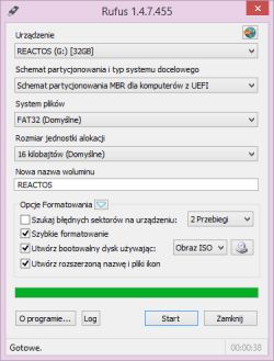

    My Dell Inspiron 15-3521 than how it can not start with BOOT USB I have 3 different pendrive which on other laptops or PCs run without a problem and on Dell as I plug in a pendrive with BOOT it freezes the screen and does not go. When I hook up to the micro SD card reader through the adapter, again after pressing F12 I do not see it on the BOOT list. Does Dell in its bios by default somehow blocks BOOT after USB LEGACY?
    Is the only option in the Boot UEFI settings to use the Ad Boot Option and add there Boot for USB storage prepared for the MBR partitioning scheme for UEFI computers?
    DELL Inspiron 15-3521 - BOOT with USB on Legacy does not work
    Or maybe it can be somehow unlocked in the bios or enter into some advanced bios mode if it exists.

    Pendrive try to do as MBR for BIOS, check if it works in another computer.

    However, the carriers were made without MBR partitioning for UEFI computers, everything changed after the change. Probably in a different form Dell did not accept data carriers.
