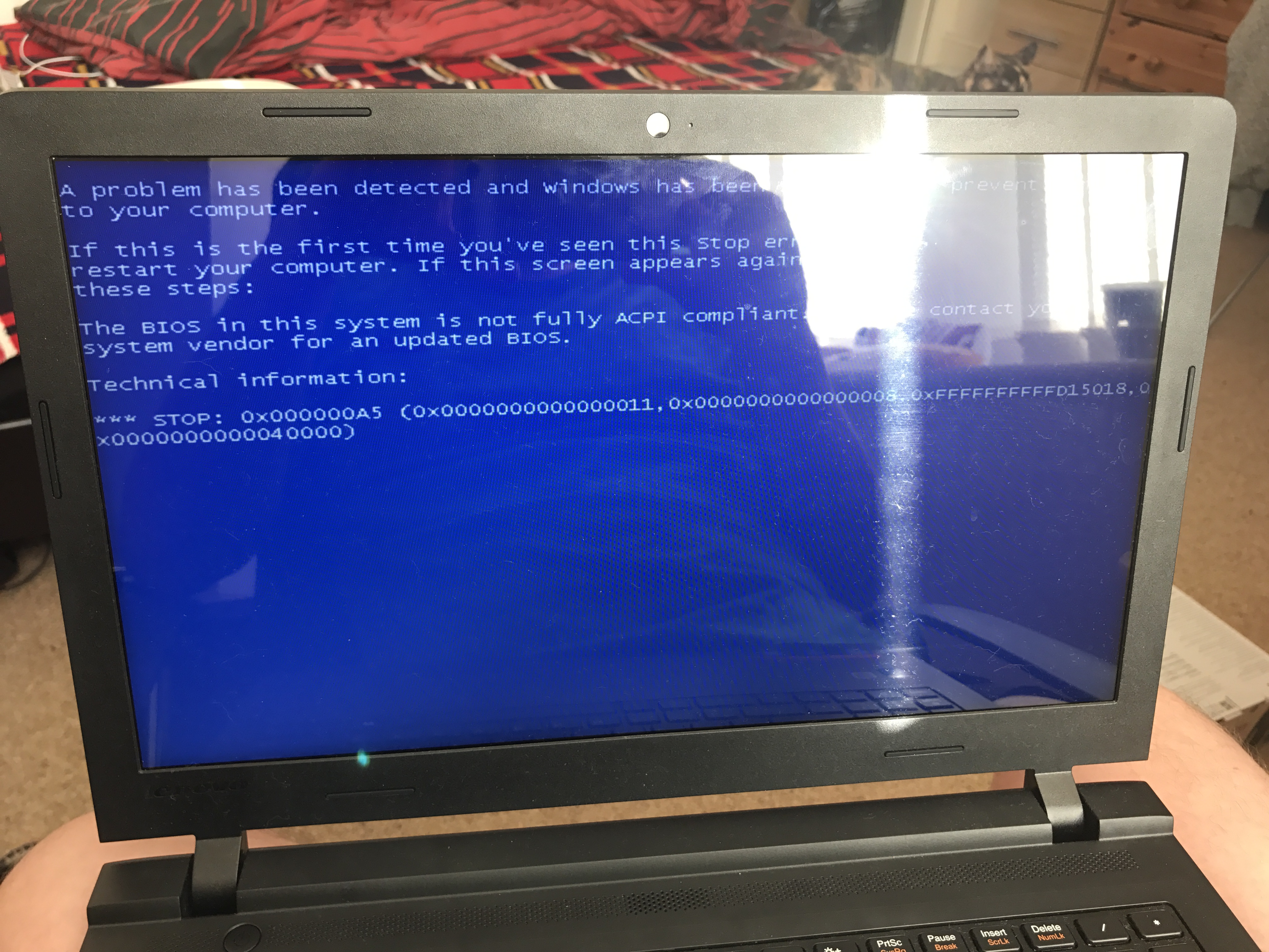

    Hello, I have a Lenovo ideapad 100-15IBY. Currently there is Windows 10 on it, but it is terrible. I wanted to put 7 or 10 on it to refresh it. I buried some in Bios but I can't set it to boot from dvd drive or usb memory stick. I have no ideas and I've tried everything. Any suggestions or hints? Regards
    Have you turned off "Legacy Support" in bios?
  • #4 16236812
    Weasel83
    Posts: 8
    Yes, and after loading the disc from Windows 7 a blue screen appears as in the attachment.

    Do you have the latest bios uploaded?

  • #7 16236905
    Kolobos
    IT specialist
    Posts: 85178
    Help: 17171
    Rate: 10455
    Maybe in a newer one bigos The BIOS have refined ACPI and there will be no more error that clearly indicates a problem with bigos BIOS, and more specifically ACPI ;)

  • #10 16238281
    Weasel83
    Posts: 8
    Changed. I have already seen the loading bar of Windows 7 for a while but the blue screen jumped again
    I mean the boards with the words "Microsoft corporation" and this loading bar below what is.
  • #11 16238296
    Kolobos
    IT specialist
    Posts: 85178
    Help: 17171
    Rate: 10455
    Have you tried disabling secure boot and change the bios mode to legacy?
  • #12 16238325
    Weasel83
    Posts: 8
    In the bios I have switched to legacy and legacy first all the time. Security boot is on desable. All in all there is a change because I haven't even come to "Microsoft corporation" before
    Added after 14 [minutes]:
    As if he wanted to install but as if he lacked the strength to push further because I already had the inscription "starting Windows" and blue again ...: /
  • #13 16238399
    Kolobos
    IT specialist
    Posts: 85178
    Help: 17171
    Rate: 10455
    Have you tried installing Windows 10 in Uefi mode?
