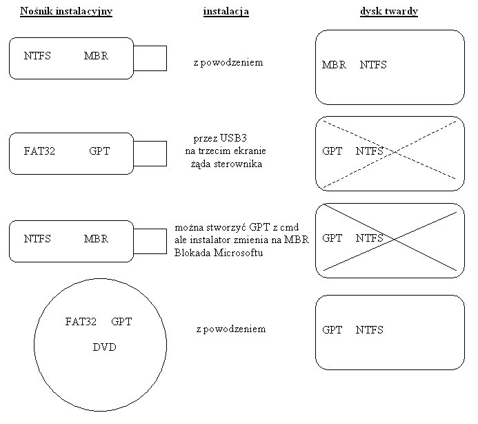

    How to install Windows 10 on a hard disk to boot via UEFI, but to install from a USB 3.0 memory stick (there are no other ports on the hardware) and ready to boot in Legacy mode?
    An attempt to install from a flash drive in UEFI mode ends on the third screen with the message "No media driver required by the computer.".
    In many places (forums, guide, etc.) it is written that in order to install the system on the hard disk, which is to boot in UEFI mode, the installation media must also be prepared to boot in this mode.
    Why can't I prepare bootable media in Legacy mode and install the system to boot in UEFI mode?
    For example, under Windows, which starts in Legacy mode, you can prepare a USB flash drive both one that will boot in UEFI mode and Legacy mode.
    What prevents you from installing the operating system on the hard disk in the same way?

    Well, but for example under Windows XP, 7, 8, which start in Legacy mode, you can create a pendrive with both GPT and MBR systems.
    Then from such a USB stick you can start the installation and it either starts via UEFI or through Legacy.
    Why can't I install the system on a hard disk in the same way?
    Both the installation run in UEFI and Legacy mode, during installation, allows you to open a command window and run diskpart, in which you can create both GPT and MBR on the hard disk.
    Unfortunately, there are no USB 3.0 drivers that the installer would accept. I tried drivers from both the hardware manufacturer and Intel, who produced the chipset.

    After running the installation from a flash drive made of GPT and FAT32, I can do both MBR and GPT on the hard disk.
    So I still don't understand why you can't install Windows 10 to boot from UEFI, since the GPT partition can be done.
    Added after 14 [hours] 29 [minutes]:
    Unfortunately, probably nLite does not work with Windows 10, and NTLite is paid and probably does not allow adding drivers.
    If for UEFI you can create GPT on a pendrive with an installation version from the level of Windows run by MBR, why can't you create a hard disk with Windows 10 installed in the same way?
    Especially that when you run the installation from a pen drive in MBR mode you can create both MBR and GPT on the disk.
    Also, this may not be a USB driver issue if the installation version running in MBR mode allows you to install Windows 10, and the same installation version running in UEFI mode stops on the third screen.
    Preparing the media and starting the system from it are two different things. Preparation is a matter of copying the right files to the right place and the fact that Windows does not want to install in EFI mode on MBR is a simple limitation - certainly Setup but I'm not sure if the system itself. An installer running in EFI mode will not let you install the system on an MBR disk - that's Microsoft's invention. I have not tested with Win7 and newer systems but such old WinXP x86 or x64 can be run in EFI mode from the MBR partition (in VMware without a problem, on real hardware with graphics problems). You need to install the system in BIOS mode and then manually copy several EFI files to the right place, switch the firmware to EFI and the system starts up :-) . The fact that EFI files - in this case are from the test version of Vista, when EFI was in development, but since these files can be run WinXP on hardware with the EFI / BIOS firmware from June this year (June 21, 2018) this only indicates that the new Windows have specially imposed restrictions on EFI that it must be on GPT. If someone is interested in the matter, I invite you to the topic: Windows XP 64-bit or 32-bit - can I run with EFI?

    Does this mean that Microsoft's invention is also that the installer running from a pen drive with MBR in Legacy mode will not allow the system to be installed on the hard disk with GPT and booting in UEFI mode?
    So we have such situations:
    - Windows 10 installation on UEFI with USB on Legacy

    EFI firmware does not support NTFS by default. However, it supports FAT32 but the medium does not have to be GPT.
    For EFI (64-bit), only the appropriate location and startup file name on the FAT32 partition are valid:
    efi\boot\bootx64.efi
    Pendrive can be universal - from which the computer will boot in both BIOS and EFI.
    Windows 7 installer and newer will start in both BIOS and EFI but will not allow you to install the system in EFI mode on the MBR partition. I don't know the opposite, whether it will allow you to install the system in BIOS mode on a GPT partition.
